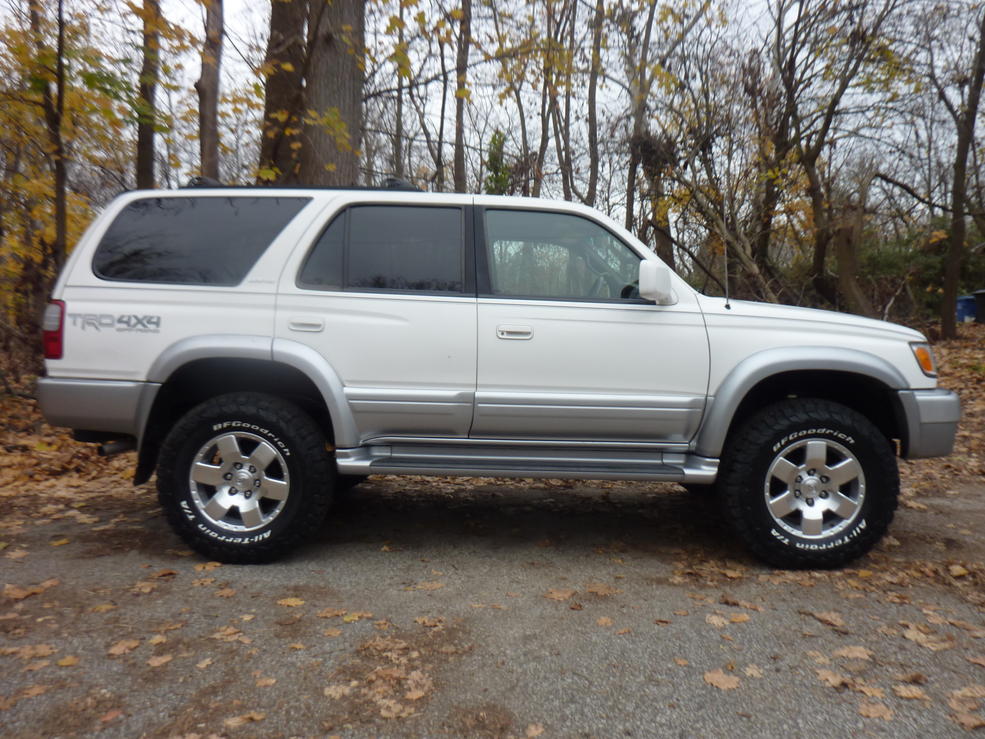

I have 275 70 17 BFG KO2s with 07 FJC rims with tundra coils and 890s. A ~3" lift. No rub that I've noticed. I had 1.5" spacers at one time and rub a bit with them so I removed them.
