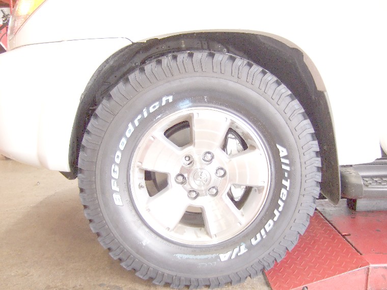

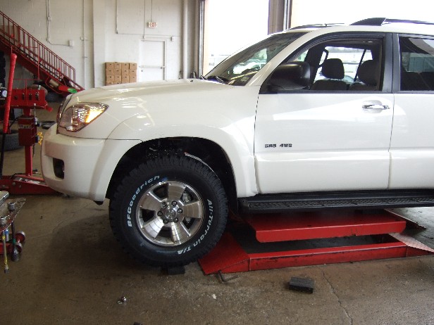

Tried these on my stock 2008, no lift. They will rub the upper control arm at full turn. Back off 1/4 turn and all ok. This rub point is smooth metal so more than likely no major damage, probably lots of noise. So just avoid full turn if you really want them.
Move the forward inter plastic a little more forward, very easy. 3 screws at the bottom. All else clears.
Is top clearance a problem? Didn't have a huge block to put under a front tire during this test however, I don't think this will be a problem. In another post I described how when climbing over a big rock that causes a rear wheel to lift off the ground, that front wheel suspension only moved up 1 5/8." WOW!! That's Stiff. Upward travel appears to be very limited. Conversely, the opposite rear wheel moves up a whopping 6"(under the fender). So no, I don't think top clearance will be a problem, even with no lift.
However, after all of that I thought they really made the car look too rugged for me!! I didn't like the look, so I backed out and switched to GY Wrangler SA 275/70R17. Will post pic's of these later.
Here are some pics of the 285/70R17 BFG's.
These pics were brightened to get the darker areas to show up.

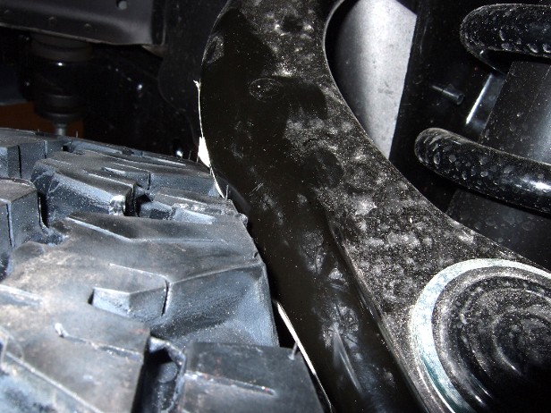

Here's the rub. Your looking at the very top of the tire and the upper control arm.
You can see the edge of white tape on the control arm. The tape marks where the tire touches. The wheel is turned fully. The interference does not appear to be too serious. I did not drive the car with these tires on.
Hope these pics help all who are interested in the 285's.

Do you plan on on doing a small lift in the future? I wouldn't be comfortable with that much rub, and I'm surprised that the tire shop let you drive off with it that bad. The ones around here check for rub and are pretty strict about it.

Hi Josh
No, I didn't drive off, recall in my post I said "However, after all of that I thought they really made the car look too rugged for me!! I didn't like the look, so I backed out and switched to GY Wrangler SA 275/70R17. Will post pic's of these later."
Everyone should be aware that a lift does absolutly nothing for this rub porblem. Wheel spacers is probably the best way to correct this rub but, that will make the forward/aft fender clearance slightly worse.

Now would an aftermarket control arm (ie. Camburg) have solved this problem? Part of there benefits is being able to allow for wider tire clearance, correct?

Hi Mike
Not familiar with that item but, sounds like that could be very helpful for the 285/70r17 BFG tires.
The 275/70r17 GYW SA tires are working just fine with no such mod needed. The slight rubbing of the UCA is of no concern and totally negligible.

To fit a 285 tire, while retaining stock components, a 3" spacer lift and wheel spacers are the cheapest solution. 275/70's are going to rub as well unless a lift is added. Tire fitment has been discussed at length since the gen 4's came out. In fact in one of the op's other threads, Good Times advised him of this but apparently had to see for himself.
UCA's will eliminate rubbing and allow for even wider tires, but have the added benefit of restoring caster to the suspension geometry, restoring some handling feel. ICON (Donahoe) UCA's have the most adjustments available among the a/m uca suppliers.
Going into the 34-35" tire range requires more mods including trimming back a body mount.
Lance (Good Times) has detailed threads on the 4runner as to what fits and lift options at yotatech and ultimateyota.
