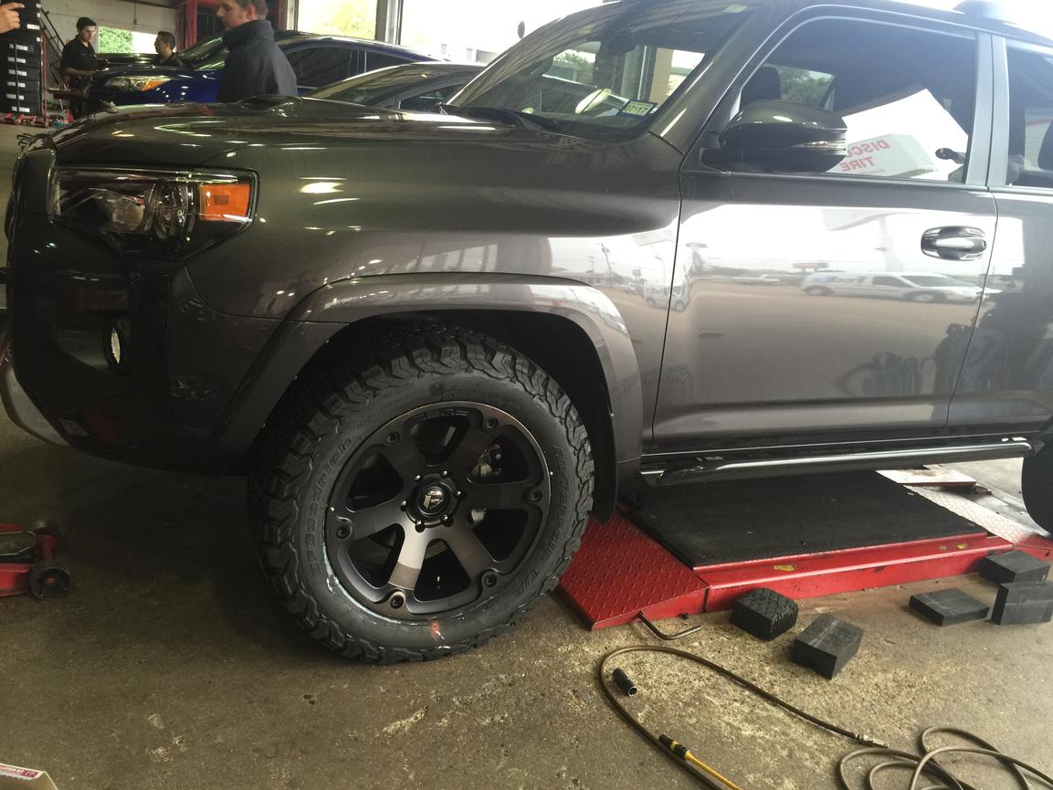

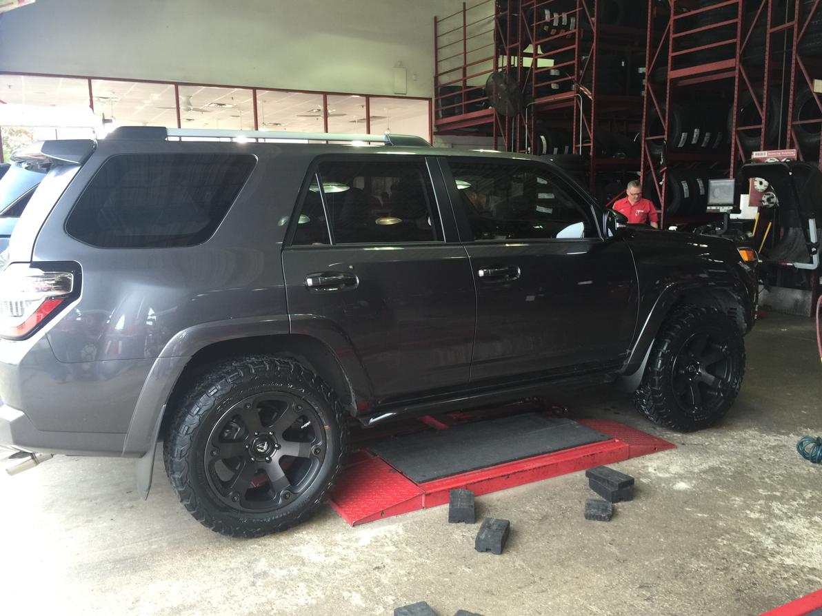

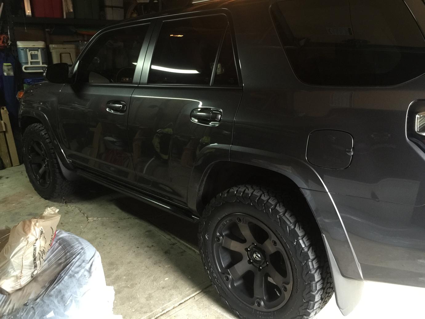

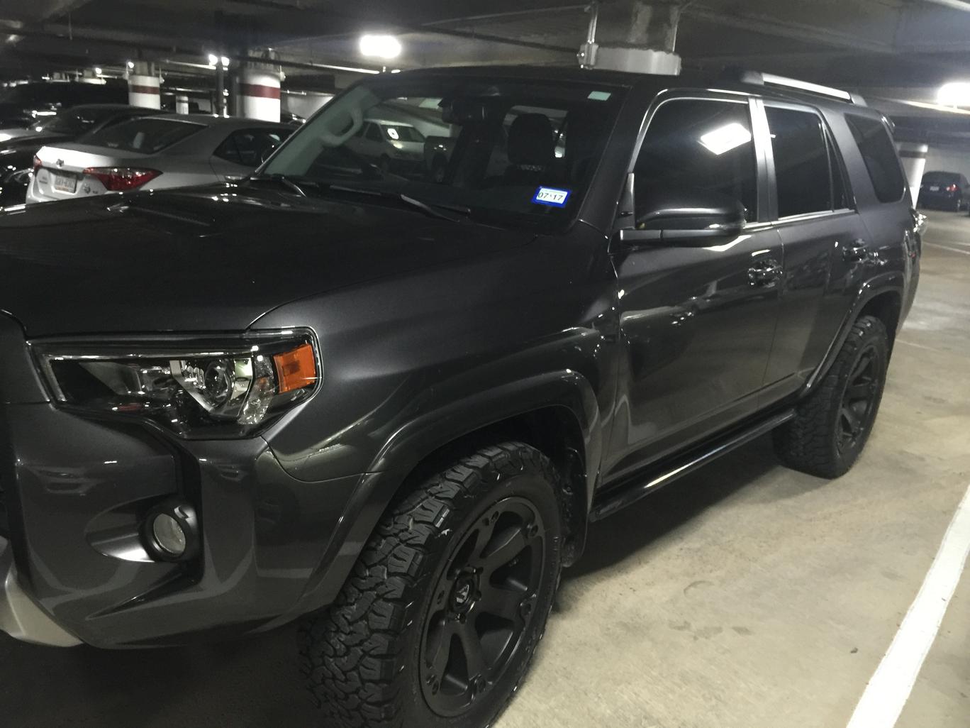

2015 Trail Premium - 285/55/r20 Fuel Beast stock height
285/55/r20 BFG KO2s on Fuel Beast 20s - 2015 Trail Premium. Stock height; slight rubbing on front inner bumper (fixed by slight trim in a snap w/ no visible cosmetic issues); slight rubbing on wheel well/fender flaps on full turn, but could easily be fixed with very minor wheel-well trim or heat press - not a big issue in my mind.

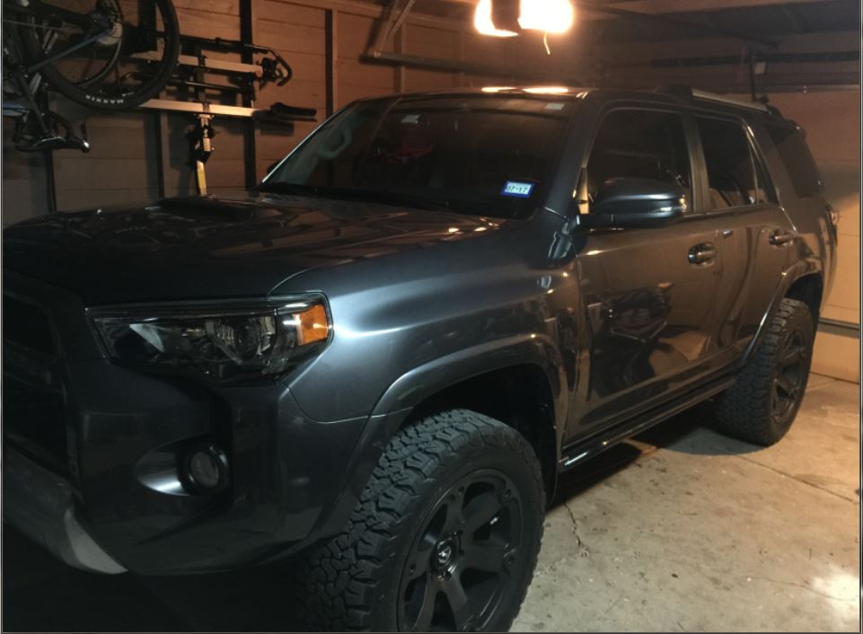

20X9 Fuel Beast 285/55r20
Added a 2.25" front spacer - got rid of the scrubbing completely
