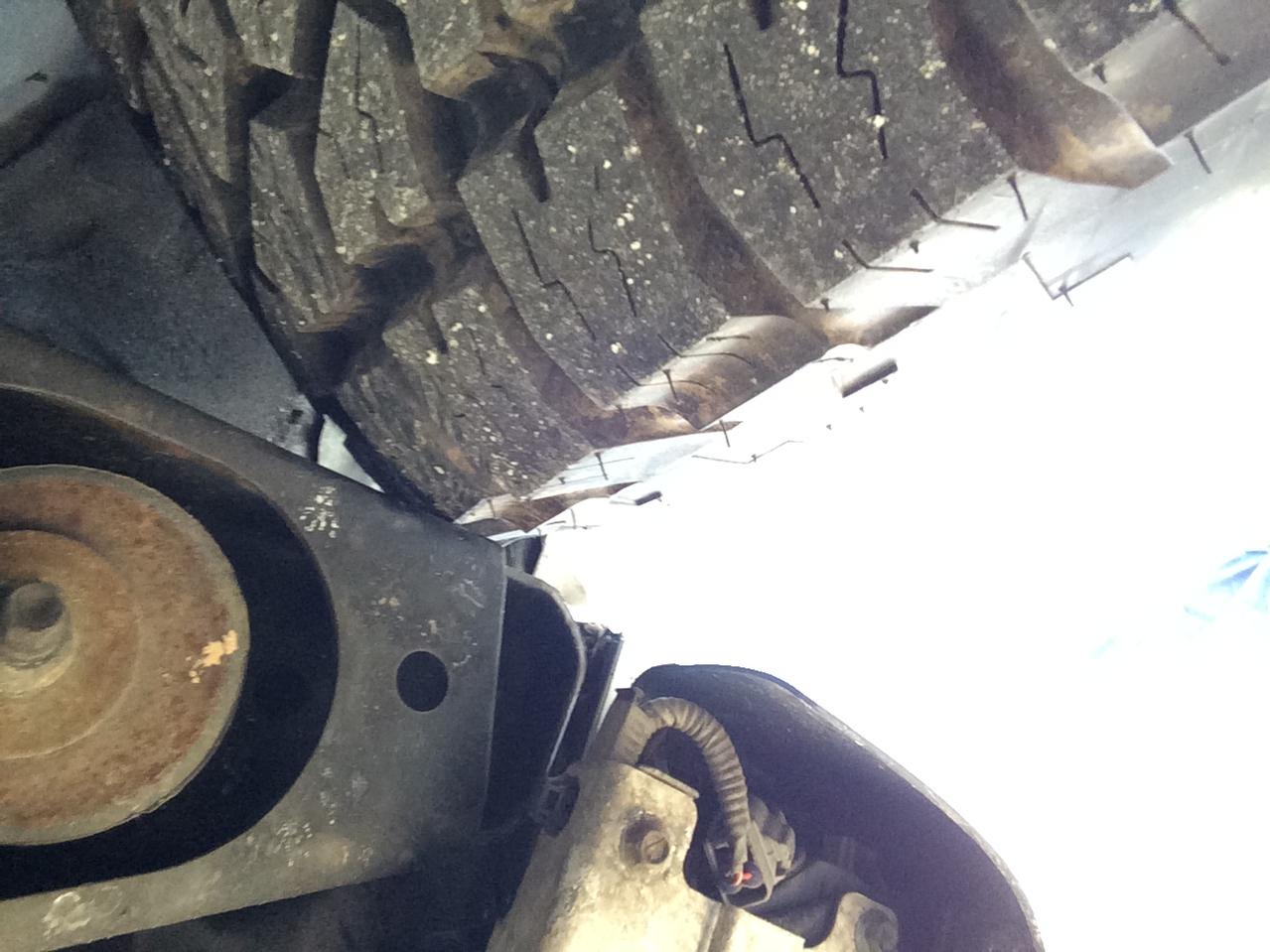

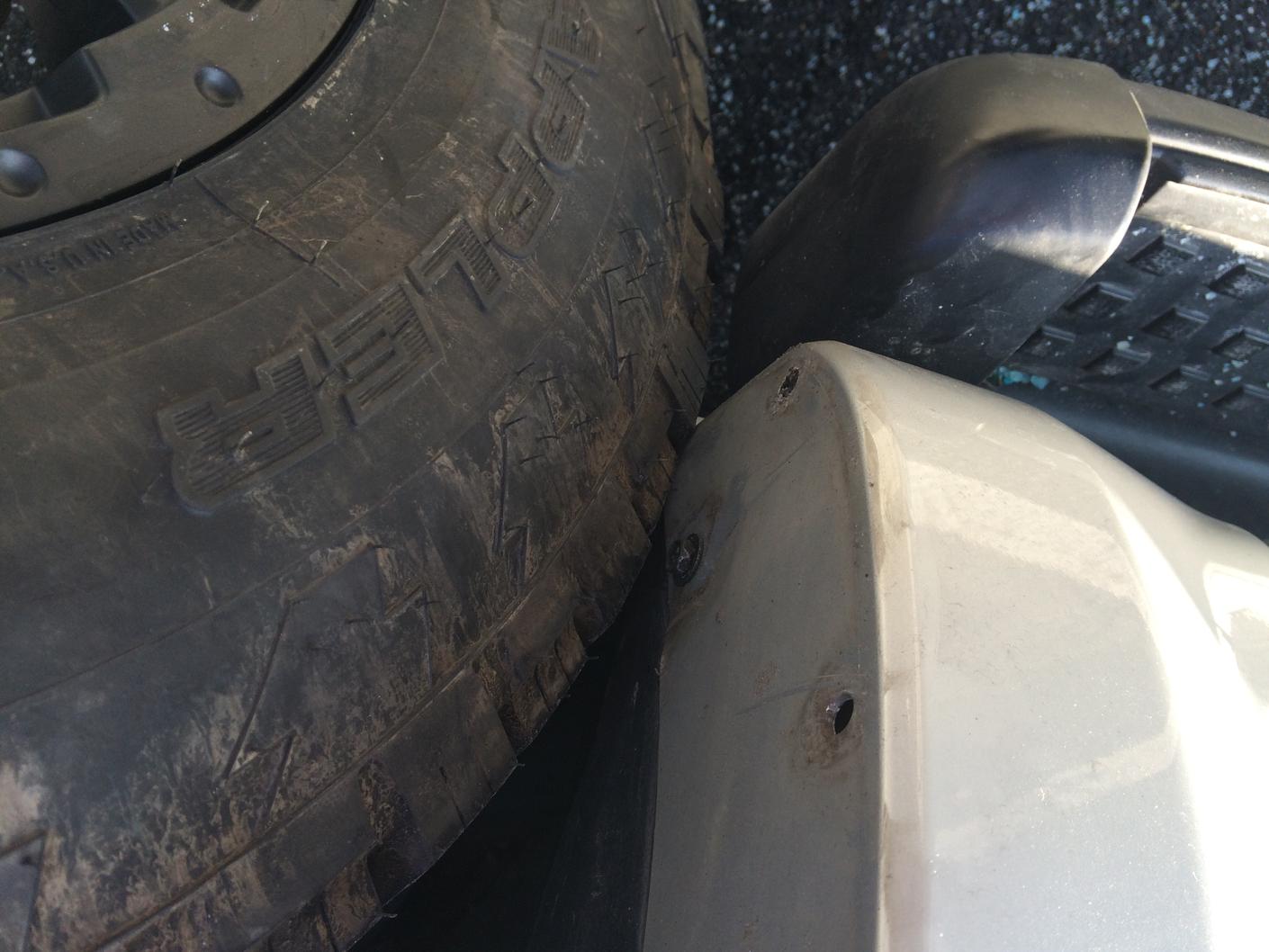

I have the basic Toytec 3" lift and last night I put on 285/65r18 Terra Grapplers on wheels with 4.5" backspacing - I thought I'd be at least close to ok, but I turned the wheel and and drove out of my garge, it sounded like I had baseball cards in my spokes. Trimming bumper/moving fender line is no problem, but then I realized when I turn the wheel all the way, I'm rubbing the frame. I looked up some threads on here but it doesn't look like this is a common issue. It sounds like I have 2 options:
1) New alignment and ask for +4.0 caster.
or
2) Different tires/wheels
From my last alignment about 2 months ago, I'm at +3.2 and +3.5 caster. Could the .8 and .5 be enough to fix the problem or does it sound like I'm out of room to play around with the caster? And are there any other solutions to this problem - trying to avoid different tires/wheels.
*** I've added pics of both tires rubbing. One is on what I believe is the body mount - the other hits the body before it even gets to the body mount. Looks like the same issue, one side is just worse than the other??Sorry that one pic is upside down, but I think you can still see the problem. ***

Body lift will fix the side rubbing your fender, it will not fix the side rubbing the body mount. Maybe have an alignment and have them get as much caster as possible and then If needed do a body mount chop! Easily done yourself and will help a lot. If it keeps rubbing the body, a body lift is also fairly inexpensive(less than a new set of wheels) and can easily be installed yourself if you have basic skills.
BMC body mount chop is needed! Not going to look for link while on my phone, but it's here somewhere. It's on the lift sticky by Ark Swamp. You could prob Google search 4Runner Body Mount Chop! I had to do mine and many others do as well.
Thanks for the reply guys. I found the body mount chop link - do I have to re-weld it after the chop? I've seen people say both. But I'll start with the alignment and hope more caster helps - then go from there.

[MENTION=112950]RyanCocolin[/MENTION], DO NOT go messing with your caster. Messing with your caster will screw up the handling characteristics of your 4Runner, possibly even to the point of being dangerous. My Runner has the Toytec Ultimate lift and YES, I have some rubbing on the body mount at full lock and have had it for several months. I fully intend on taking a pneumatic cutting tool and cutting the body mounts in the next few weeks (its cold outside). Aftermarket BMC covers are available and can be welded on later.
Ryan , are you running longer control arms with your lift? If not, than you are already at max caster, regardless of what your dealer is saying. Why waist time money and energy? Cut the body mounts.
Thanks again.
I haven't welded mine back. Has been over a year and no probs yet. I wouldn't think you would have to weld it back.

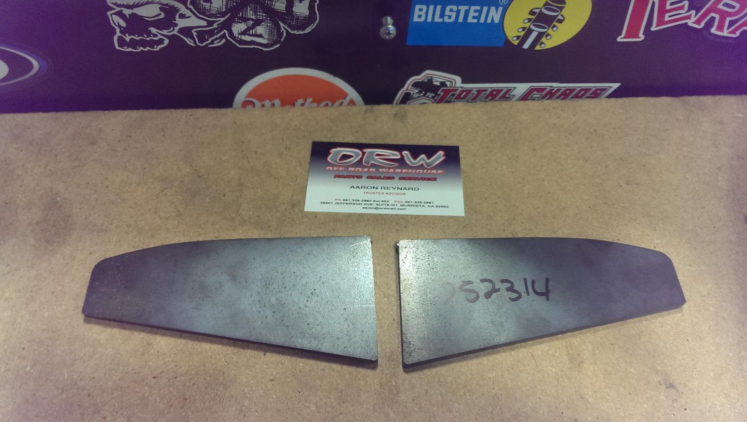

You can just cut and clearance but it leaves a hole that looks ugly. We (Off Road Warehouse) sells a body mount plate that you use as template and weld in. They are $15 each plate and runs about $300 in labor. Chopped, welded, and painted. So any of you So Cal guys can take advantage of this.

As always, super helpful. Next steps are the body mount chop and then a body lift. [MENTION=89791]preacher35[/MENTION] I am running longer control arms, but I'll leave the alignment alone. Thanks for all the input.
