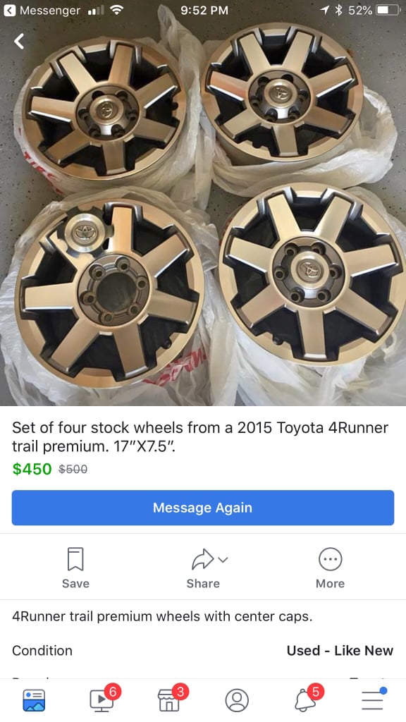

the oem wheels are a 30mm offset - not sure if that’s a positive/negative offset. I have heard that the 5th gen trail wheels are 15mm offset which would get the tire further from the UCA. Wouldn’t that solve my problem?
Above are the wheels I’m picking up on Friday.
It should solve your problem. Rims with 0 offset will help even more..

I won't be doing a body lift ever, the stock trail rims I was able to locate for $375 local off a 2017. So I'm going to go that route as well as folding over the pinch seam.
