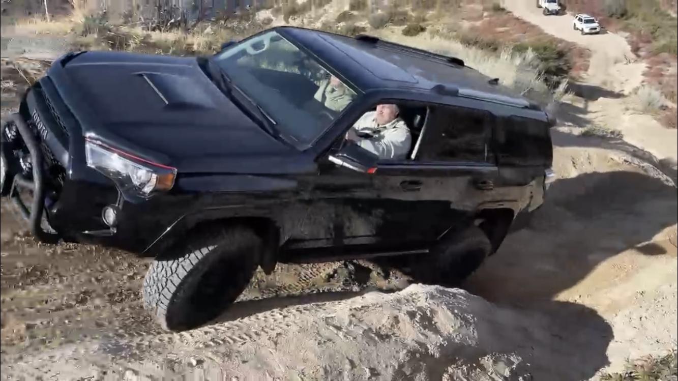

On the Pro as compared to the other 4Runners, the 275’s clear without a problem because of all the aforementioned info I stated. I had 275’s on my Pro at stock height without issue off road. Pic below.
Again, on your Venture, I like the gunmetal too, you may have a problem with the front fender bumper/liner. If you added a 1” spacer you would probably still have to do the fender liner mod. The advantage of the 1”spacer up front would be to level it and reduce the nose dive.

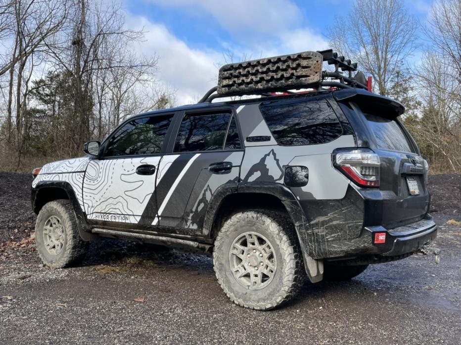

I have a '20 Pro with the Eibach springs. They are 1.6" in front and I am running 285's with no rubbing. If I hadn't removed my mudflats then I would have rubbed there. IMO, 285's with no lift will look silly.

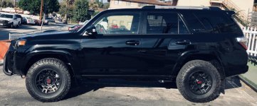

Street driving only obviously but yeah no issues. People fail to realize rubbing issues are self inflicted. People want wide wheels with aggressive offset and I get it but that’s the problem. Running the correct wheel is key to not rubbing. 1.5” front 1.5” rear 295/70/17 on FX Pro wheels. No BMC, just a fender liner mod, no rubbing.

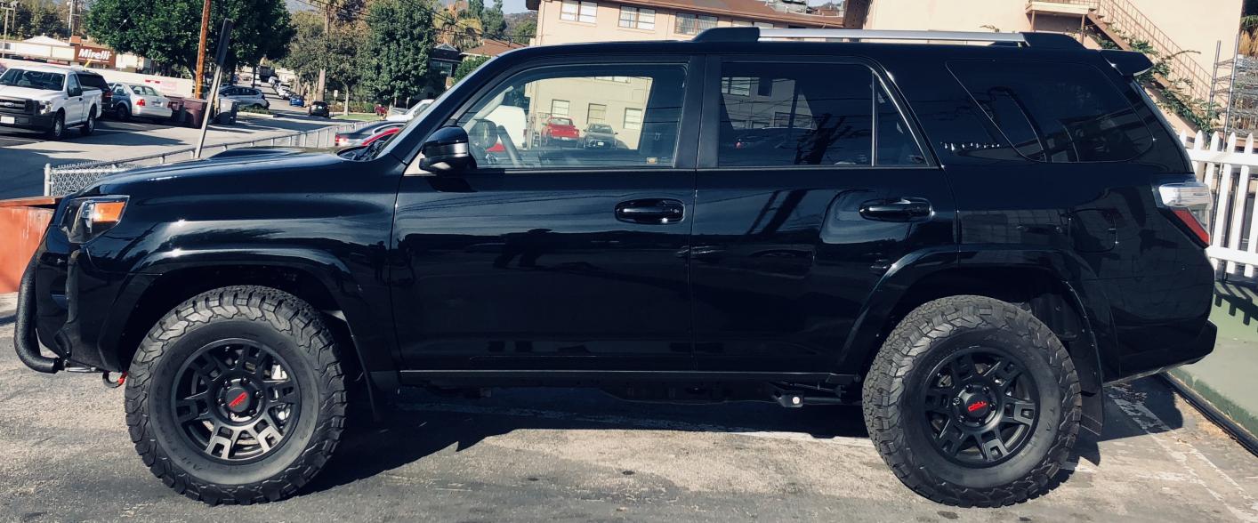

I’m running 285 KO2s on the stock rims on my 19Pro. Zero rub and mudflaps are still on and no BMC. Have 2” lift and SPC arms.

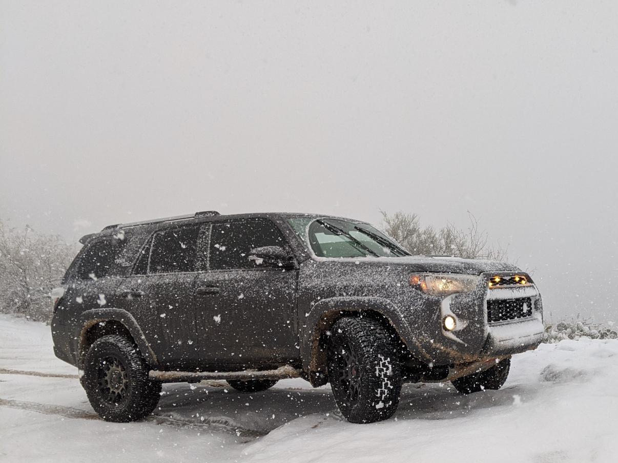

285s (Pirelli Scorpion AT+) on PRO wheels. No lift (backordered) no spacers. no uca. No bmc. Totally stock truck. Pushed the liner and trimmed the corners off the front bumper before install (maybe an inch of plastic tops) you would never know it isn't factory. Removed front flaps. Zero rub on the street. Put the flaps back on to minimize rash on the rockers. Minor rub on the flaps when turning in reverse or over bumps. Truck is dd. Been avoiding hard wheeling until suspension shows up but I do mash up and down local dirt roads and hit some bumpy rocky spots. Zero rub unless I'm turning over a bump where it will graze the flaps.
