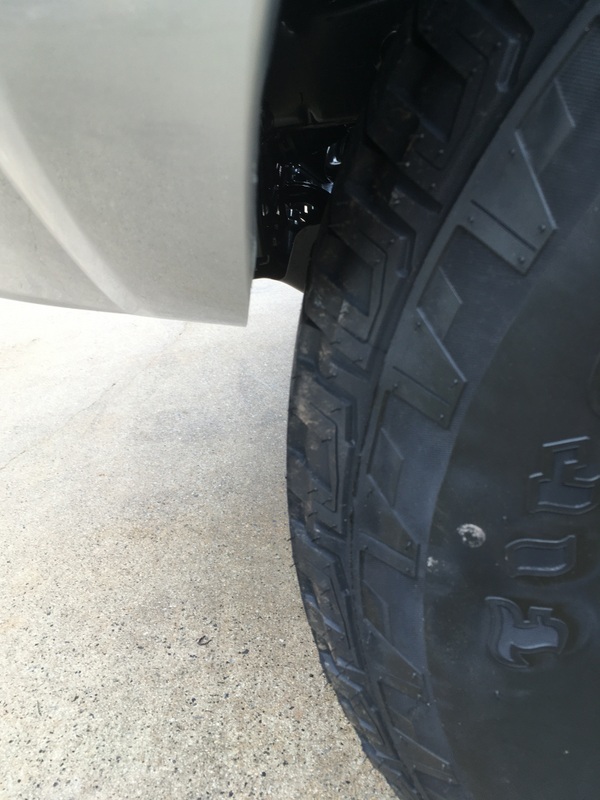

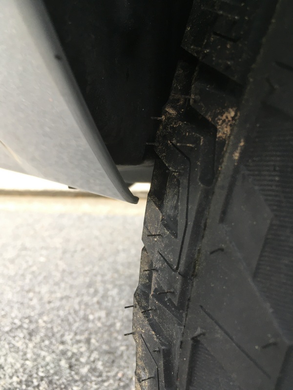

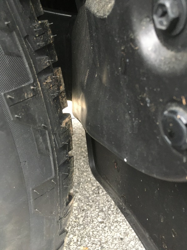

First off, many, many thanks to [MENTION=173641]nimby[/MENTION] for the time he took to write the review on the Firestone A/T on the other 4Runner forum. The tire and lift combo was exactly what I was looking for so I followed his advice. I am very pleased with the outcome. After a little road time I have found a little rubbing on the fender liner when in reverse at full turn so I'll be doing the fender liner mod in due time. Not even close to a BMC

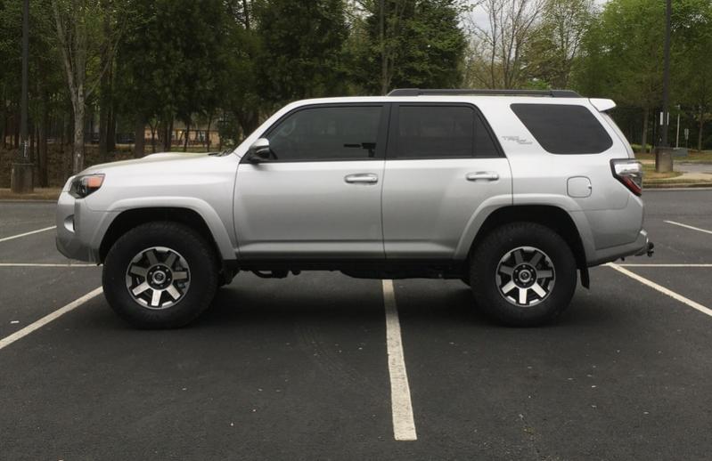

Stats:
Eibach Pro Truck with P285/70r17 Firestone Destination A/T2 tires. Stock TRD/OR wheels
Front
Shocks set to 1.6
36 1/2" ground to bottom edge of fender. +1 7/8" Above stock (Stock was 34 5/8")
Rear
2 OME 10mm spacers, stock coils, stock shocks (Eibach PT delayed in shipping)
38" ground to bottom edge of fender. +1 1/4" Above stock (Stock was 36 3/4")
1 1/2" rake
Caster is set to 2.8L, 2.9R.

Glad to hear it worked out for you Keith and that you're happy with the set-up!
Do the fender liner mod and get your alignment shop to get the caster as close to 4 degrees as they can get it.
It'll ride even better!
Your truck looks awesome!
Looks great! Destination AT2 do run a tad taller than most 285 I've had, they are wonderful tires on road and light off road. When things settle you might have some more rubbing.

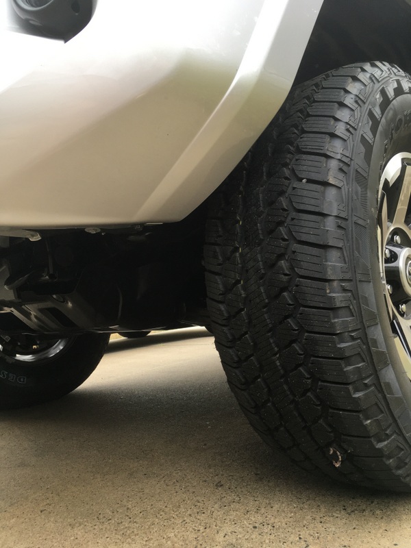

Man, that looks close. Starting to rethink going 285s and instead do 275s.
That's where I was too which is why I made the spreadsheet so I could compare sizes. I really didn't want to go with an E rated tire. The only one that was close to Std load was the Kuhmo (6 ply C rated) which was also 12lbs/tire heavier and offered no mileage warranty. I kept coming back to the Firestones.

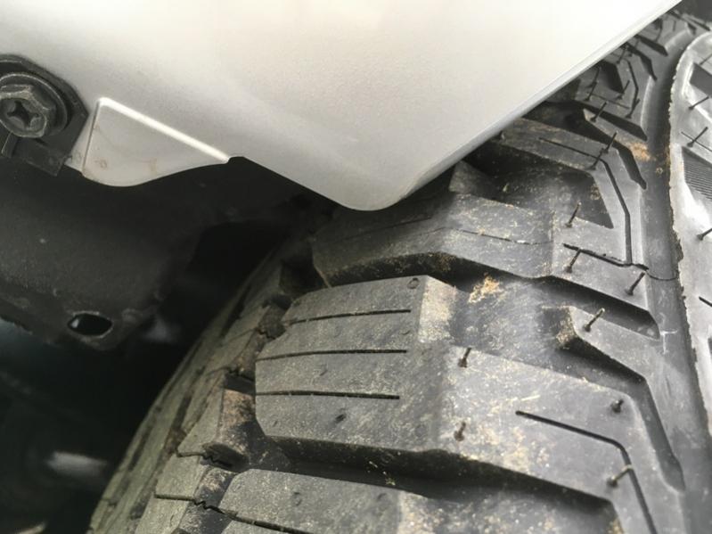

Liner is pushed forward and did a little more trimming today with a rasp and some 320 sandpaper to smooth it out.
