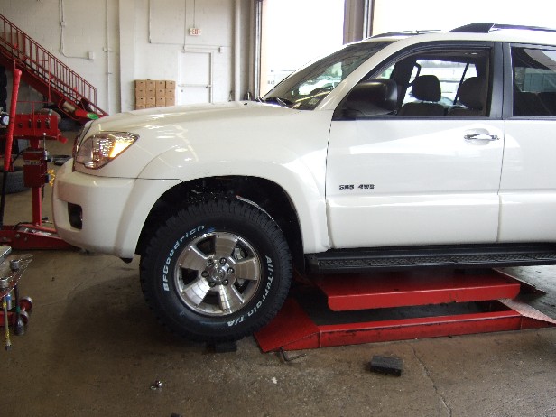

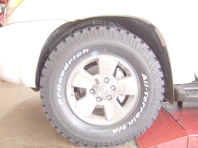

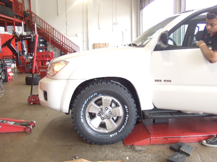

Here's a couple more of the 285's. Hope both show up!!
These pics were brightened to get more of the dark areas to show up.
See my detail comments earlier in this series of posts.
Well, the 2nd didn't showup.
Guess you have to do each pic separately.
Hope these pics helps all that's interested in the 285/70R17
