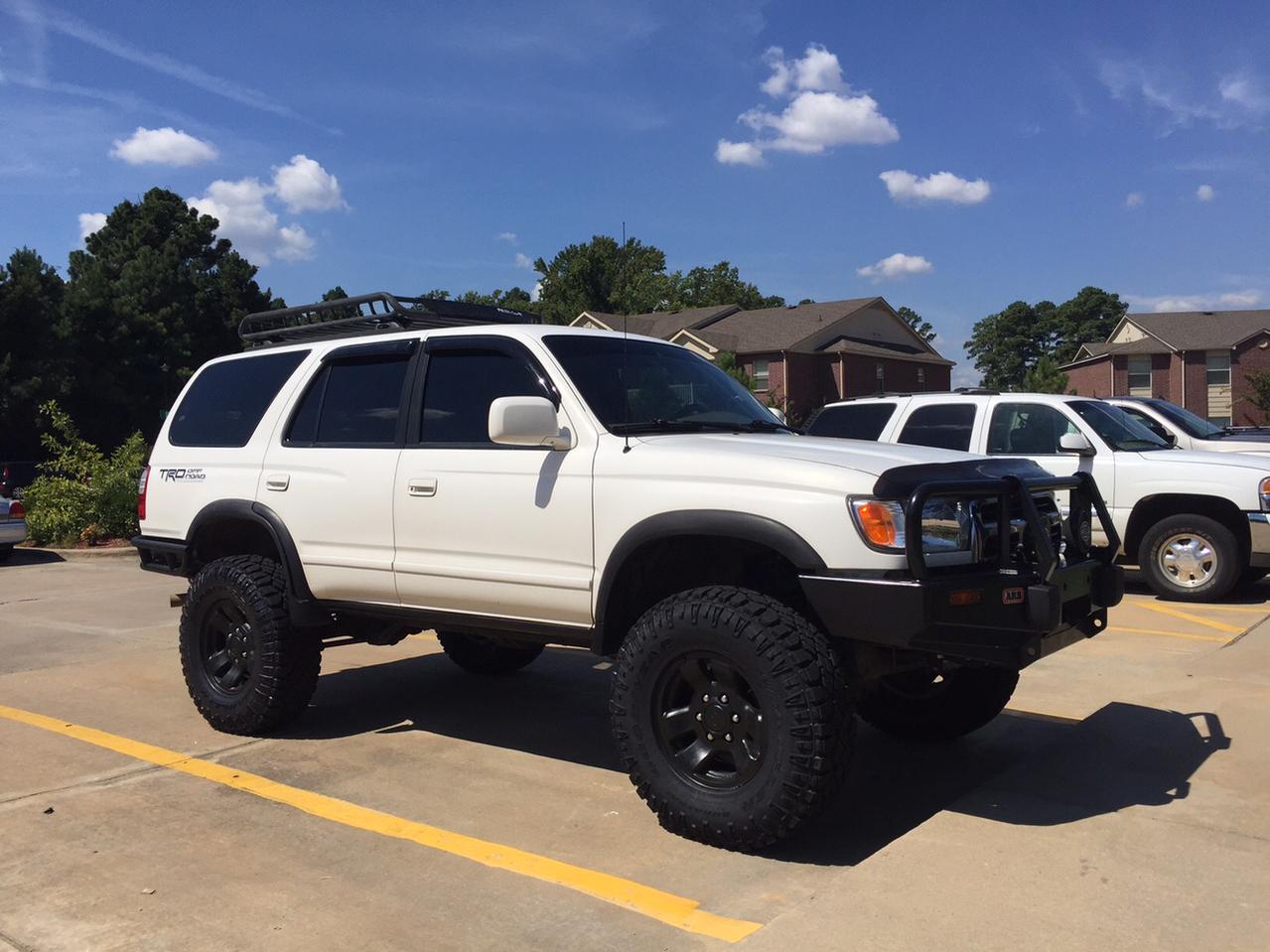

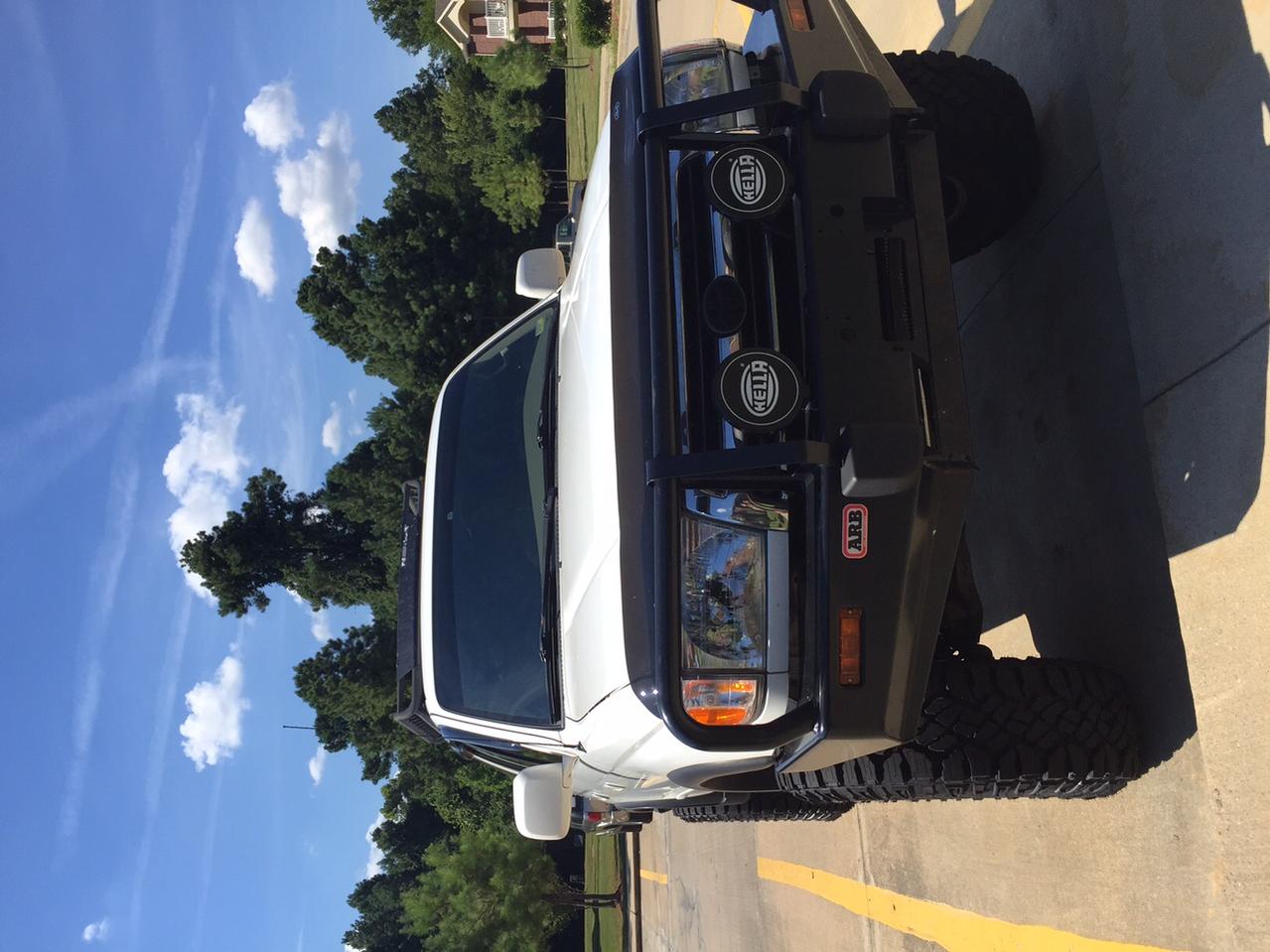

Here you go [MENTION=79826]absalom[/MENTION].

Are those 285/75/16 on stock 3 spokes on the white 4R? That set-up looks perfect! What lift are you running? Any rubbing. Any feedback is greatly appreciated

They are per OP title, with 1.25" spacers. I'll take a stab at it.
That tire to flair gap 285's limited flair took 4" lift F&R to achieve on 96Red. Will require less with that trim.
Believe I see more frame rail than normal bumper gaps look 1" BL, pair with 2-3" suspension lift is used.
Rubbing varies, combo you put together wait n see adjust as needed.
