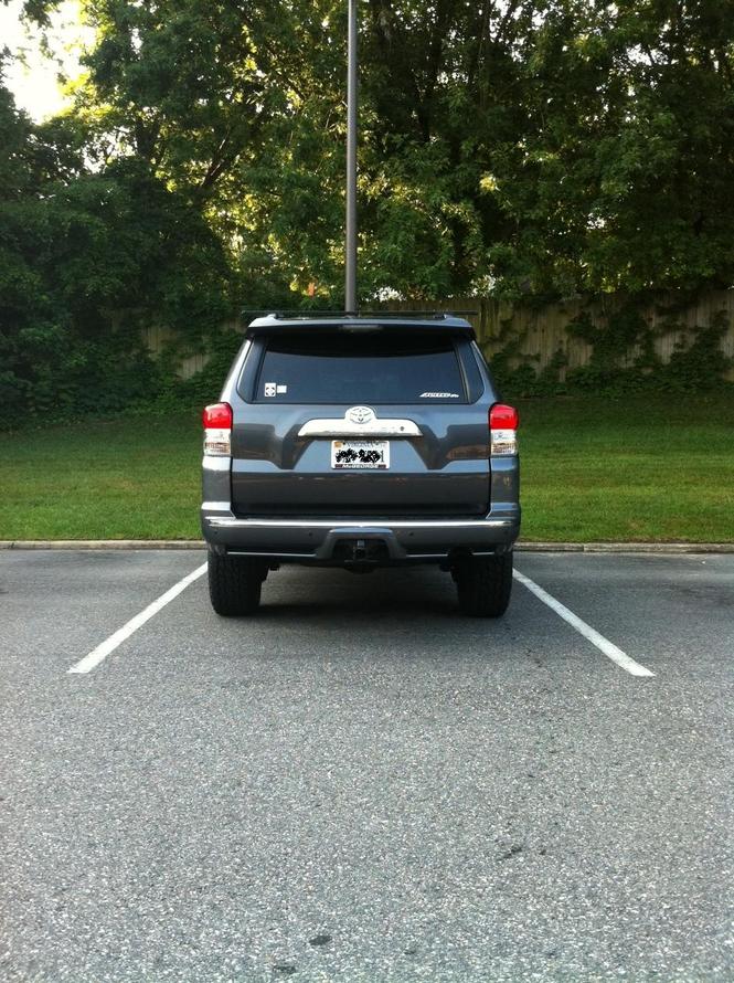

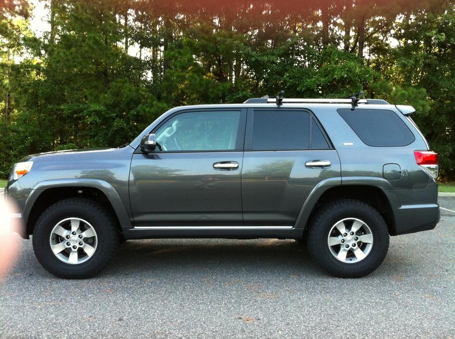

I posted a pic of my 2010 SR5 about a month ago to show everyone on this forum a nice, subtle lift. Since then, I have upgraded my tires to the 285/70/17 Nitto Terra Grapplers. This set up is EXACTLY what I was looking for - meaner looking, but not over the top since I still use this for my work vehicle. Works great for mild offroading = beach...mountain trails...etc. Anyway, I had only minimal rubbing on the front fender (barely hear it)...nothing on the rear. So, I just unscrewed the two bottom screws that hold in the fender...pushed it forward...and tightened the screws. Problem solved! So here is a picture for you all - I am sure there are plenty interested in this setup and this could help. I couldnt find any solid pics when I was researching myself. Eventually I will upgrade to adjustable shocks down the road, but for now - the toytec spacers do the job and the handling still feels great...slightly stiffer ride, but barely noticeable. The price was right too - only $180 for the 4 spacers and simple install for any shop (or yourself if you know the ropes). Hope this helps!

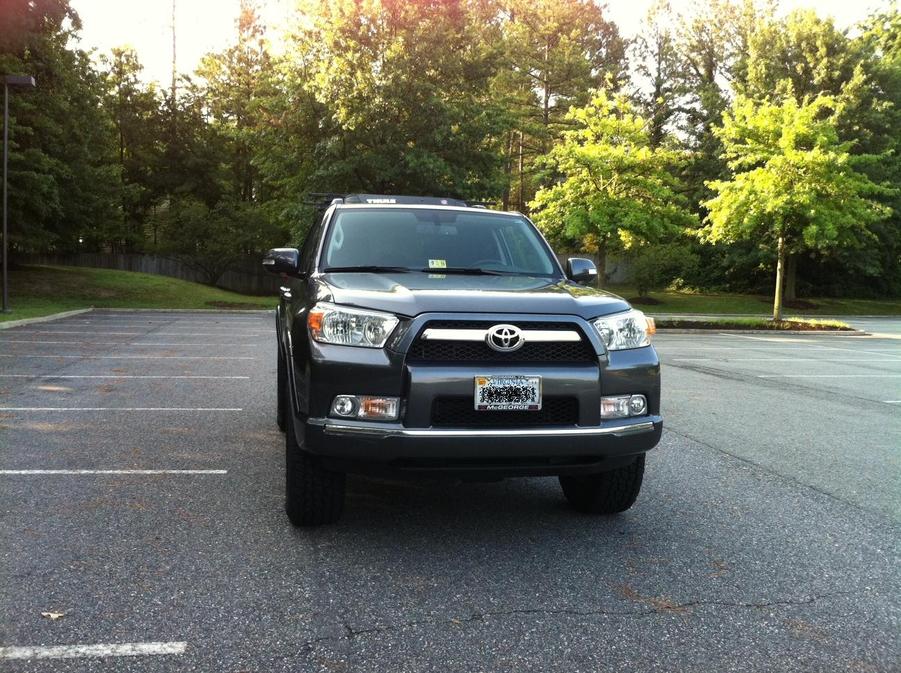

Here is one more from a higher view to show the front more - will snap some others tomorrow from behind, etc...and thanks!

This is exactly what I want to do. Thanks for the post. Did you install yourself or have a shop do it? if so, what did the shop charge you?

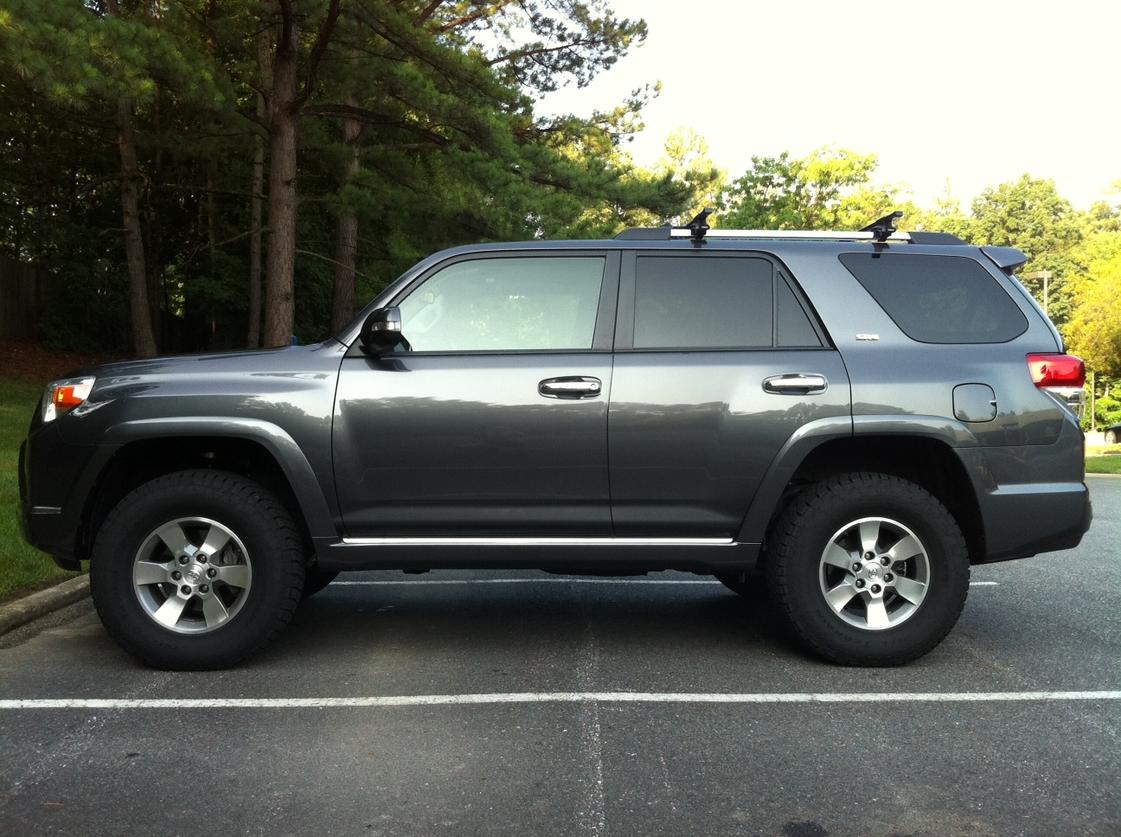

could you shoot a pic from the front? I am interested to see the wider stance, if any.
I will get more pics tomorrow...does have a wider stance. I had my shop install it - $350 for the install and they aligned, etc.

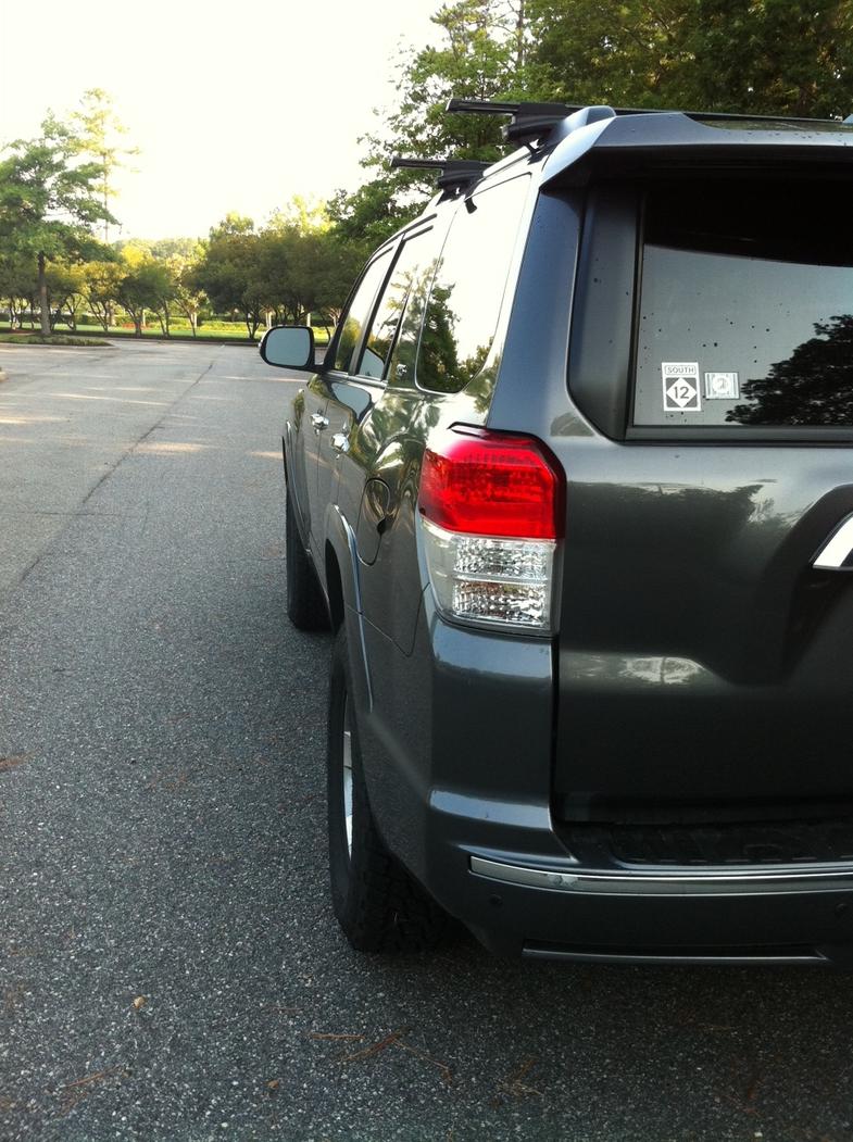

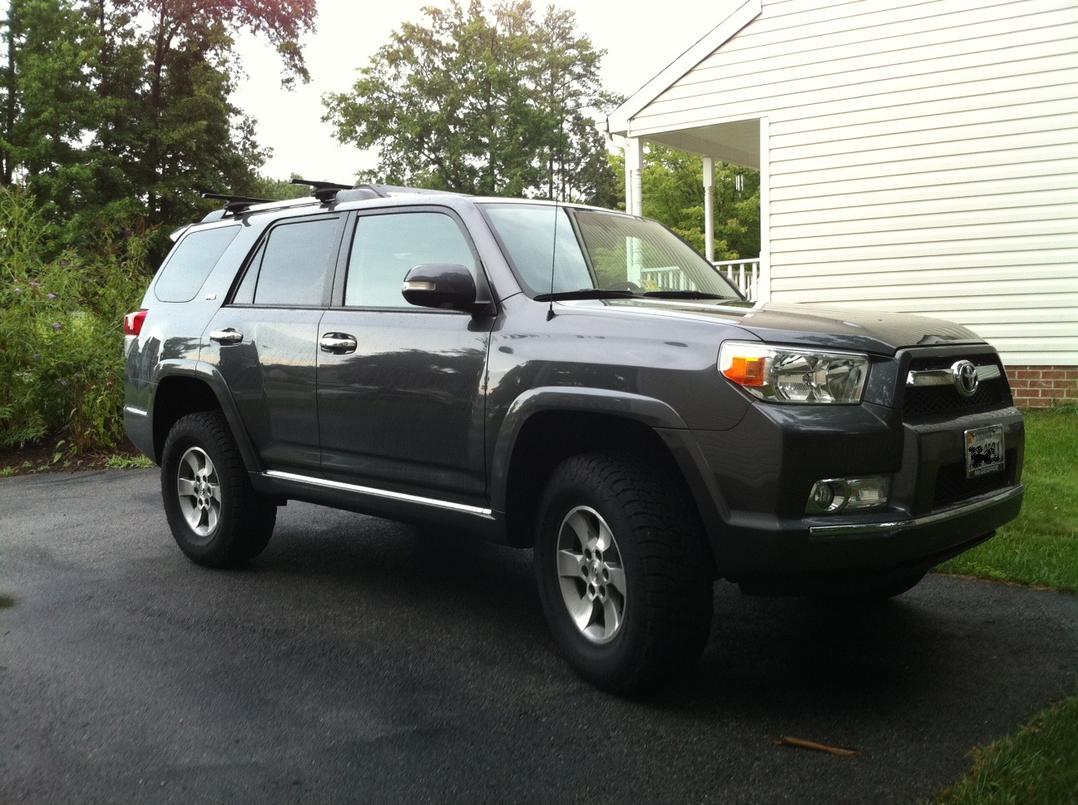

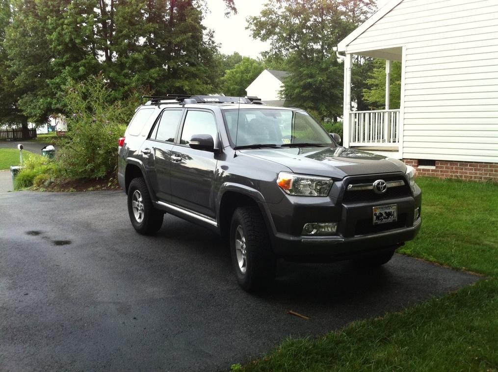

Here are several more pictures...even though it looks better in person!

Looking good Ted. Now you got me thinking more about the 2/1.5 now over the 3/2. I have my 285's on order right now.
I really like your runners stance. Good work!
