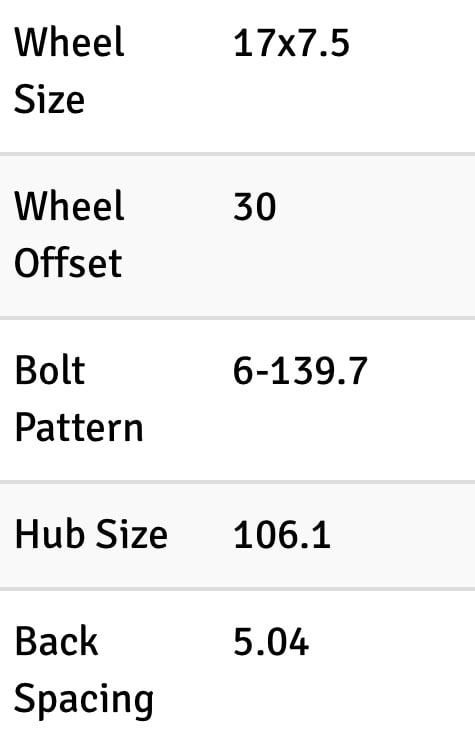

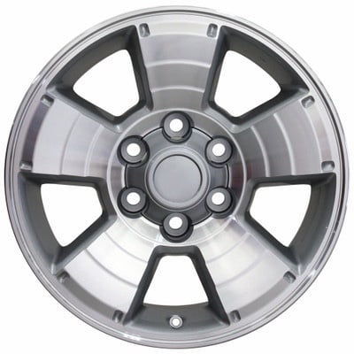

Is anyone running 285/70r17 tires on stock SR5 wheels? At 7.5" wide, they meet the minimum required width for 285s.
Asking because I haven't been able to find a single build running this setup.
Wheel:
Wheel specs:
Wheel:
Wheel specs:
