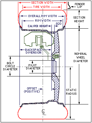

Let me see if I can explain:
A tire (any tire) is produced to have a "natural" shape when inflated. Here is a section view of a tire/wheel:
The red lines are the tire. With a stock wheel/tire combination at normal inflation pressures the tire is not wanting to put any excessive outward force up against the bead because it is at it's design shape. Now let's say you added a wider tire. As you can see by the diagram the tire at the bead will want to expand to it's natural design state which is wider than the wheel but the wheel lip, or bead, prevents that. As you "air down" or decrease tire pressure for a trail, there is less force (because of less pressure in the tire) exerted to keep the tire pressed up against the bead. When you hit a ledge or bump while off road that will tend to "squash" the tire outward in that spot. Since you are running a wider tire than specified that means the tire will try to go to it's natural shape and can become "unseated" or even have the tire extend over the rim which will then deflate suddenly, leaving you to learn more about using your high lift in uneven terrain lol. This is why bead locks were invented.
Now, you COULD run the bigger tires on narrower rims for years with no problems or you could roll the tire the first time out. There is no rhyme or reason as it depends on whether you hit it exactly right. Your chances of doing this go down by running the correct and specified wheel width for the tire. Hope this helps.
