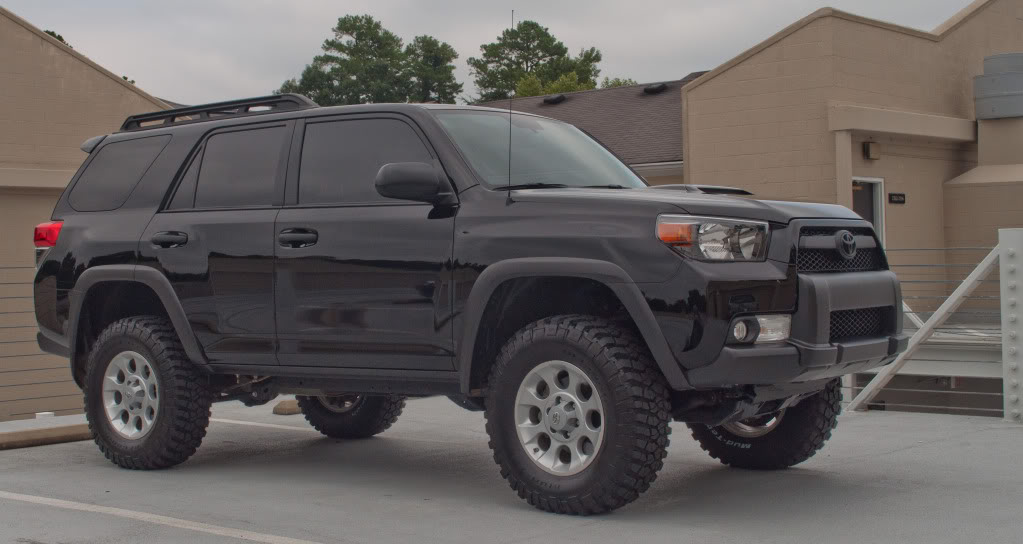

I don't want a huge lift. but the km2's looks so hot. see attached members ride with full lift. Just not looking for that extreme height. though does look awesome. It is my daily driver.

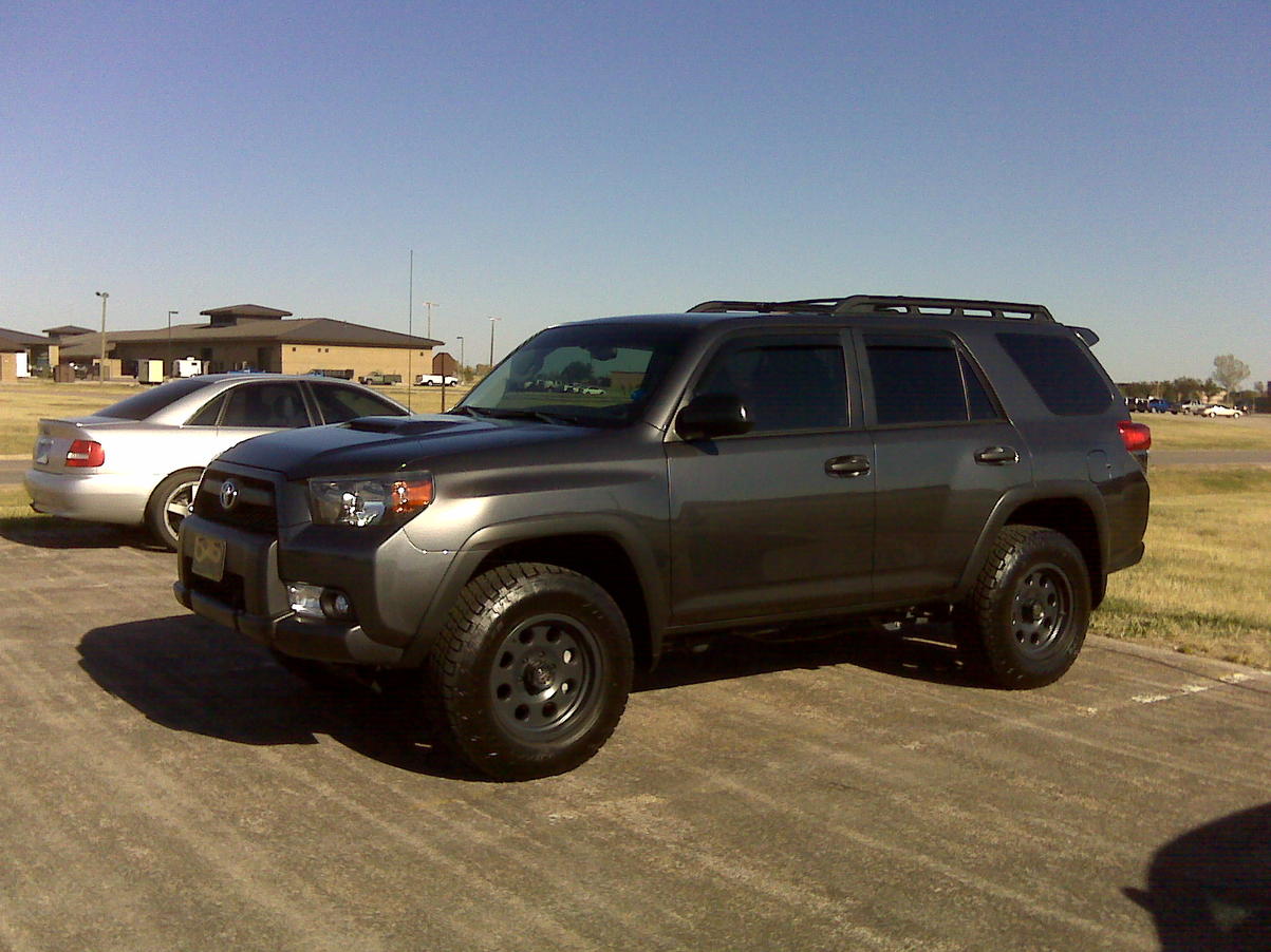

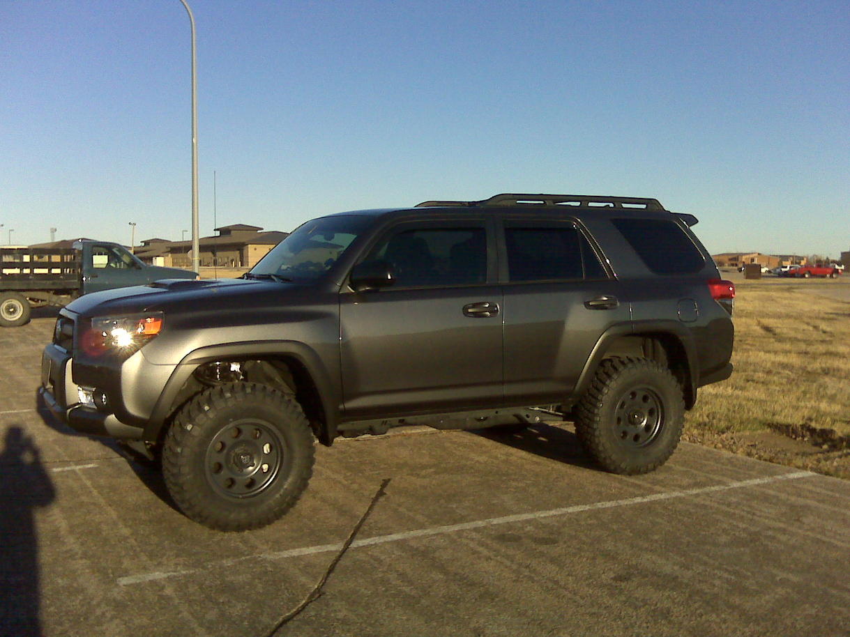

I believe member egstyle has 265/70/17 BFG KM2's on his. Those tires with a leveling kit would look good but be warned once you level it you will eventually end up wanting a lift lol I originally leveled mine and did 265 70 17 terra grapplers then after about 2 months I decided that a lift was in order along with 285s I personally think 285s look stuffed under the 4runner without a lift but to each is his own.
The first pic is leveled with 265's and the second pic is lifted with 285s
