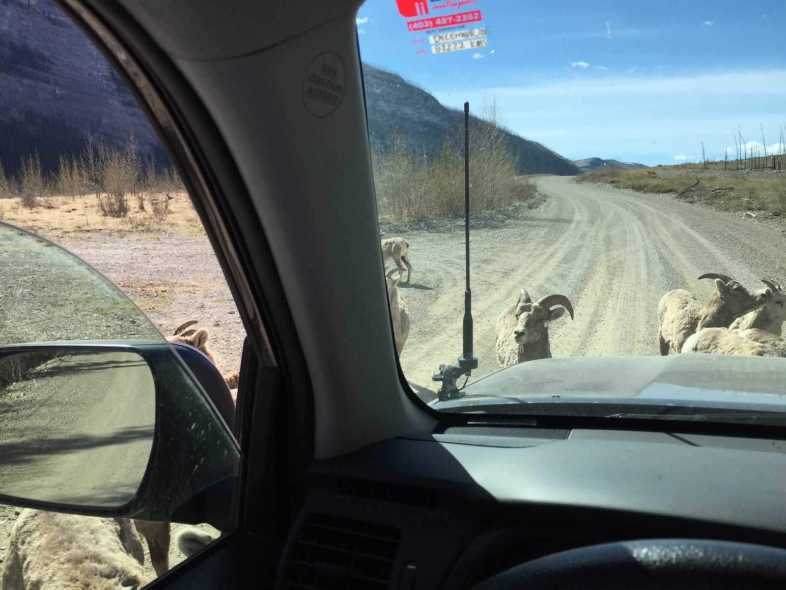

Hood lip mount works VERY well. Check page 1 of my build thread.
I've run mine like this for quite a while and made very good use of it, both for hitting repeaters and working simplex. Does not require additional electrical grounding, just install and go.
The kit I'm running is the Comet CP-5NMO which comes with an RS-730 mount. They are made with UHF mount as well though.
The RS-720 lip mount has a smaller footprint and works just as well if you plan on running light antennas like the SBB5 or SBB1. For heavier stuff, I'd recommend the RS-730 or the RS-840.
For antennas, I'd highly recommend the SBB1 for off-roading and trail comms; it just can't be beat for durability and clearance. It works very well for hitting the repeaters around town as well.

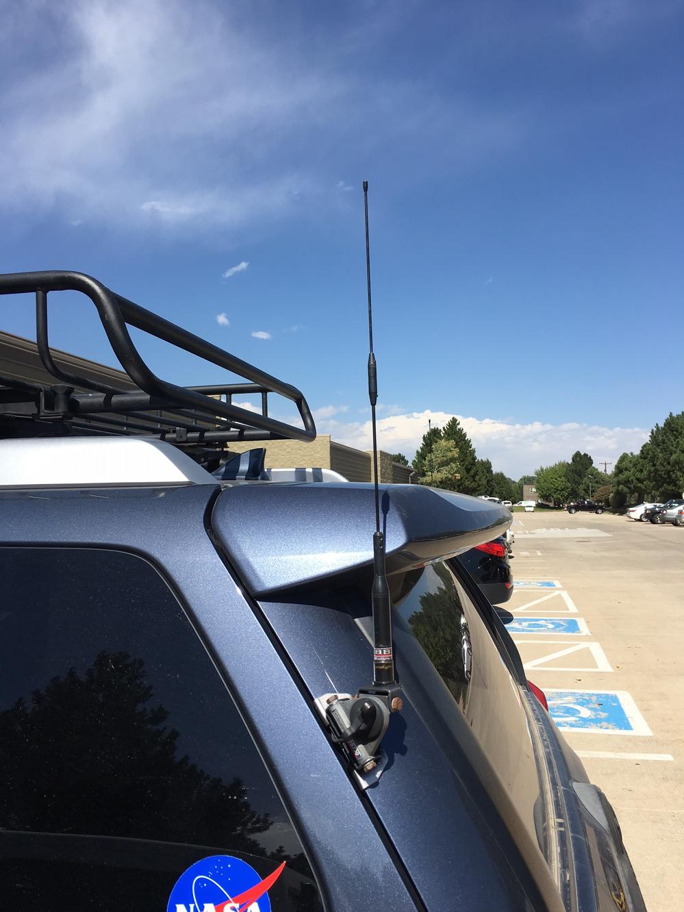

Pic showing mount and SBB1

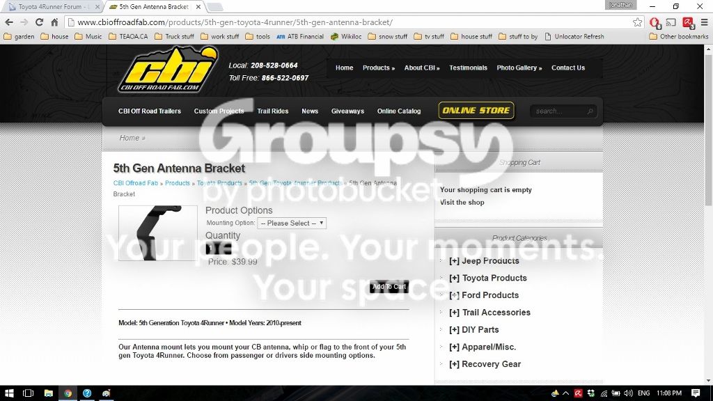

You could get a CBI ditch bracket and run it on there.

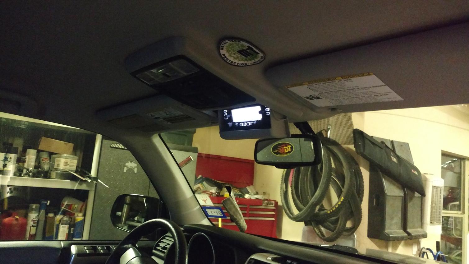

BTW. for some ham nerd stuff. Here is how I mounted my ICOM 2730A.
Still tweaking a few things and learning how to program the radio, but pretty happy with it so far.

It's the same thing as the ditch bracket, you just get 1 instead of 2
I bought one thinking I would use it but didn't for a few reasons. The main reason is that you have to cut or melt the plastic trim piece that it conflicts with. I didn't like that solution and never saw it executed cleanly enough for my preference. It is also way heavier duty than you need for an antenna mount. The exception would be if you are running a fire stick or something on a heavy spring, but its a lot more than you need for a whip antenna. The final reason i didn't use that mount was that I decided I really wanted an NMO mount for the ease of changing or removing antennas. I have the NMO rain caps in my center console and in about 30 seconds I can have both antennas off and rain caps on and can even go through an automatic car wash, if I want to swap antennas its a lot easier with NMO mounts.
Ok, that's friggin cool!
My FTM-400DR wouldn't fit in there, and the GPS would not work, but most of the other Yaesu models would.
