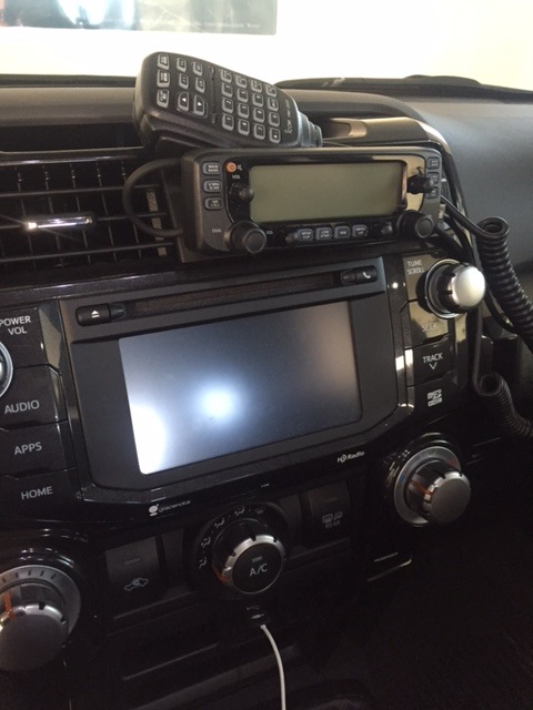

The newer APRS radios have the integrated GPS mounted on the back side of the control head. So the back side of the control head should have a 'clear view of the sky'. Glass is ok, but metal tends to interfere with the GPS signals. Since the sunglass holder is directly under the metal of the roof, it does not work as well as directly on top of the dash. This would also follow for mounting down low in the cubby like e60ral. Incidentally, the gps antenna for the factory Nav system is just under the top of the dash in the center.

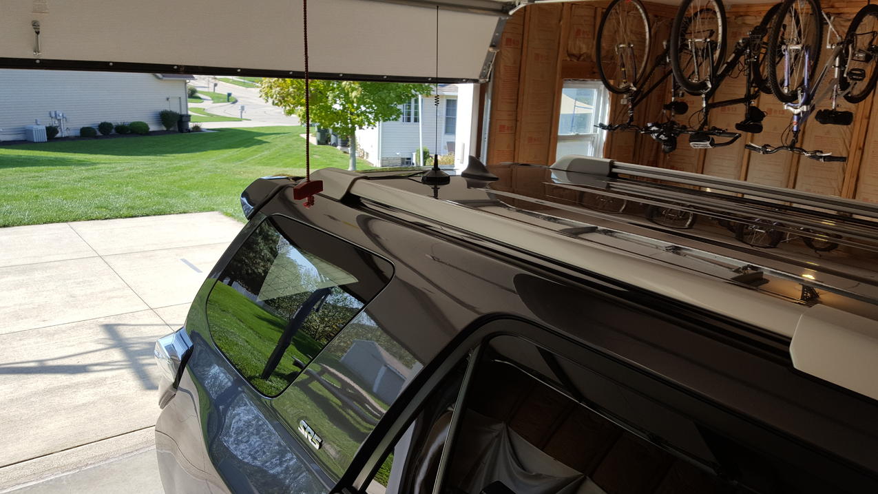

I have the CP-5m mount as above, but my version is the SO-259. For normal day to day, I have a Comet SBB-2 attached, and it works very well hitting the local repeaters. With the mount at this level, it sticks up above the roof about a foot, and it clears my garage door which is 7ft. If I need more gain, I carry an SBB-5 in the car, stored in a 1 inch pvc pipe.
Any flex to this antenna like the SBB-1?
I thank you all for this thread...and now that I installed my ham today, I realized it is a combination of what is in this thread!

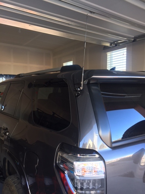

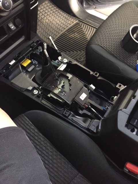

Icom 2730A with a Comet SBB-2, with the CP5 lip mount on the driver's side hatch. I already had the CP5 with PL259...ran the cable through the top of the cargo area liner, down the d-pillar on the passenger side, through the plastic over the rear wheel, under the kick panels on the passenger, and under the front passenger side seat to the Icom brains. I ran the cable to the head unit through the center consoler9 and up behind the ac controls and out the dummy switch cover inside the glove box. I drilled a hole and put a grommet to protect the cable. Power cable also runs through the center console, up and under the steering column and through the driver side firewall. Haven't installed a hanger for the mic...and just using my magnetic cell phone holder that fits in the vent. Pretty secure actually, not sure if I'll leave it there.

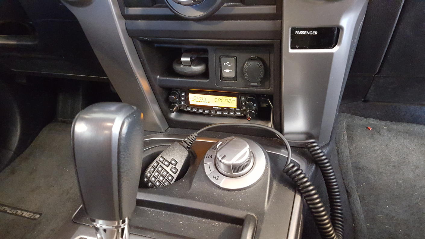

Just installed my TYT TH-9800 quad band and Tram magnetic 2m/70cm antenna. I ran power direct from the battery through the firewall rubber grommet on the drivers side, used 10ga wire and a 40 amp circuit breaker. The hvac part of the dash pops of easy and allowed me to hide the wires. The head unit is just velcroed to the carpet under the passenger seat.

Its really not flexible at all (in my opinion...I guess it does bend a little, but I'd be afraid I'd snap it on a sturdy tree limb)...you could add some flex to the mount with a spring, similar to the rigid firestik antennas for CB.
How physically flexible is the SBB-2?
