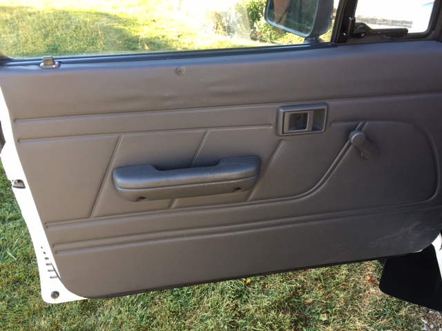

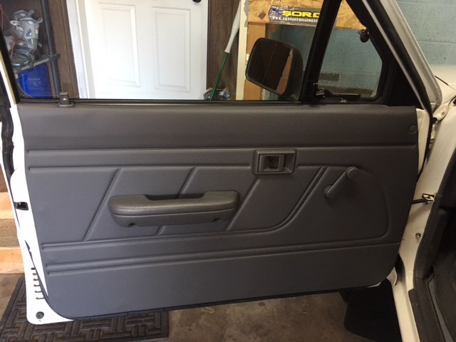

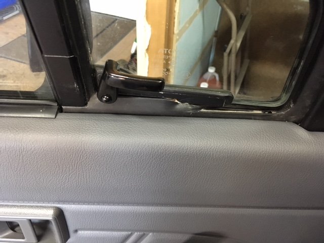

I found this thread incredibly useful. I have a 1993 pickup with wing windows and the driver's side door panel was getting haggard. Much to my dismay, the wing window door panels are no longer made. I took a $216.00 gamble and ordered a non-wing window door panel from the dealership, hoping it would be similar to your 4Runner door panel modification shown above. Luckily it was, and it took a measly 20 minutes to modify and install the non-wing door panel. No one would ever guess it's the "wrong" part that even the Toyota stealership cautioned me not to purchase. Thanks!
