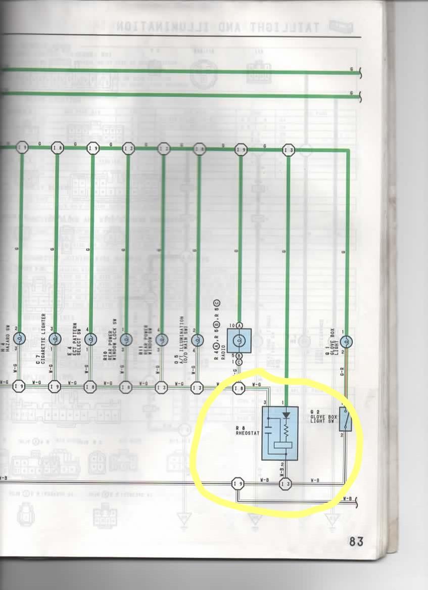

I added an e locker and the last issue is the elocker switch light to work along with the dash lights. Since the switch is located near the dash light dimmer pot I thought I would tap in there.
I used my test light and picked one of the 3 wires ( I think its white/green) and when the lights were on the test light would light and it would dim when the pot was rotated. So I put everything back together and the odd thing is the added elocker switch light works opposite of all other dash lights. When I rotate for max brightness for dash lights the elocker light dims. When I go for max brightness of the elocker switch the dash lights dim. What the heck.
The elocker switch is 10 pin with 2 pins for the light. One pin power the other ground.
Any advice before I pull the dash off again?
