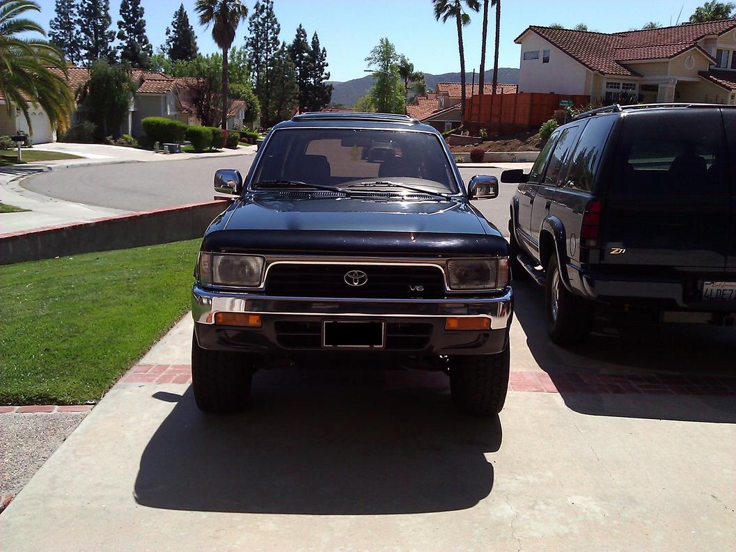

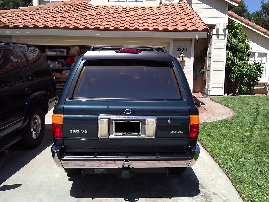

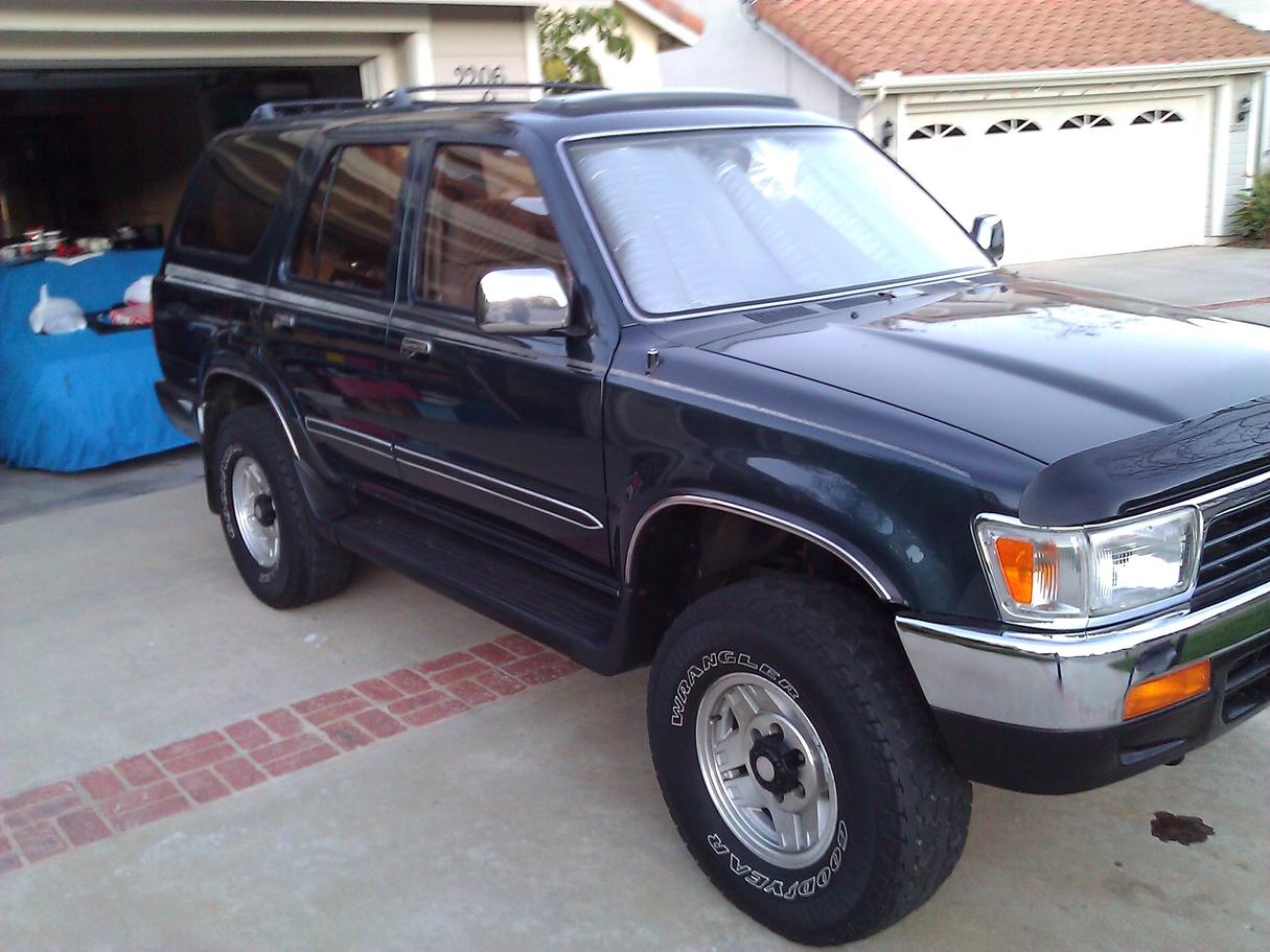

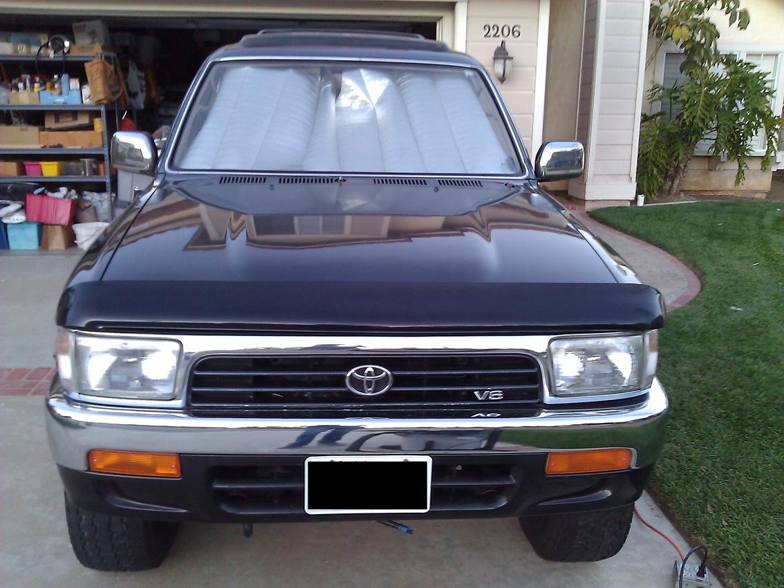

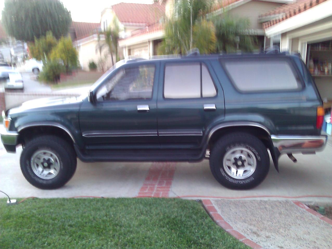

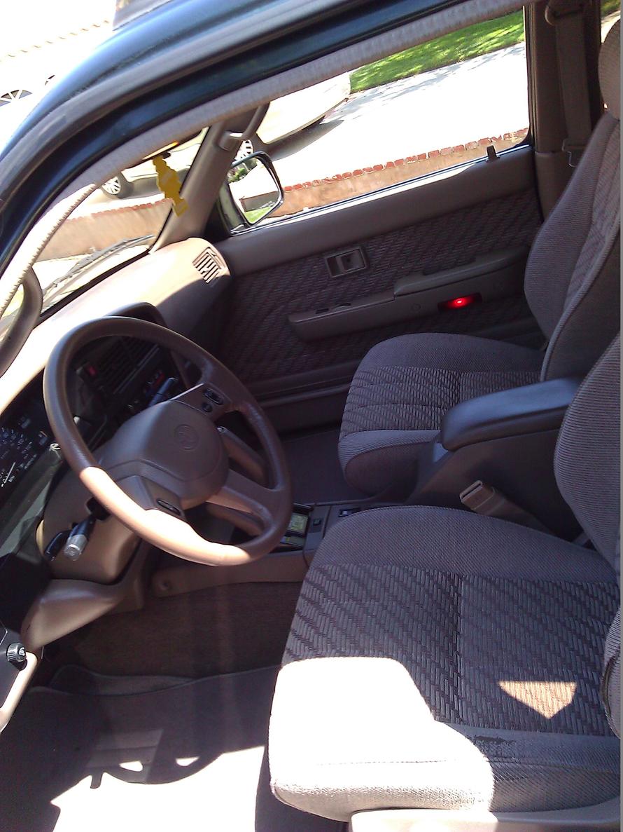

This is my first thread post and I thought I would post a little history about my 4runner and how I got it. My name is Tanner and I'm almost 19 now, but about 2 years ago I was looking for my first car since I knew my 1986 944 wouldn't be running in time to start daily driving. So I was 17 and I had my permit when I thought I’m going to need a first car to drive that’s going to be reliable and able to haul things around. I really wanted a 1989-1995 Toyota Pickup since my grandpa had bought an Xtracab SR5 V6 new in 91 from Crown Toyota. He passed that truck on to my brother when my brother got his license in 2002. So after my grandpa then went out and bought a 2002 Frontier (I don't know why because his previous 2 trucks were Toyota's). Then in 2004 my grandpa passed away and his Frontier was sitting in the garage so my brother sold his 91 Toyota to buy the Frontier from my grandma. I told my dad and brother not to sell the 91 Pickup because I wanted it, but they sold it anyways. So ever since that I always wanted to find an identical truck to replace it. So after looking for years before I even had my permit I found out my dad used to have a 1974 Porsche 914 back in 75 so me and my dad looked for a year to end up finding a 1972 Porsche 914 2.0. After that I was always interested in anything Porsche, which led to the 1986 944 that my dad found 4 years ago on Craigslist for $500. Ever since then I have been trying to get it road worthy and its taken a lot of time and money. Then 2 years ago I got my permit and started looking for a car to drive. I looked and looked for a 1989-1995 Toyota Pickup Xtracab SR5 and all of them were just beat to hell with an exception of a few that were really nice for the money but every time I called they were sold. After that I thought I needed to look at another vehicle because these trucks are just way to hard to find. So I knew a few people that had 4runners and they loved them, so I thought why not its basically a enclosed version of the truck. So I looked at 2nd gen. and 3rd gen. 4runners since those were my favorite body styles. Kept looking in Craigslist and looked at a couple 4runners in person until I found a 1995 4runner SR5 V6 Automatic with 129,000 miles for $5000 in Glendale, CA. My dad looked at it since he was in L.A. and I was in San Diego, talked to my dad and he said the truck was really nice but need a few things done to make it perfect. So I called the owner and offered him $4500, next thing I knew I was on a train to L.A. to go pick up the 4runner.

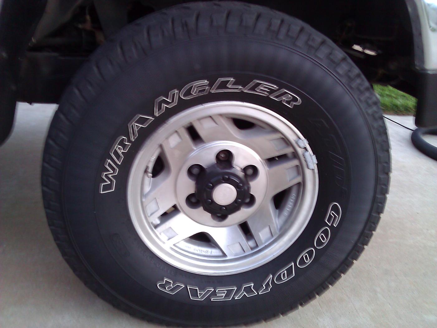

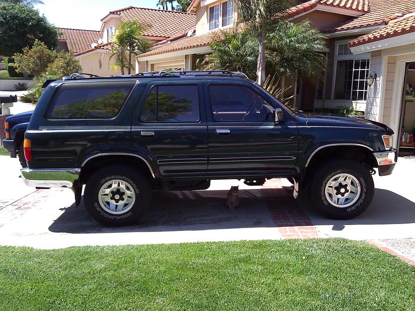

Here is some pictures when I first got it back in Nov. 2011:
Some more pictures:
More:

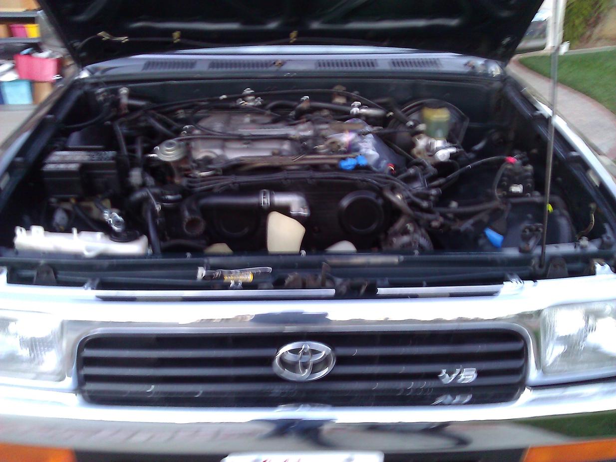

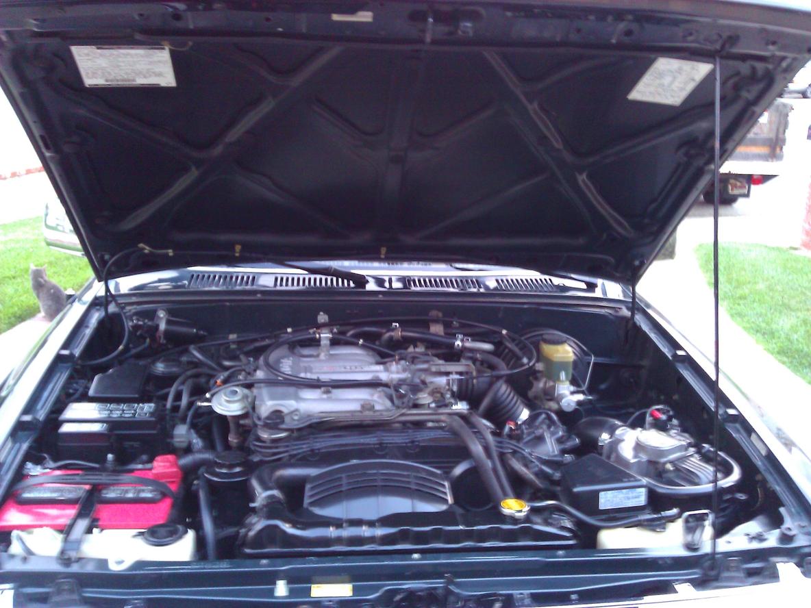

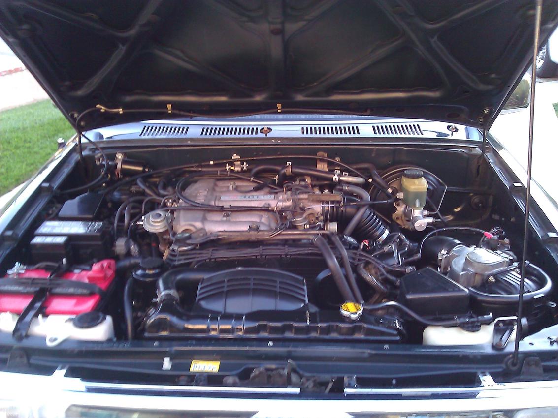

Here is a list of things I have done to the truck since I bought it:
- Purchased with 129,600 miles at the end of November 2011.
- NON-OP when purchased from previous owner, owner said “they didn’t drive it enough to register it”.
- 12/22/11 Title Issued under my Dad’s name for cheaper insurance.
- Registered - 1/22/2012 previously on NON-OP because went to the DMV in December 2011, have to pay for two years of registration even though your only registering for a month till its 2012, unless I wait till January to register it since the DMV renewal for the truck is in January.
- 1st service was accomplished by me in front of my house in the driveway:

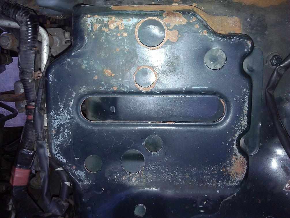

-Took battery out, hold down clamp, j-bolt, 1-nut, and 1-bolt missing so
purchased new at Crown Toyota.

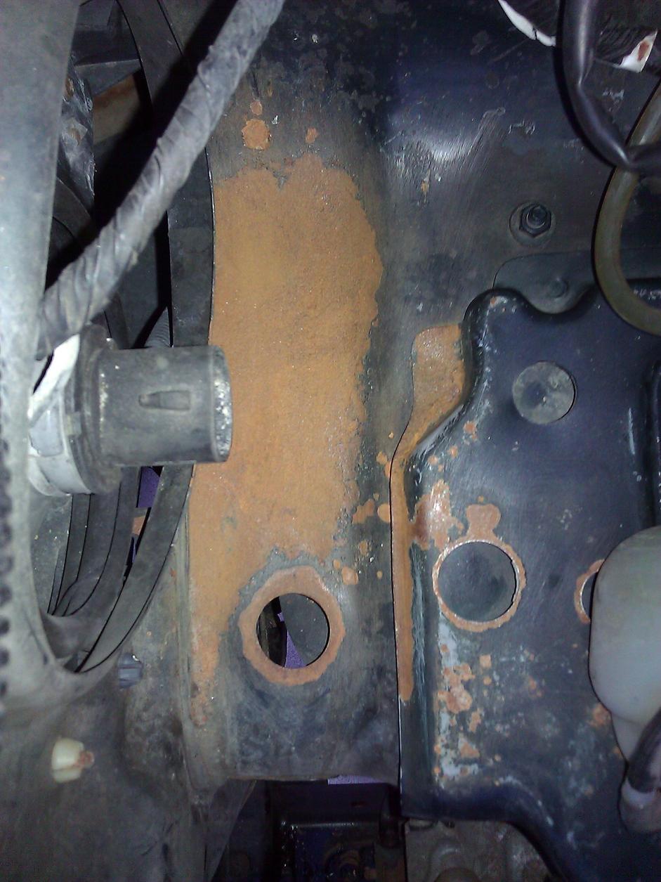

- Zinc primed battery support then painted battery support because it was starting to rust a little. Went to Auto Meza Paint and got the color coded paint(Evergreen Pearl).
- Radiator was filled with rusty colored antifreeze/coolant, so I drained the whole system, then flushed everything out. Took radiator down to Ronny’s Radiator Shop in Escondido, had radiator cleaned and pressure tested, checked out fine. Picked up the radiator and found it was spray painted and wasn’t happy with how it looked so I sanded and painted with POR-15.
- Plastic radiator shroud was held on with 2 paper clips so I replaced it with a new one from Crown.
- Took thermostat off when flushing coolant system, it was a cheap aftermarket thermostat so replaced it with a genuine one from Toyota of Escondido. Then sealed thermostat housing with FIPG.
- Painted the bottom part of the top coolant inlet and resealed with FIPG.
- Removed radiator expansion tank, cleaned it and then reinstalled it.
- Installed a new radiator cap, bought it from Toyota of Escondido. Original cap had bad gasket.

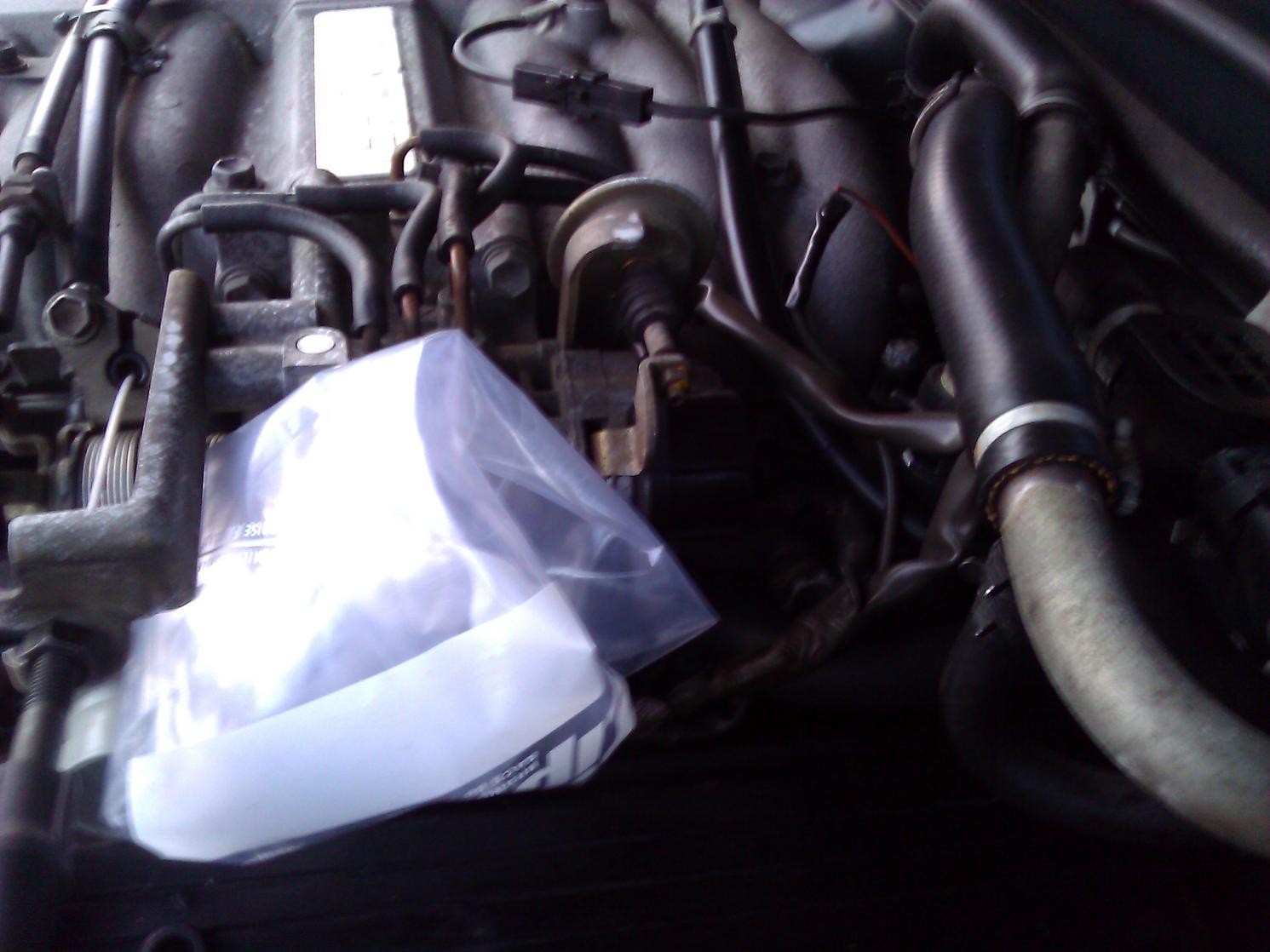

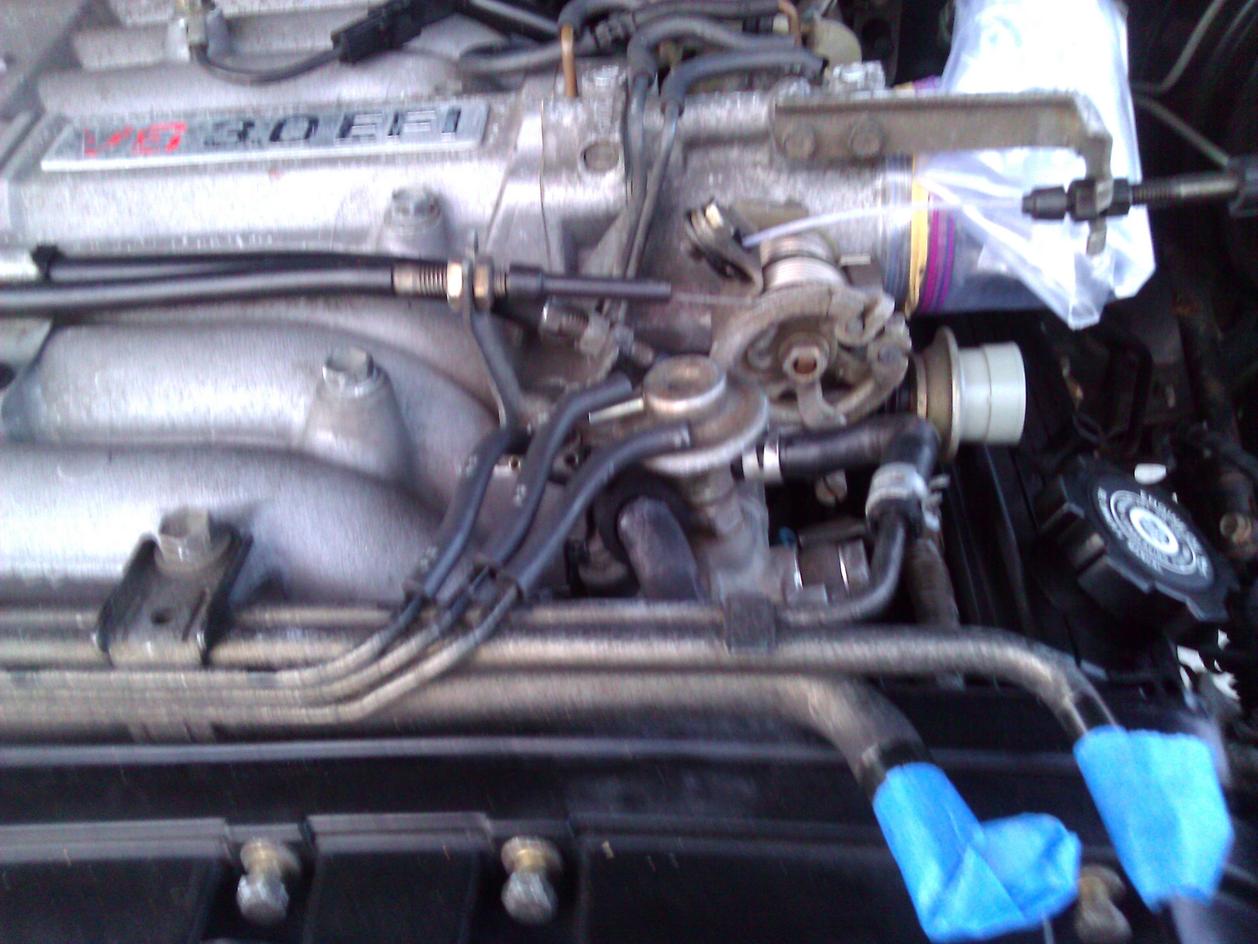

- Took the whole air intake system off, excessively cleaned Mass Air Flow inside and out. No filter in air box when I bought the truck so I put a new one in from Crown.
- Replaced air intake hose from throttle body to air intake elbow, purchased from Crown.
- Replaced breather hose from left valve cover to air intake hose, purchased from Crown.
- Smelled like their was a Gas leak when truck would idle.
- Took plenum off cleaned as much carbon build up as I could. Detached throttle body from plenum, cleaned inside and out. Replaced gasket between throttle body and plenum with new one from Crown. Also replaced dash pot and dash pot screw with new one from Crown.
- Replaced fuel damper(thought of gas smell) with new one from Crown.
- Found cold start injector mounting bolt was cause of gas smell, just tightened it and gas smell went away.
- Previous owner or mechanic who worked on the truck broke the rear intake manifold stud and he also elongated the hole for the plenum. I drilled out the stud and put in a new stud with JB weld, didn’t hold. Eventually intake manifold and plenum need to be replaced. No vacuum leaks.
- Valve cover’s seeped oil so I removed and cleaned them. Installed new valve cover gasket’s, pcv valve, and pcv valve hose and they were purchased from Crown.
- New plenum gasket from Crown was installed.
- New spark plugs, wires, distributor cap and rotor purchased from Toyota Parts Barn.
- New accelerator cable from Toyota Parts Barn.
- Replaced rear axle and front differential fluid with Mobil 1 75w-90. New fill and drain plug crush washers from Toyota Parts Barn.
- Transfer case fluid replaced with Toyota Dexron Transmission Fluid. New crush washers for fill and drain plug from Toyota Parts Barn.
- Had fuel filter, fuel line to engine, and automatic transmission fluid all replaced at Alternative Automotive with genuine Toyota parts . Automatic transmission pan was dropped, cleaned, then resealed with Toyota FIPG for transmission parts(Orange). Used Toyota Dexron Transmission Fluid to refill transmission.
- Went to Gallant’s wreckage yard for a used rear bumper and driver’s side headlight because the truck had a chipped headlight and the rear bumper was rotted out. Only bought headlight at Gallant’s.
- Went to Highway 67 Truck Dismantlers for rear bumper found a perfect one with bumper supports.
- Removed old bumper and spare tire. Got the spare rim sand blasted and powder coated in the factory finish.
- Painted spare tire support with POR-15 since it was beginning to rot.
- All new spare tire hoist components from Crown.
- Under coated rear bumper with rubberized undercoating from Duplicolor.
- Painted bumper supports with POR-15.
- Polished rear bumper.
- Installed rear bumper and spare tire components.

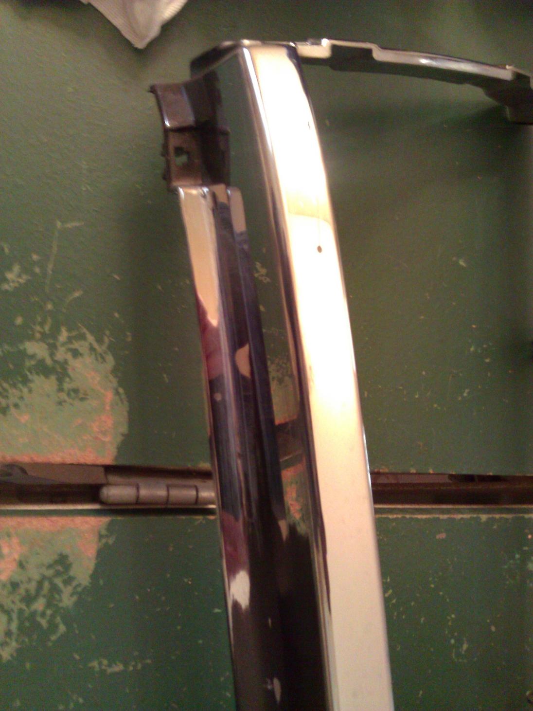

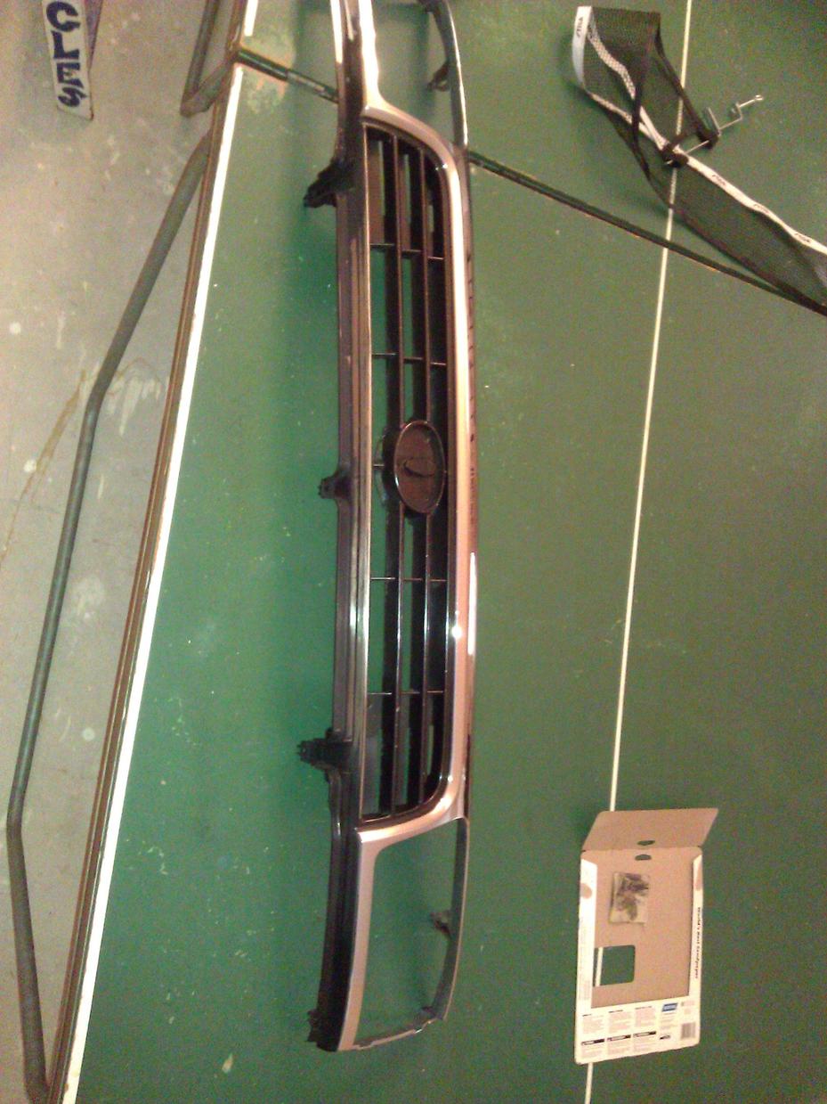

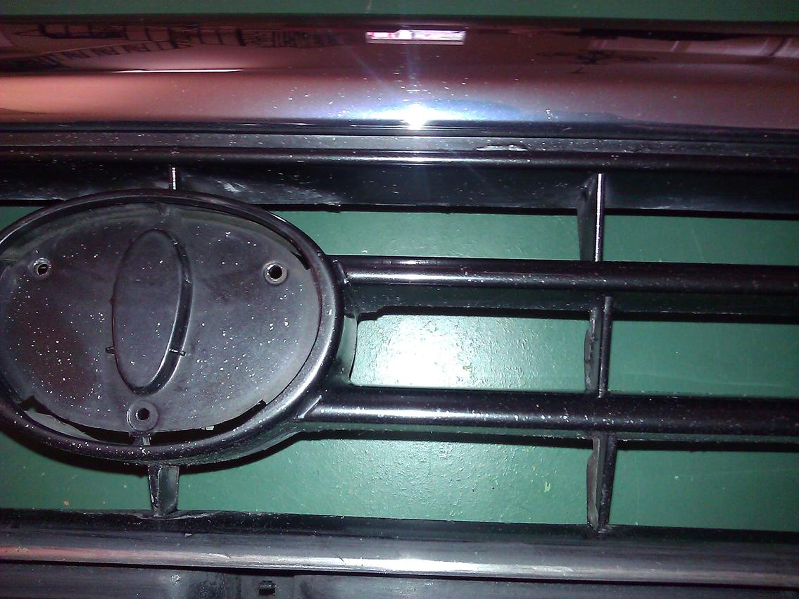

- Removed front grille, stripped paint because of rock chips. Painted with SEM Black Trim Paint.
- Polished chrome on grille and polished all lights on front end.
- Removed front bumper because it wasn’t aligned properly, undercoated rear of front bumper, reinstalled-properly aligned. Replaced all front light bulbs with ones from Crown.
- Removed hood latch, cleaned, and painted it.

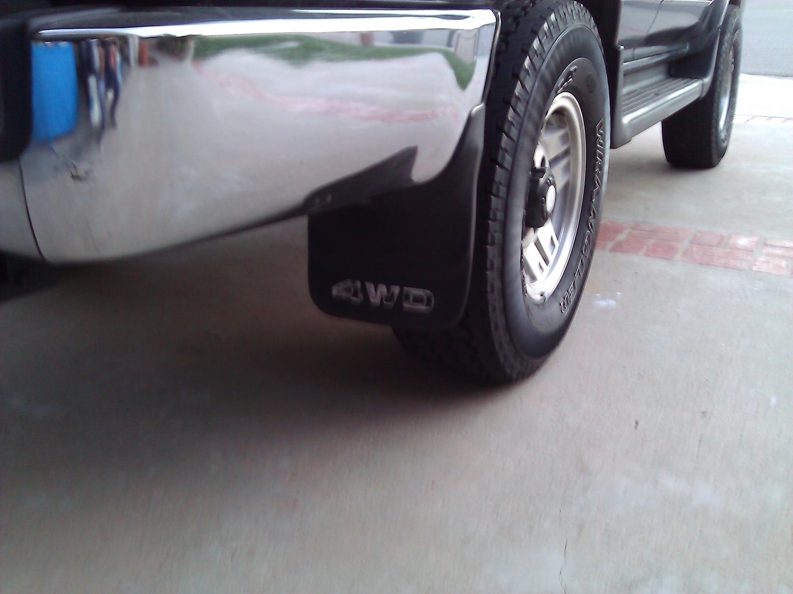

- Replaced rear mud flaps with new ones from Crown.
- Took factory step bar off and put factory mud flaps on front from Crown.

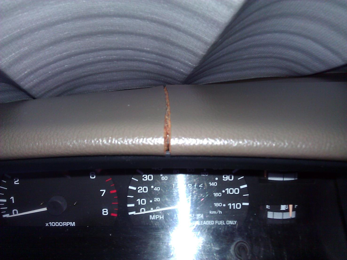

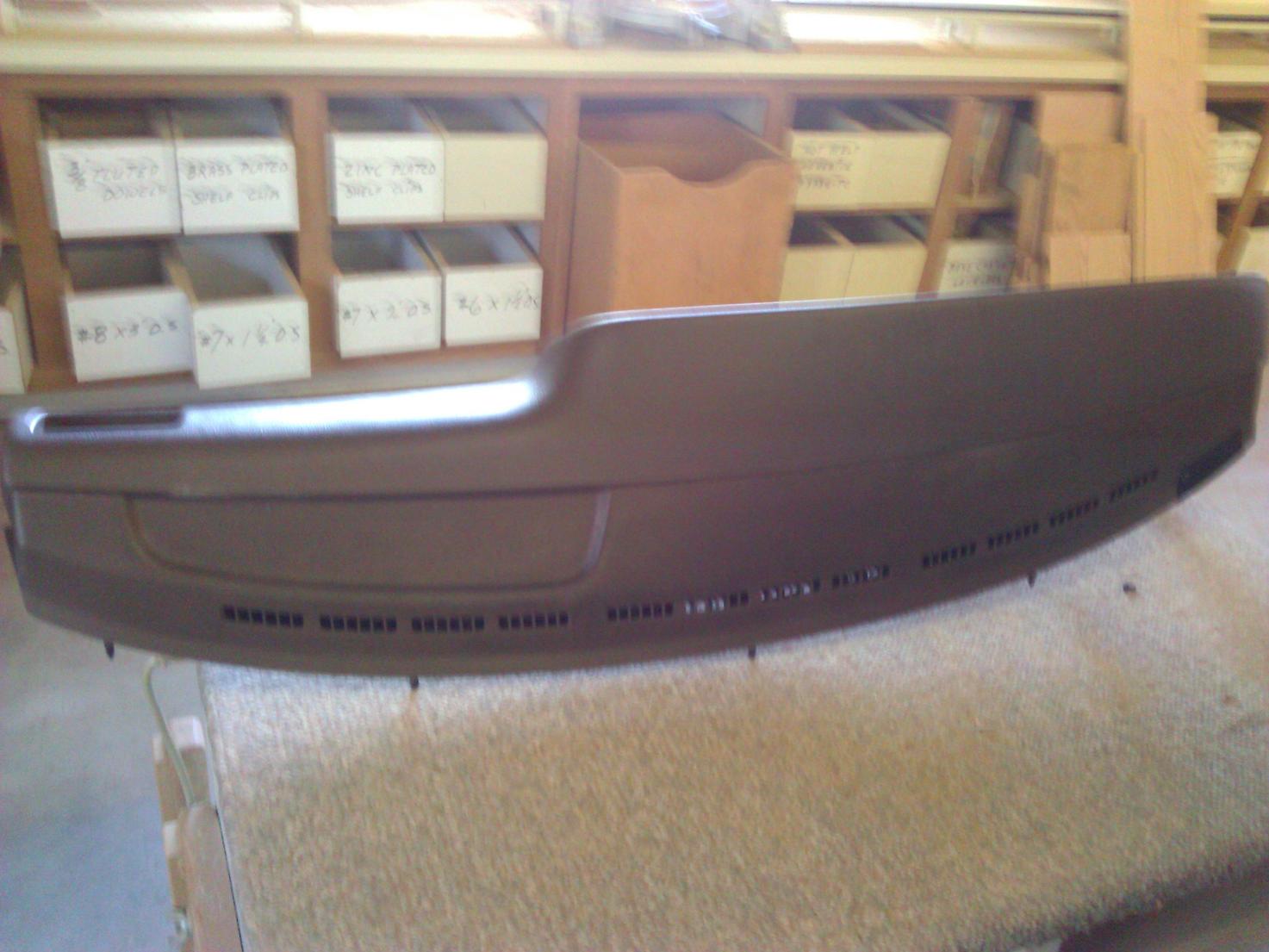

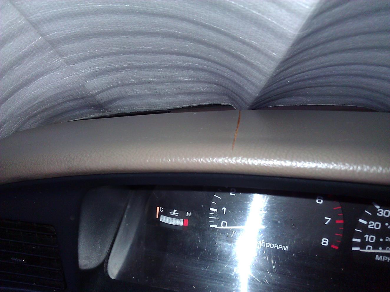

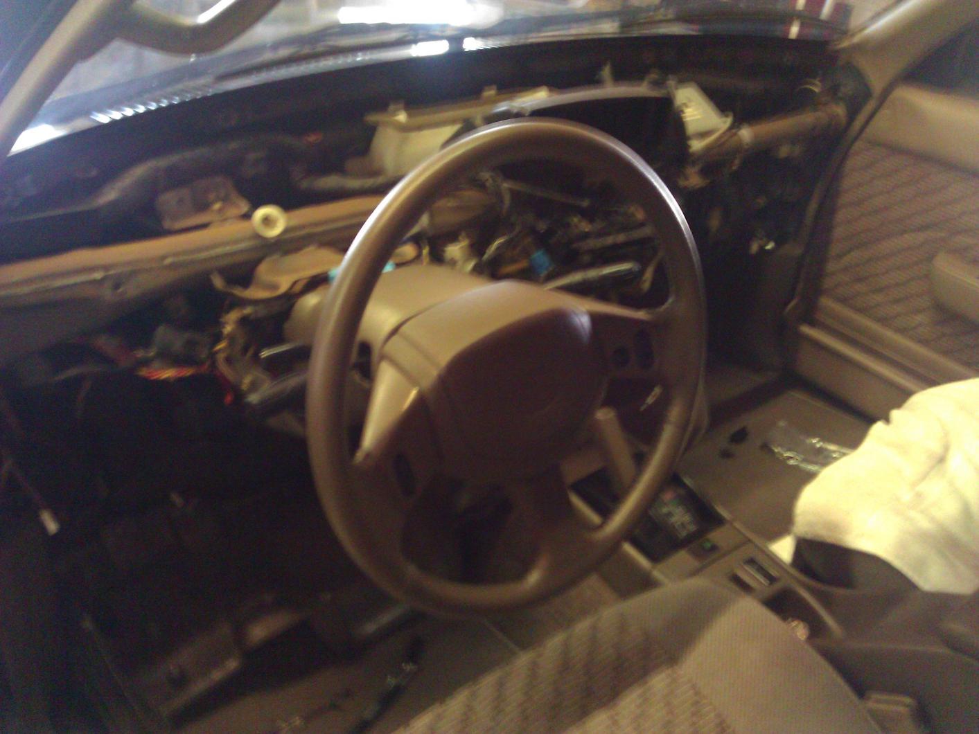

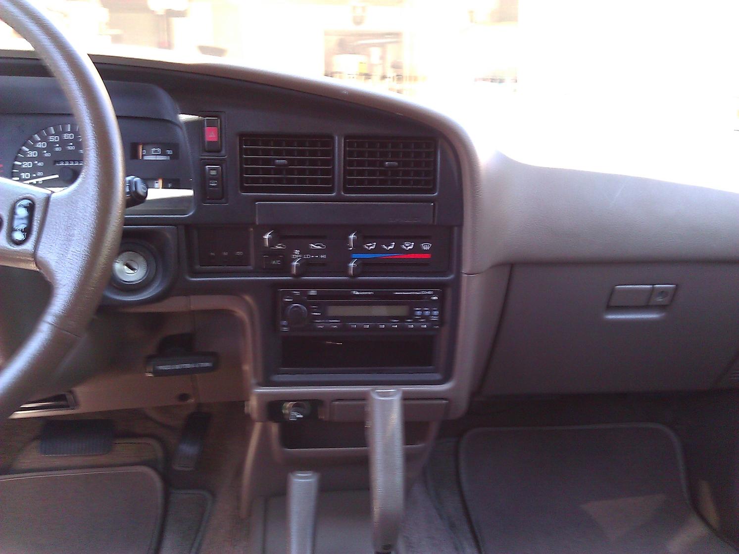

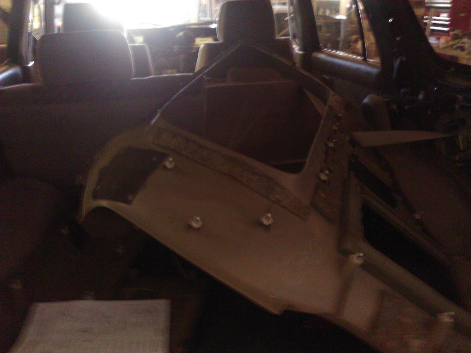

- Replaced dash pad with used one (Perfect Condition).
- Painted center dash part because paint was discoloring.

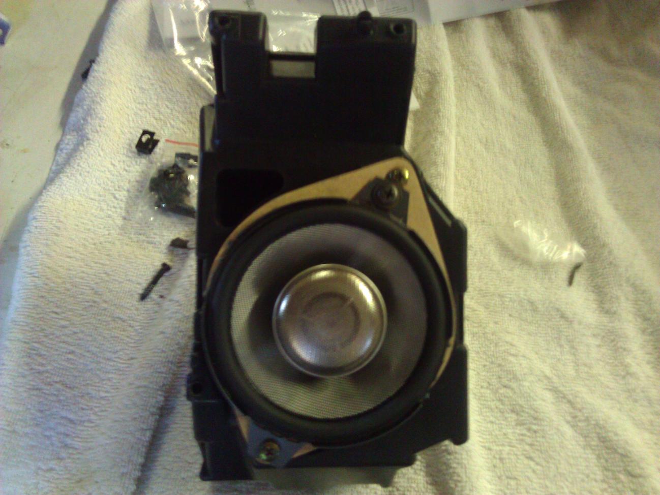

- Installed 4” Infinity Kappa Speakers in front factory location.
- Installed 5.25” Infinity Kappa Woofers in rear factory location.
- Installed 1” Infinity Tweeters in rear factory location.
- Installed new Nakamichi head unit in dash with aux cable that goes into storage box.
- Replaced drivers side door light housing.
- Replaced front and rear wiper blades with new ones from Crown.
- Missing Air Filter Replacement sticker so purchased one from Crown.

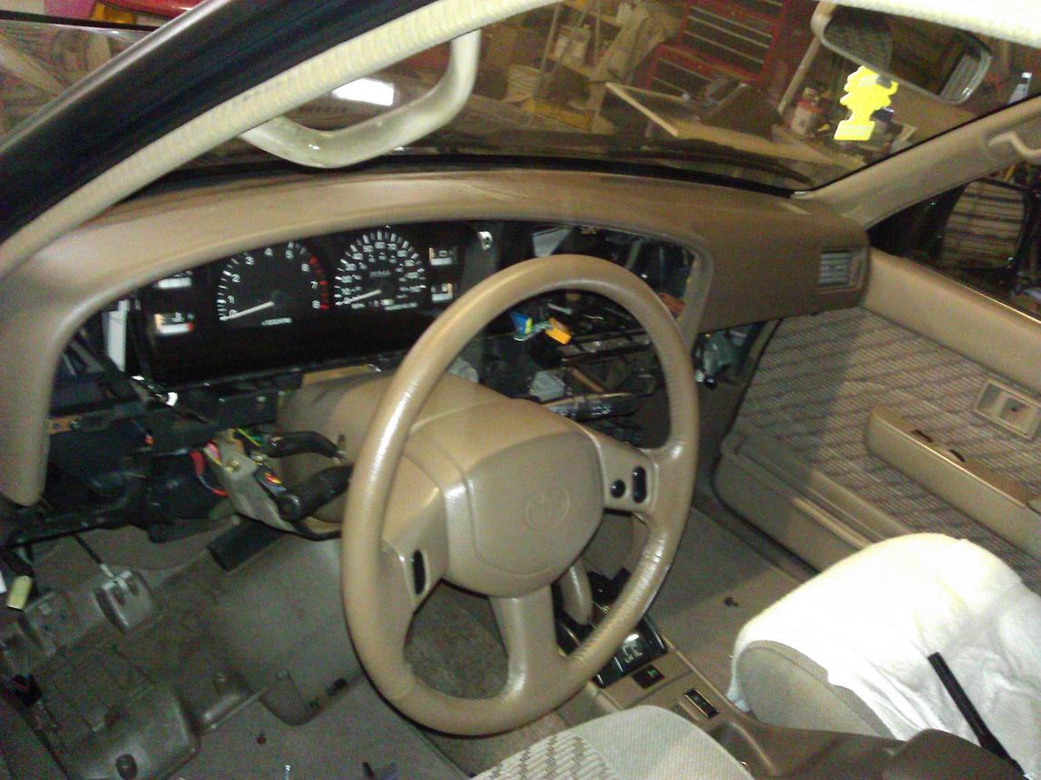

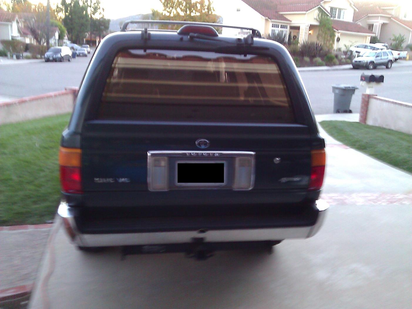

Pics
Pictures from past to present
Pics
Pictures from past to present:
Pics
Pics
Pics
Pics
Pics

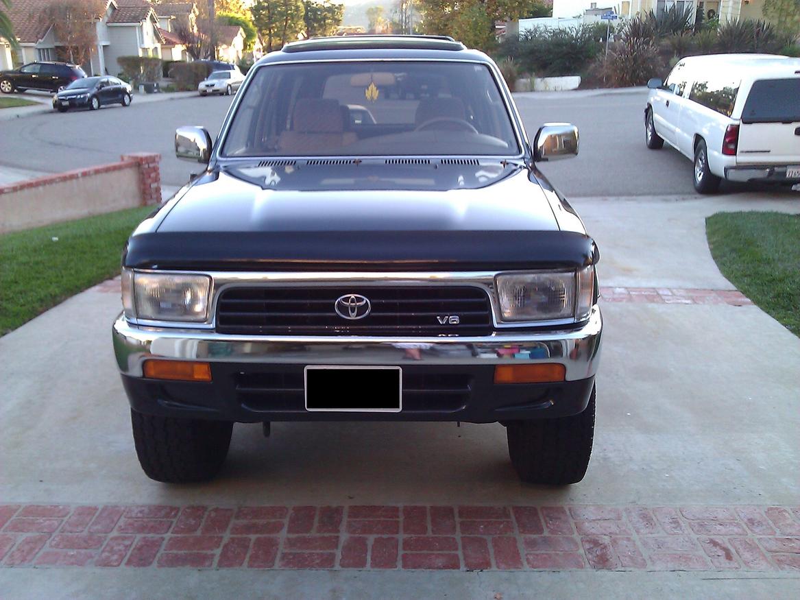

Recent pictures from last week after i got done waxing it:

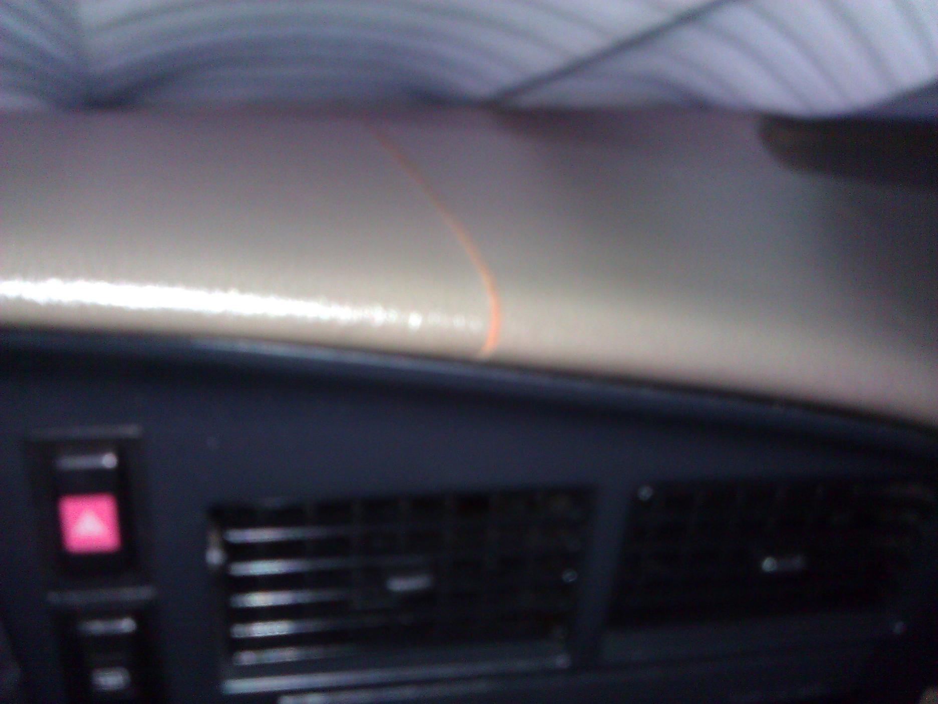

Where did you find the perfect condition dash pad? I've been looking all over SoCal trying to replace my cracked dash with no luck.
Dash
OCMike I found the dash in the San Diego car parts section of Craigslist. I actually got the dash pad and the support which is the part the pad attaches to for $50, I consider myself very fortunate since the guy basically delivered it to me for no charge since he was in the area, and the funny thing is, is that supposedly the dash came out of a theft recovered 1995 Evergreen Pearl 4Runner just like mine and the reason they took it out was because the insurance company wanted to replace most of the interior with new pieces but that was back in the late nineties when the truck was still considered fairly new. So long story short is I guess you just have to keep your eyes peeled.
