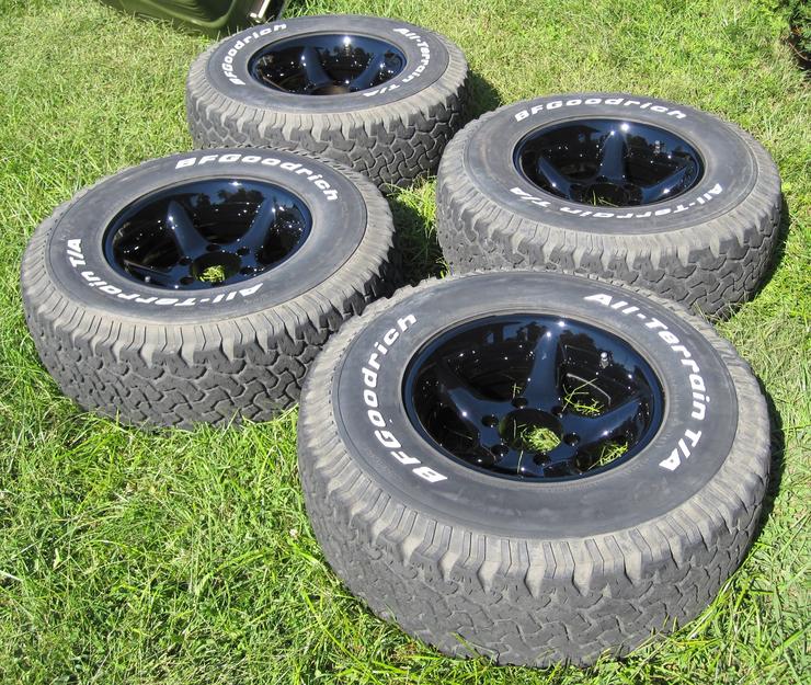

My Ultra (crappy) wheels lost their shine real fast and started pitting. So instead of fighting that battle for years to come I decided to paint them black to match the truck.

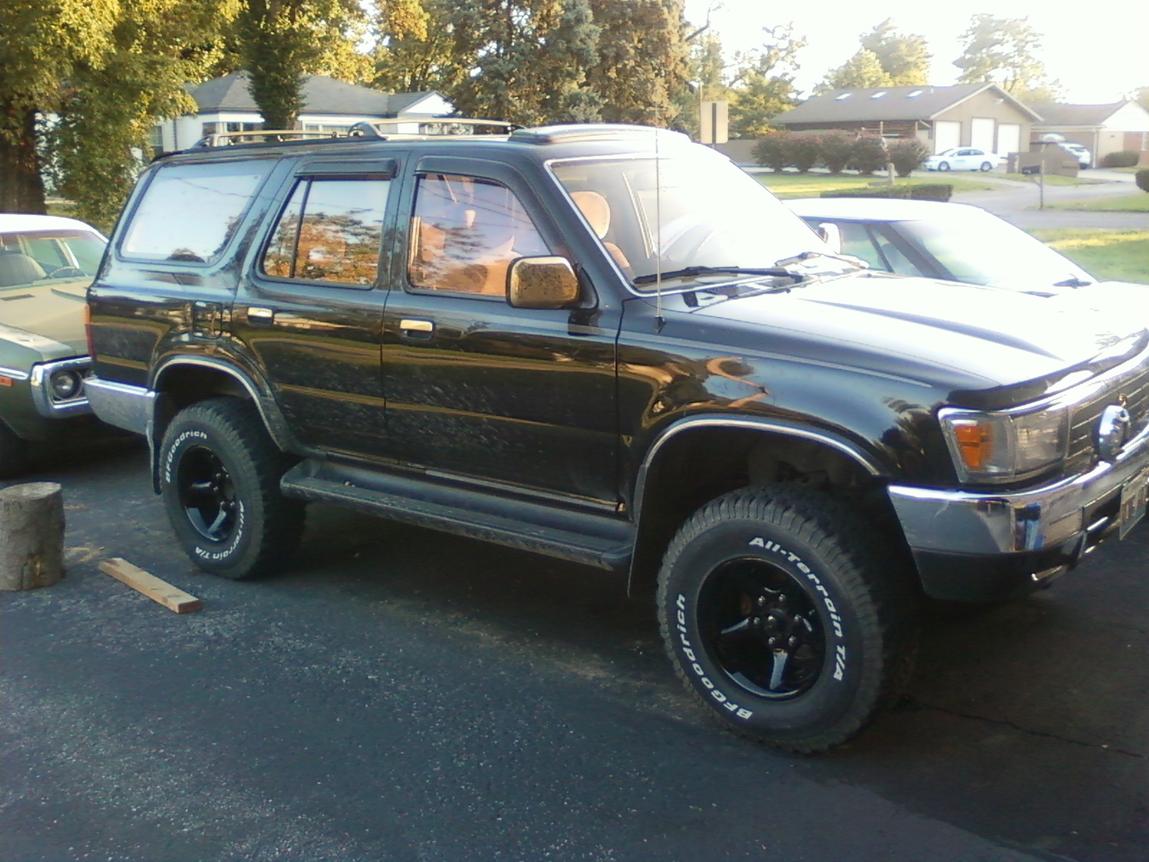

My 93 4Runner I got in November. It's got the 3.0v6 and 5spd with 356000 km on it. Not the best pic but whatever.

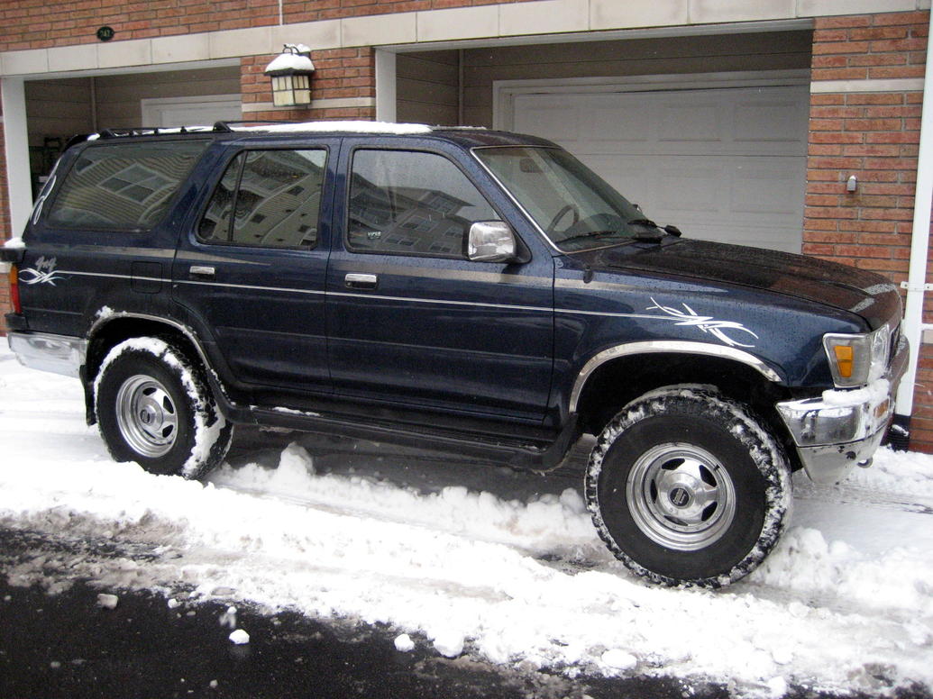

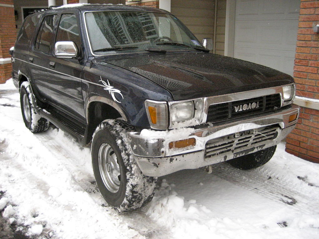

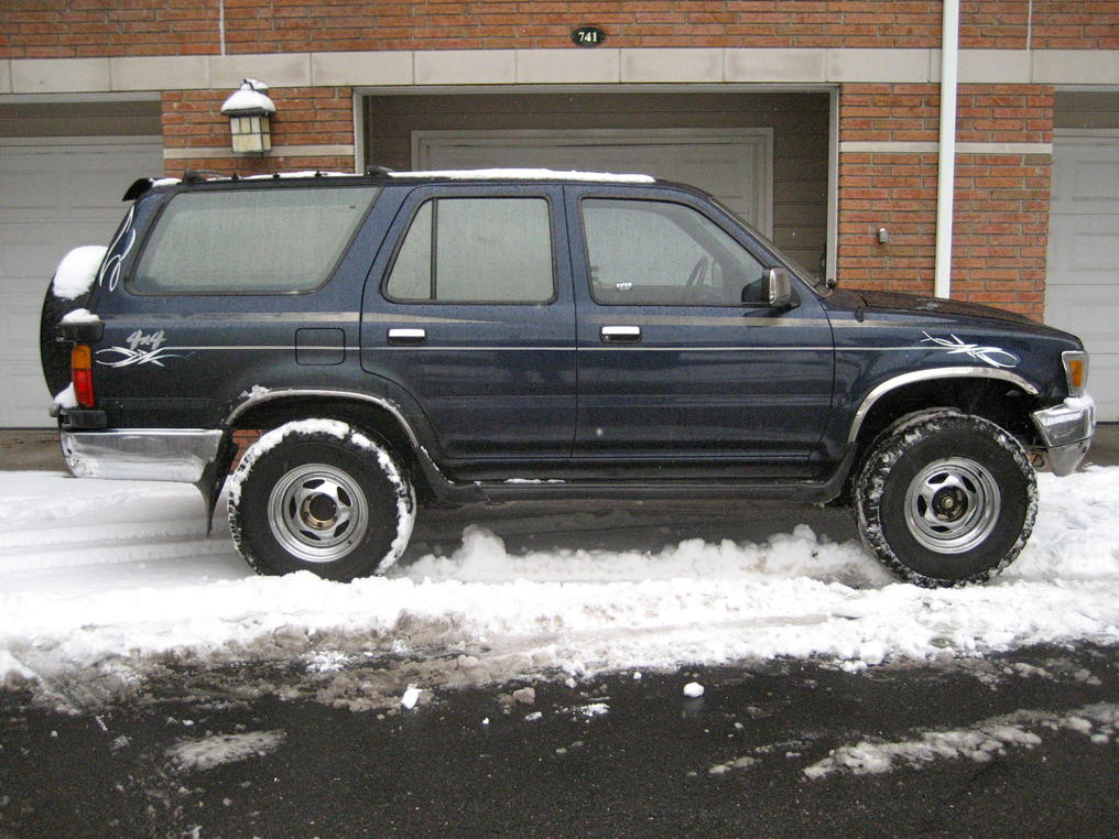

time to get rid of the corny tribal art and 80's rims...love those black steelies i've seen here in the site but do i need to jack up my ride? Are 15" or 16" better? how wide? i'm new to this... i know the rear sags a little bit. i need to get with someone who know's their sh*t in northern NJ.
