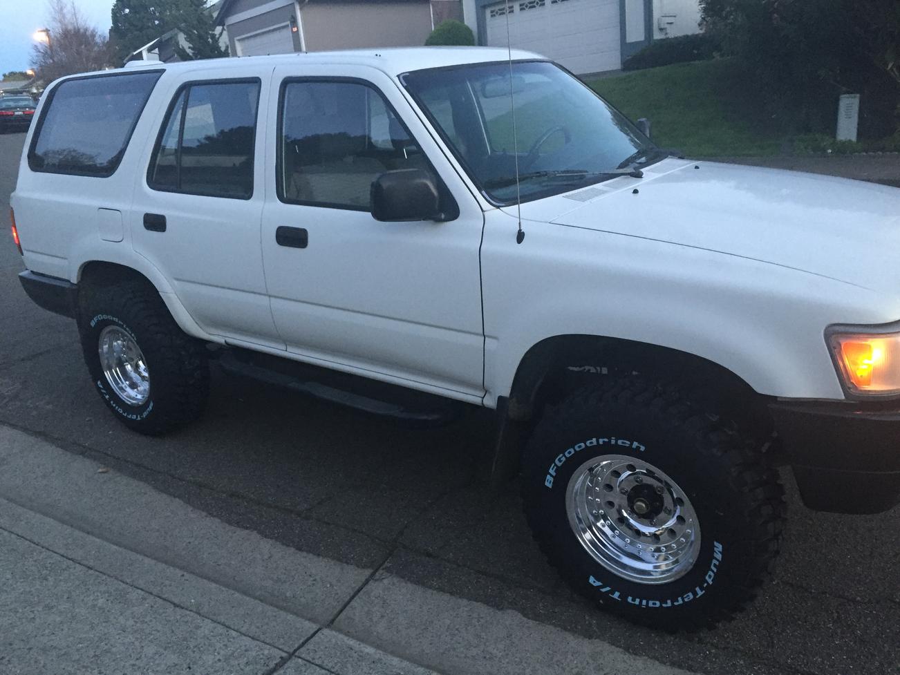

Getting ready to put a OEM tire carrier on my 94 4runner. Anyone know if the 90-91 tailgate will fit on my rig? I wanted to add that tailgate because it has the reverse lights visible and I wont have to modify it. I already got the tire carrier from a 90 4runner for $20 and don't mind paying $60 for a tailgate to save me some headache and time.

The tire carrier was only $19 and the tailgate will be $59. I'm going to be painting the car with primer because it will be a hunting vehicle so color matching color won't be a issue. And the 1/4 panel reinforced with a bracket that that will be custom made (no more than $50) my a local welder. Here's the link to the guy that did the reinforced bracket 4Runner factory swing-away spare tire carrier retrofit. I just picked up this rig so I still have a few things to do before I tackle the tailgate.
