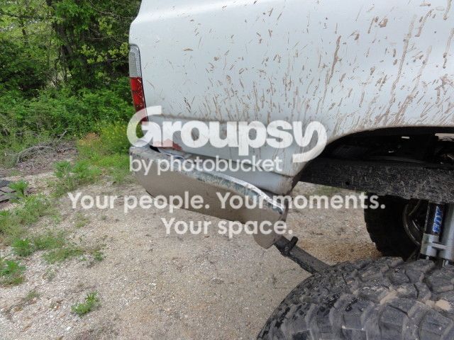

as far as I know top carnage went to me again...

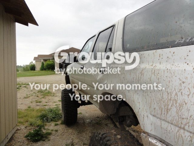

After hitting the hard trails all day, I break on the super smooth camp ground road. Go figure.

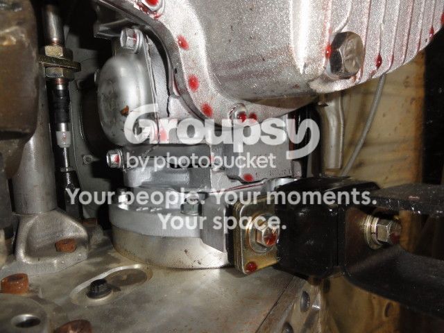

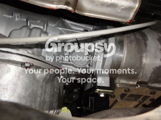

Transmission... again but in the rear this time. Still the housing is trashed. This time the atlas hit the tunnel and bound up the tail housing making it crack. At least i got a full day of wheeling this time.
Have to rebuild the transmission again... but all I have to do is lower the transfercase about 1/2" and everything should be good.

And get a freakin bumper, would you? :D
Yea yea yea, I know the fix for this. I do Need bumpers so why don't you come out and build them.
Irok, I hit a bunch of stuff, I think the t-case doesn't have enough room to move in the tunnel. I guess something has to give.

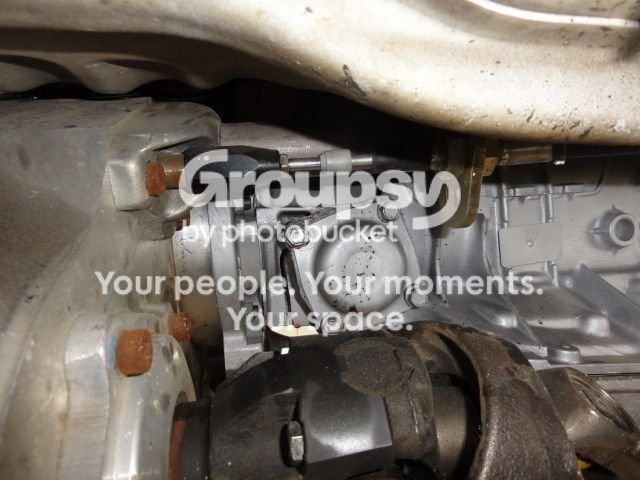

I believe this is the reason I snapped the case this time.
DSC01029.jpg~original

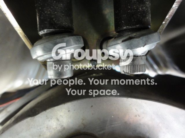

In this picture its hard to tell but it is hitting the shifter housing (blurry shiny spot in the center).
DSC01031.jpg~original

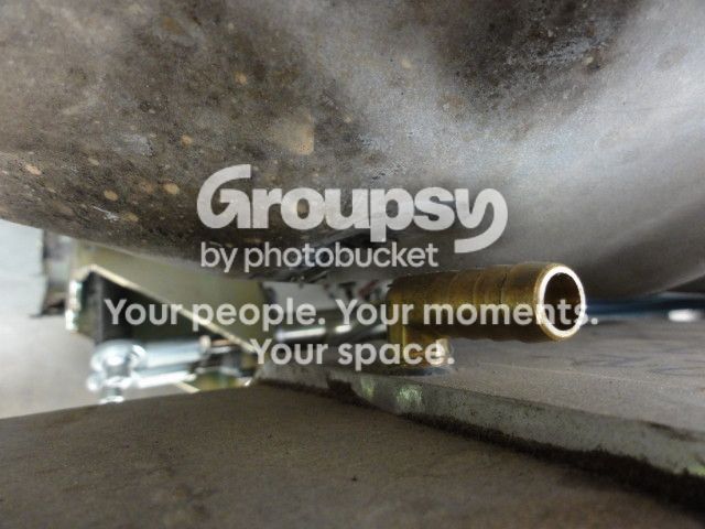

I believe when it is under load and i hit a good bump it contacts.
