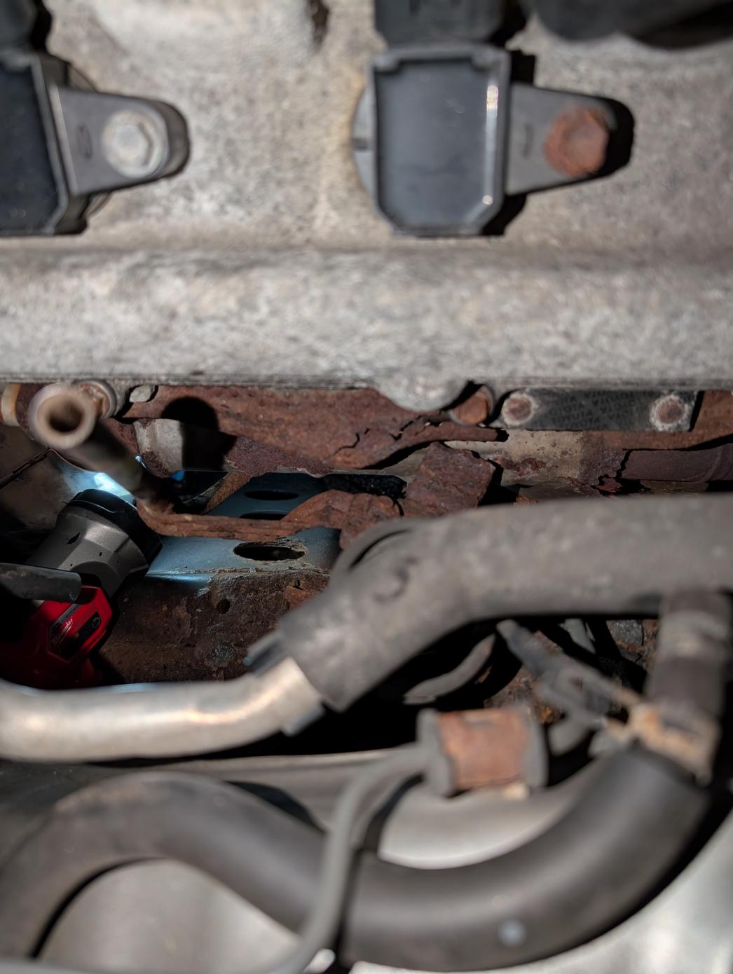

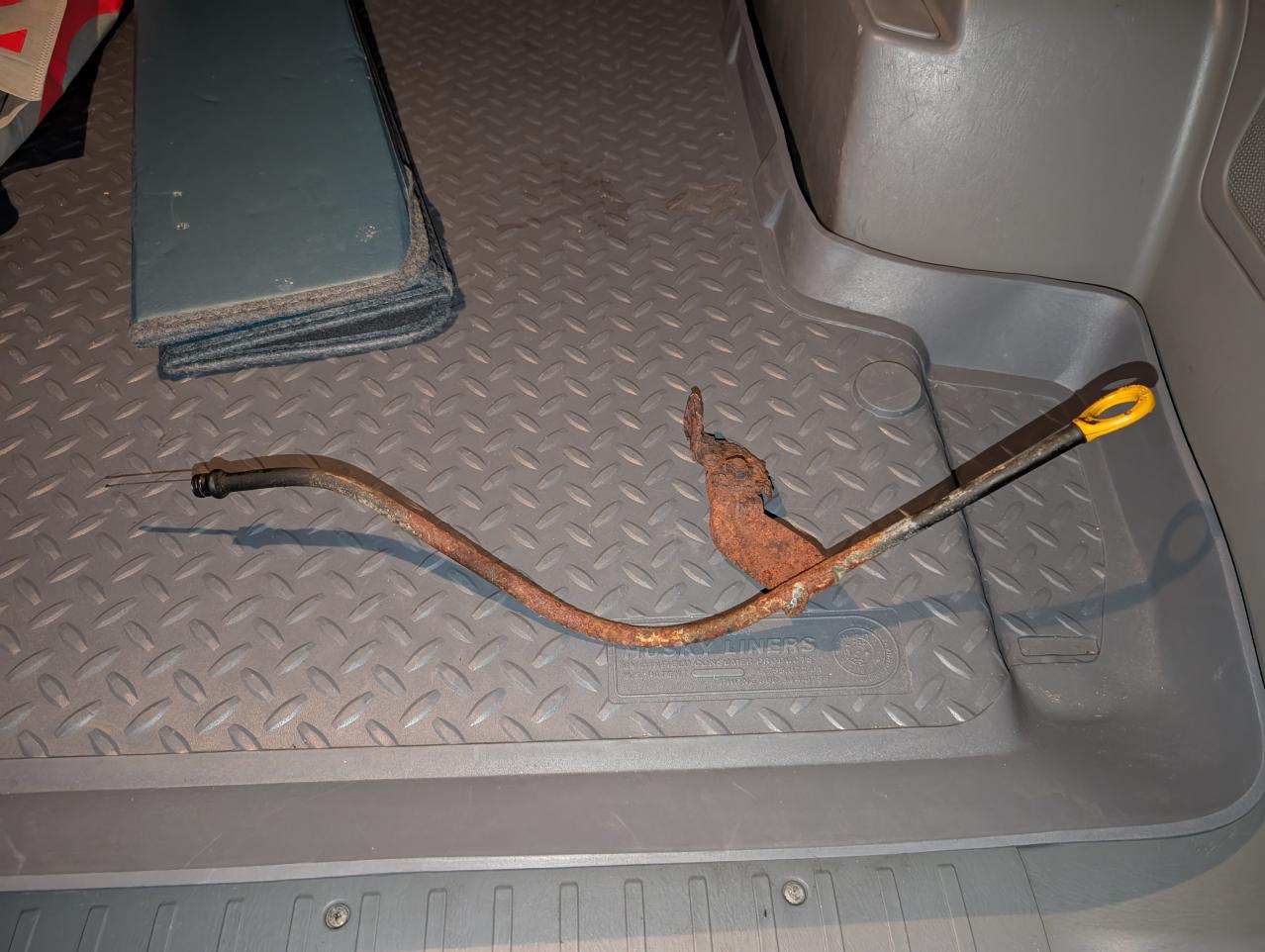

I have a 05 V8 Limited and the entire oil dipstick tube has broken away. It seems the engine block side of the bracket has rusted away and detached from the block. While checking oil today the whole tube came off.
I have a new tube on order, but I don't think that will help me as the location to mount it seems to be missing. Can someone share an image of how or where the engine side mount is supposed to be?

See my post above on a verbal description. Once you get the new tube and get into it I think you'll see how everything goes.
