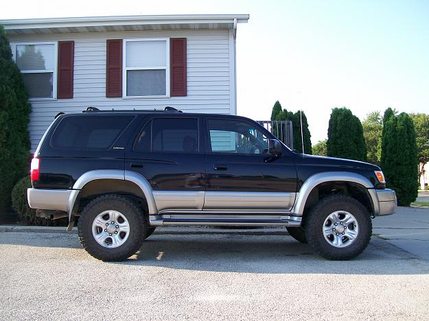

Here's a pic of my '01 lifted 3". I have 265/75/16 Duratracs, and it does alright.

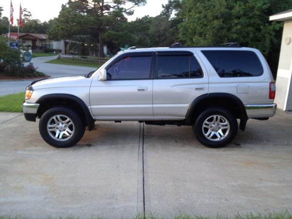

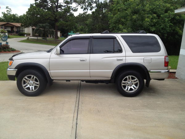

Heres a before and after of my 97 2wd SR5. As JRM said I used 99 tall springs all around. Just chose KYB shocks all around, less expensive than Bilsteins and I am happy with the ride. More clearance and much better for towing my detailing trailer everyday with a 60 gallon H20 tank.

Here's my 97 2wd with 3.5" of lift. Specs are in my signature. I have recently purchased a wrecked 98 4wd with a locker and am in the process of converting mine to 4wd.
Before Lift and 285s...
That gives you about an extra inch right??? And how much did that run ya, if you dont mind me asking?

Got the spring set up from classifieds here for about $75 shipped as I recall. Did it a few years ago. The springs barely had a scuff on them. And end result for me was a little over an inch and a quarter all the way around. But my shocks were stock and pretty dead so that may be why it was over the one inch mark.
