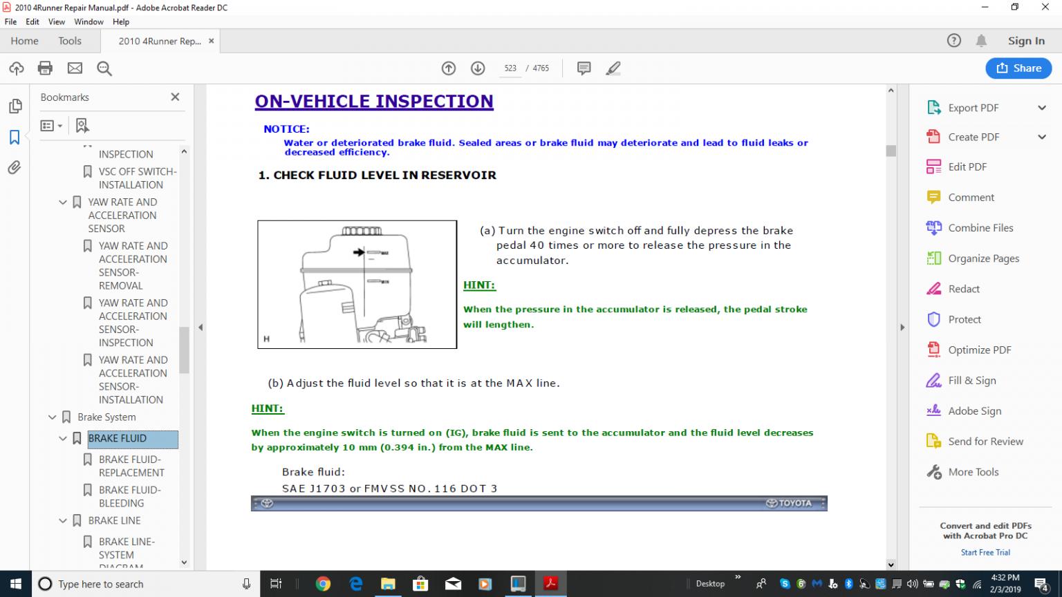

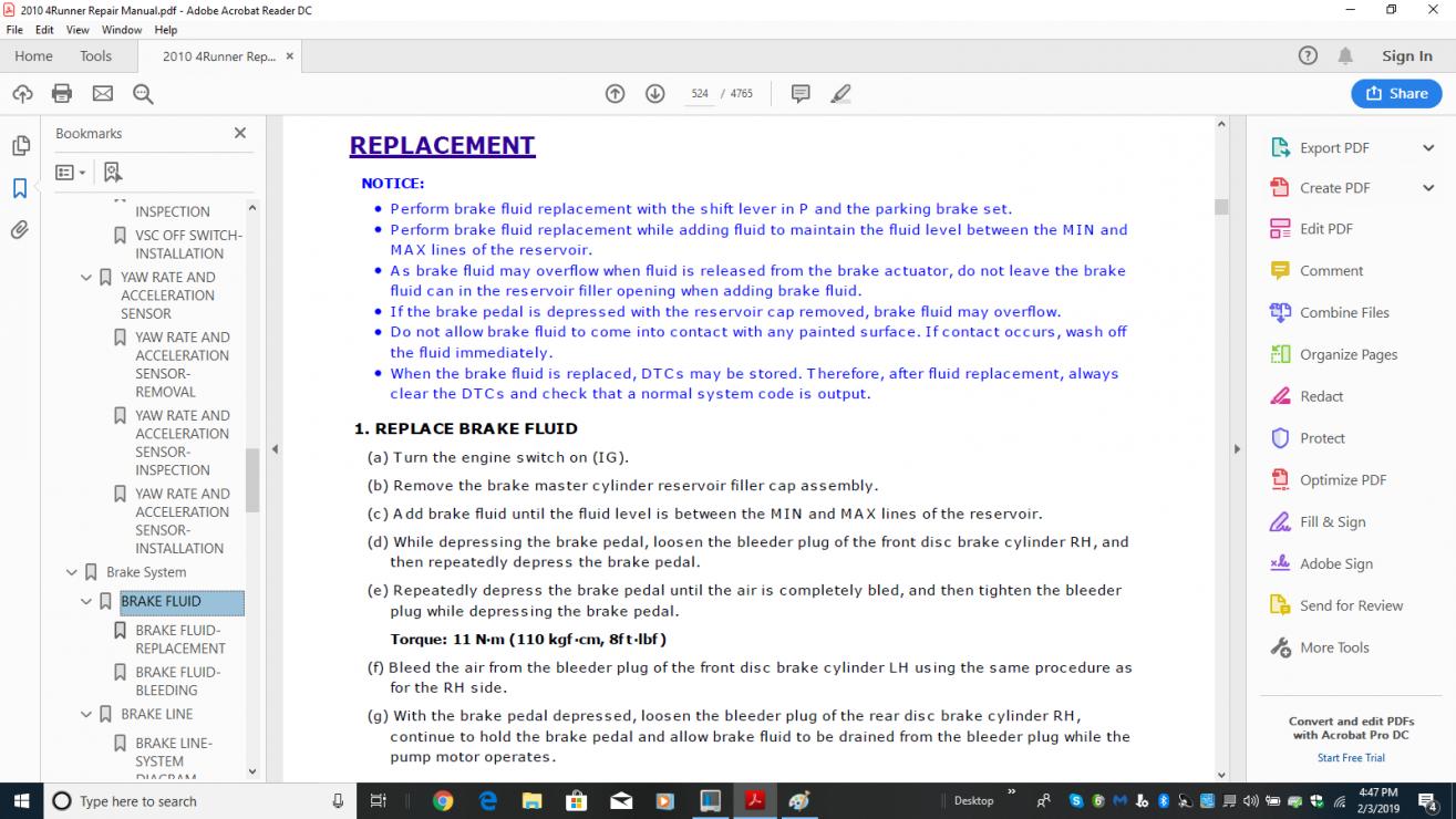

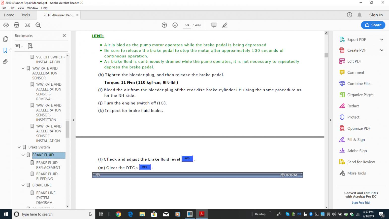

5th Gen 4R Brake Bleed - from 2010 FSM. It is mentioned below about the possibility of DTCs - diagnostic trouble codes - being set during all of this. Certain 2nd Gen Tacoma's use the same electronic vs. vacuum system used by the 5th Gen 4R. Over at Toyota Tacoma Forums - Tacoma World - a member who has this same system told me he's flushed in this manner a number of times and no DTCs were ever set.
