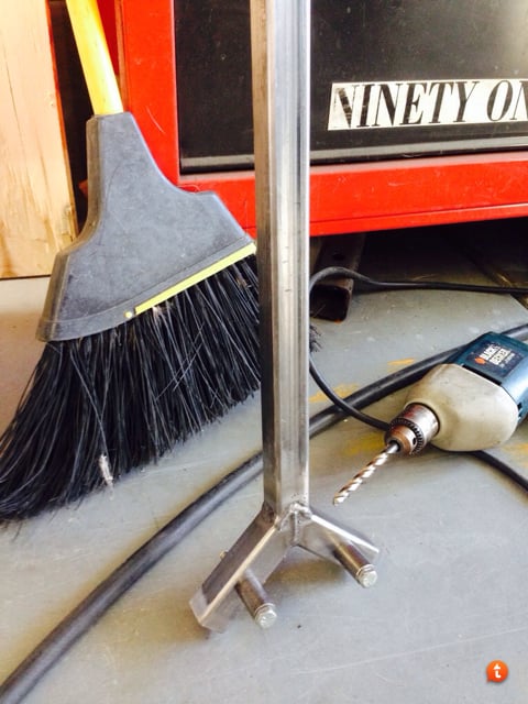

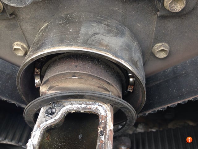

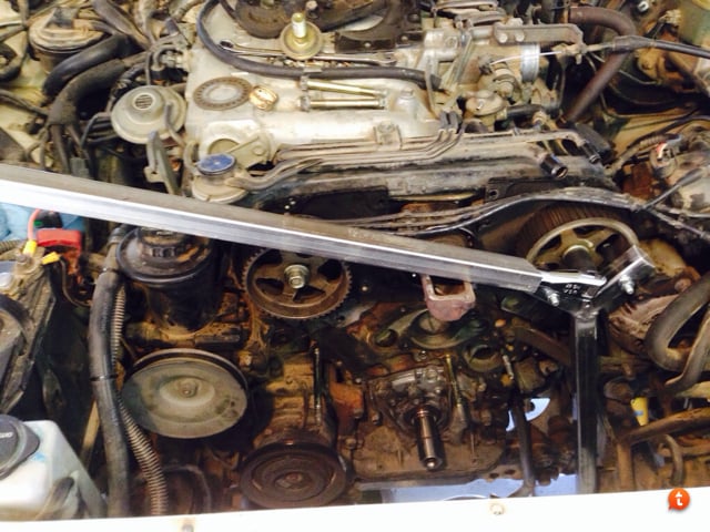

Well I should have been done with this today. I can't get the idler pulley out without removing the cam gears. And I can't break the bolts lose on the cam gears. I made a couple tools to hold the cam gears but I bent both tools. Is there a trick to removing the idler without removing the cam gears?
