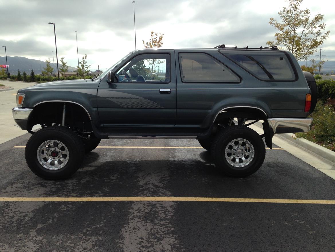

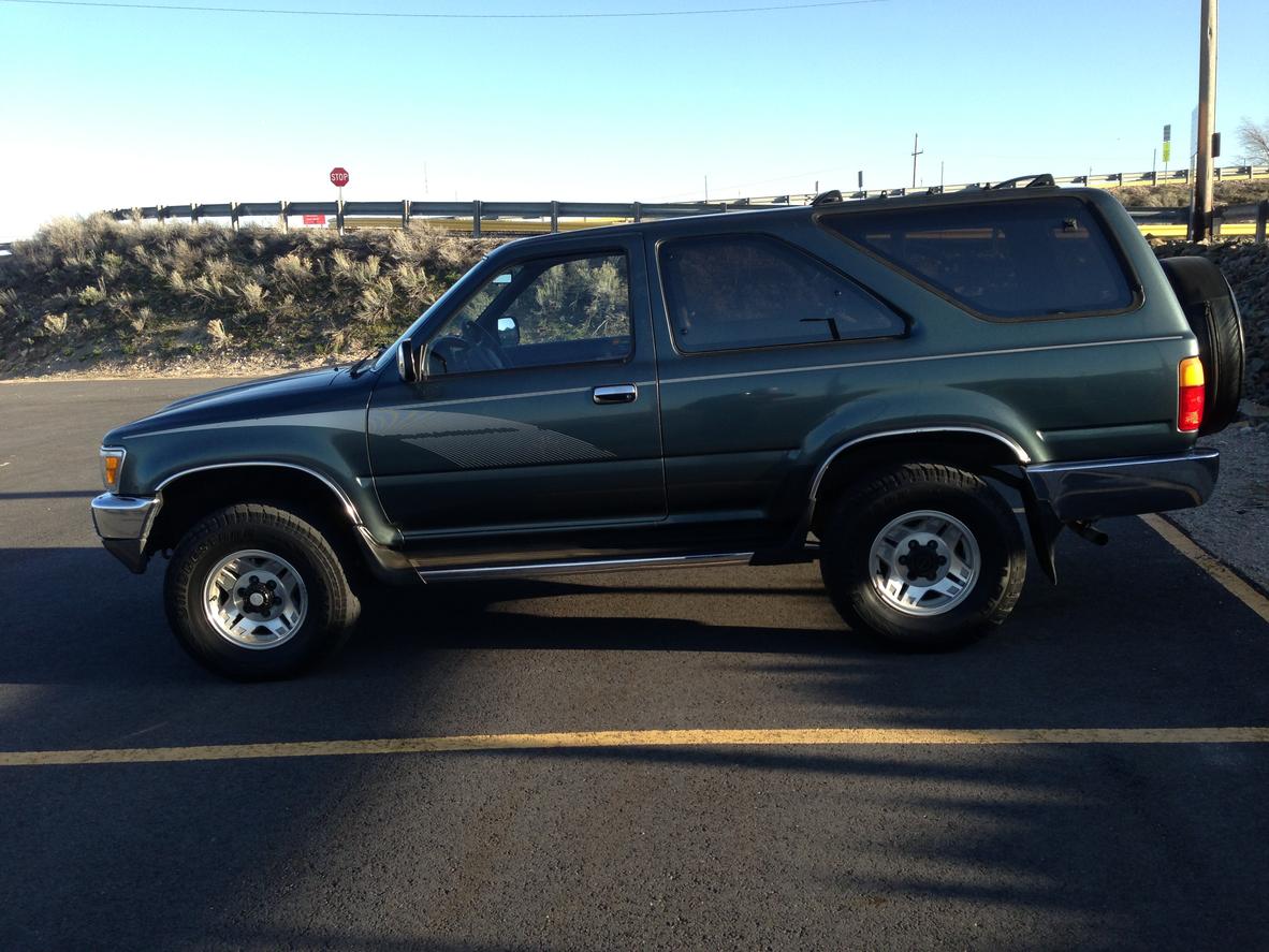

I've taken a few people's advice and visited Locked Off Road in Murray, Utah. Dylan has done a few things to my 1990 2 door 4Runner that make it look way better than stock. I had him install 63 inch springs, a high pinion front diff, a lift for the front with Bilstein's, and just put a new set of wheels & tires on it. The next thing up is the 3.0 to 3.4 swap once I have found a wrecked vehicle as a donor. Things are looking good! Here are the before and after.......

Hey! Was wondering if you were gonna come back and post this. Your (super rare) 2 door came out awesome!

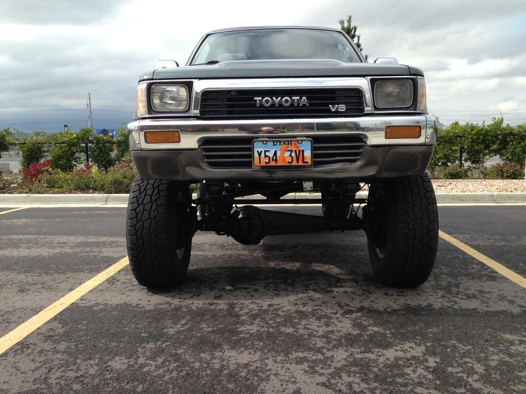

I forgot to add a picture of the straight front axle swap. I also had him change me to 4.88's. I changed the 16 inch wheels & tires to 17 inch wheels with 285 BFGs this past weekend. It's a little tall for me still so I will be having Locked Off Road lower it a few inches since I'm kind of an older fart.

I really like your plans for this truck! It looked super clean stock, Im a little jealous haha. Im not a fan of those chrome wheels and Id lower it just a tad like you mentioned but it looks great! Cant wait to see the 3.4 swap. I was always thinking about doing that swap with the blower on my 94 some day.
