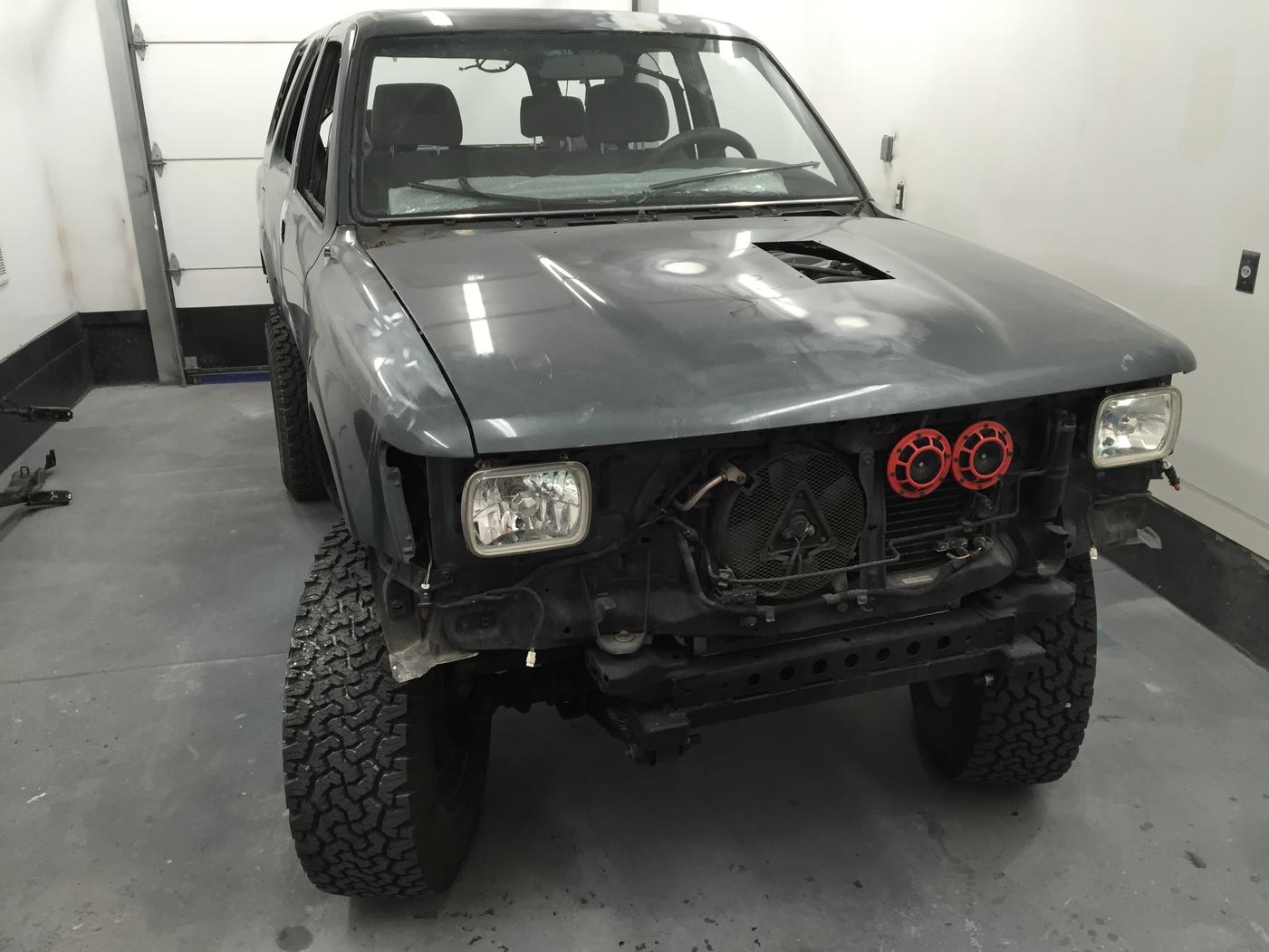

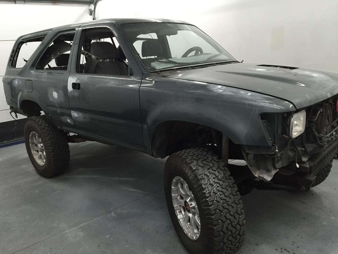

I've almost completed the 1990 2 door 4Runner refurbishing and I can't wait to get it back from the paint shop. It now has a supercharged 3.4 rebuilt by Divinity Auto in Salt Lake and installed by Dylan at Locked Off Road in Murray, Utah. He also done the straight front axle swap, the Alcan springs, the 66 inch rear springs, the high pinion front diff, and some other stuff. I worked with James Dean Graphics in Tucson to etch out the original graphics for a 2 door 4Runner and now he has the pattern for everyone that needs it. The 4Runner is about 2 weeks away from being finished in Bonomo's Paint Shop and looks awesome so far. I'm replacing virtually ALL emblems through OEM parts, powder coating the rear spare tire carrier, the roof rack, the wiper frames and a few other parts. I have found the OEM bumper chrome pieces, aftermarket grill and only the front fender chrome trim pieces but can't find new rear fender chrome pieces (bummer).
The hood is going to come out awesome, I think. I decided to go with a smaller hood scoop off of a Datsun 300ZX and it is a little offset toward the driver side. I'll post a finished picture once it is out of the paint shop. I can't wait to get it out, it is going to be a fun ride.

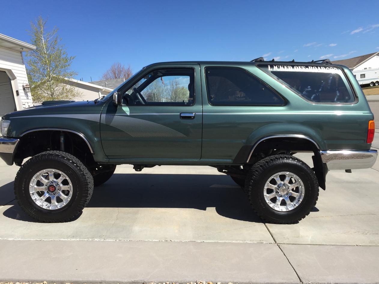

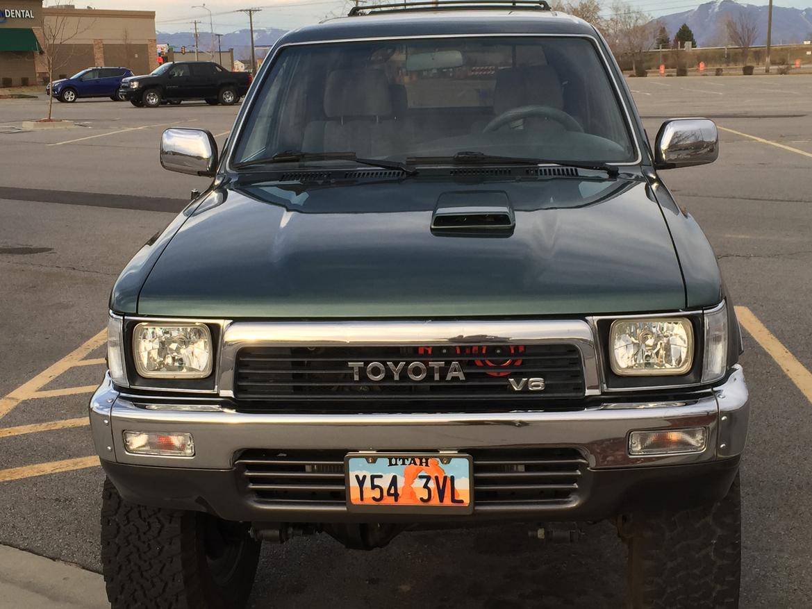

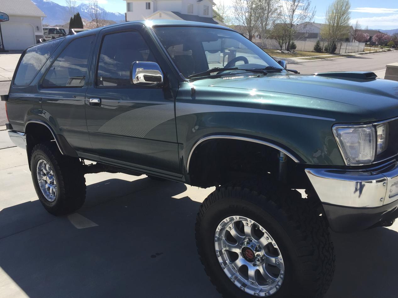

Wow, some time has passed but the rebuild is done. The 3.4 swap with supercharger, all aluminum radiator, K&N air intake, hood scoop from a Datsun 300ZX installed, straight front axle, 66 inch rear springs, high pinion from a Landcruiser, new paint & striping, and tons of other stuff is done. This thing looks awesome!! I'm loving it........
My 1990 2 door 3.4 swap and refurbishing job
Wow, some time has passed but the rebuild is done. The 3.4 swap with supercharger, all aluminum radiator, K&N air intake, hood scoop from a Datsun 300ZX installed, straight front axle, 66 inch rear springs, high pinion from a Landcruiser, new paint & striping, and tons of other stuff is done. This thing looks awesome!! I'm loving it........ check out my album for more pictures.

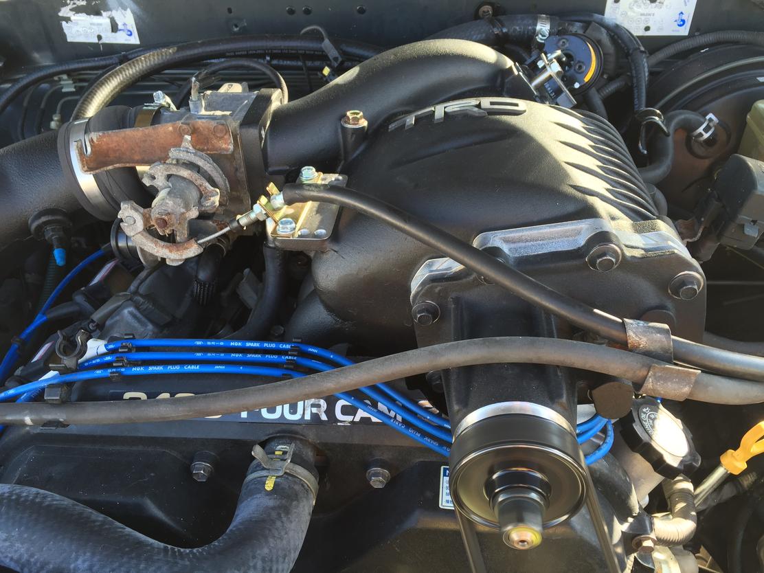

Your 4Runner looks really good. I only have one suggestion, clean up and/or paint that throttle assembly. It sticks out like a sore thumb in a really clean engine bay
Yes, you're right. I plan on cleaning it up because it does stick out badly. I had many parts powder coated so they look great against this dirty little piece. Thanks for the feedback.
