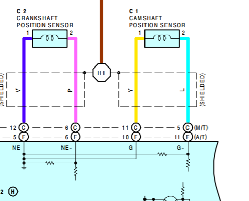

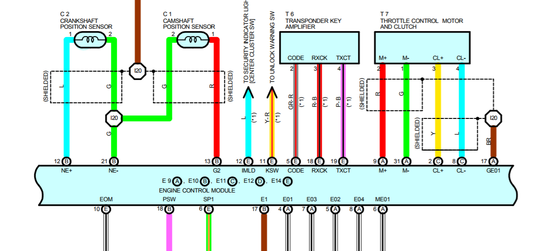

Hey guys haven't seen much in depth threads to do ECM pin out between an 02 Auto and a 97 Manual. So i figured I'd make a thread to post in for suggestions and just for people to check out. First major thing i've come across while looking over the diagram, when looking at the camshaft sensor pins i noticed on the 02 C1 was spliced over and i'm not to sure what to make of this. I've attached pictures of the wiring section that's got me confused.

Haven't seen much, 'cause it's not really possible. That is, without changing engine parts and wiring.
Due to the wanna-be Drive-By-Wire throttle body on the '01/02, the '00 and older won't properly run your engine.
Options are-
1. Use your ECU and have a CEL.
2. Get an '03/04 manual 4WD Tacoma ECU.
