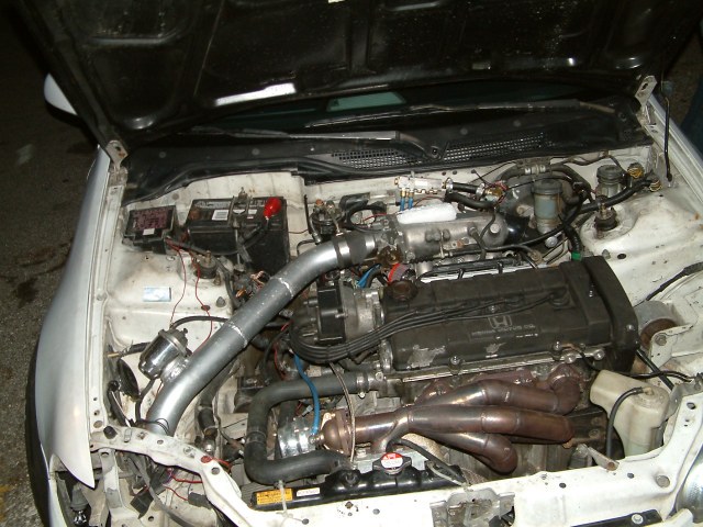

this one is ours, b18b LS motor, t3/t4 turbo, in a 93 civic hatch
