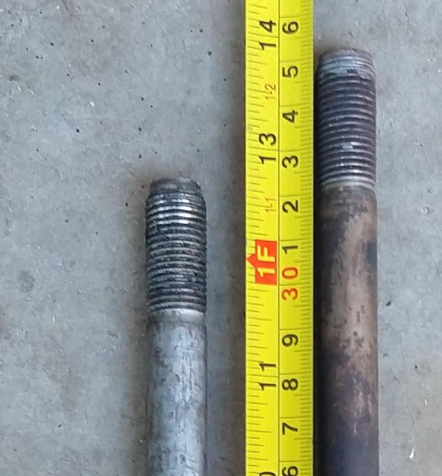

Hey folks do you know the length of UCA bolt for 98 4runner?
I have a BCC UCAs which are Total Chaos replica if I understand it correctly. and driver-side bolt is bent. According to the manufacturer stock bolt should be used, however, the one I got from the Toyota dealer is roughly a nut length too short so I wonder if they gave me the wrong bolt?
I've called a few dealers but they don't know the dimensions and don't have them in stock to measure.

The one I got from Toyota is exactly the same. But the ones I have now seems to be longer (hard to measure on without removing the bolt) and threads stick out by slightly over an inch. Interesting

I've pulled one bolt today and it's 3 cm longer than the one from the dealer.
322 mm vs 352 mm
it's still very confusing because total chaos insists that the stock bolt should be used.
