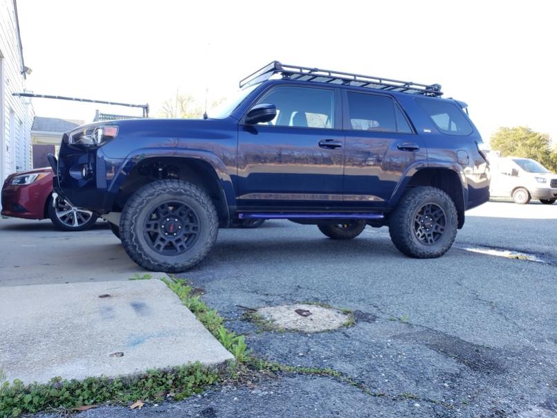

I recently put a Dobinsons 3" lift on my truck with long travel in the rear.
They have various height and weight options.
