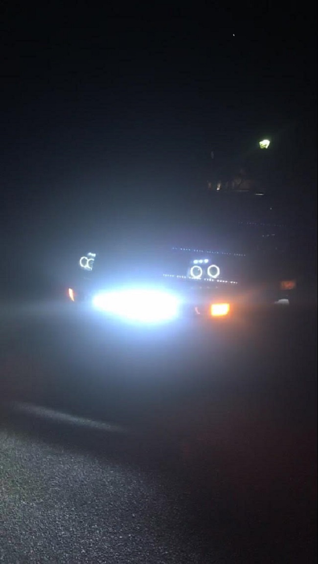

For the record, here's what the light output from my HID retrofit looks like. This is the low-beam setting. Flip on the high-beams and the sharp cutoff disappears as the bi-xenon solenoid flips the lid behind the projector lens open. Everything gets lit up. Then add on the additional light coming from the stock high-beam bulbs (effectively quad high-beams). Not a cheap mod, not easy to do, but worth every penny.

It's aimed a little high right now. You're right though, a lot of light right in front so "ideally" it would be mounted higher, but I'm pretty happy with how it turned out. I'll know more once I have time to get out in the open and get it aimed properly.

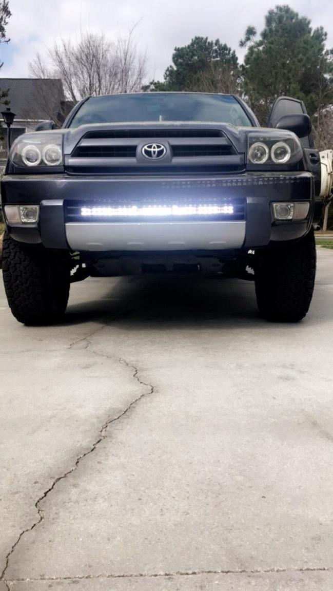

I completed this mod!
I got a 31", 180W light-bar for $36 off of Amazon.

i installed mine woth two 6" L brackets from home depot. i cut one end short by an inch. bolt through existing hole on frame and drilled and screw a selft tapping screw on to the second hole. i cut out the plastic grill and it sits flush with the remaining black frame.
