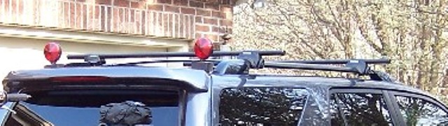

Not on a stock rack but on my Yack rack. No problem. Use some type of motorcycle ty down with the cam or ratchet. One in the front and one in the back. I am a geek so I will use as many as I have so three is better.

So you're suggesting the factory crossbars are the weak link? My main worry is that I can get only a maximum of only 4-feet between the two crossbars on the roof, which means there will be a 6-ft overhang at each end. Looks like that would be no different with the yakima crossbars.
The ladder's stiff, so that might not be a problem. Then again, gravity on a 6-ft overhang is fairly substantial.
The factory bars should be fine for this load. The problem is that you only have 4 feet to support this 16 foot ladder. My recommendation would be add a support that you can tie into the grill or on the front bumper that can support the front of the ladder. Many canoe/kayak shops should have something that can help. Or you can add a back support (like the one below) and add some foam blocks on the front edge of the roof and a tie down up on the front edge of the hood.
