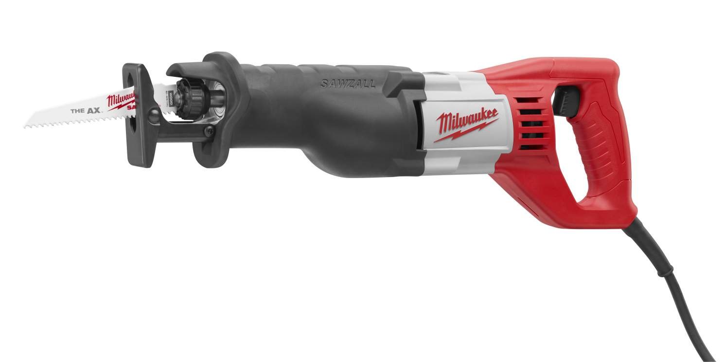

I have 265/75 r16 Duratracs. When I got them put on everything was bone stock and there was no rubbing at all. Then I got 1.25" spacers and there is some moderate rubbing on the bottom corners of the wheel well. Ill be fixing that with a sawzall when I get back on land. O and I am very impressed with every aspect of the tires. Highly recommend
