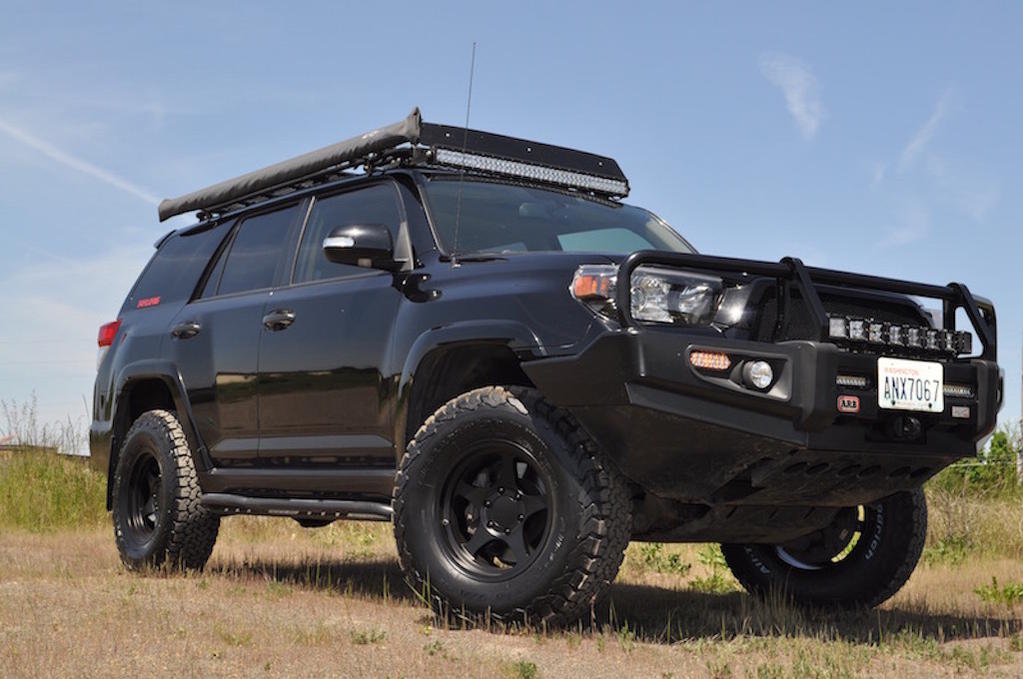

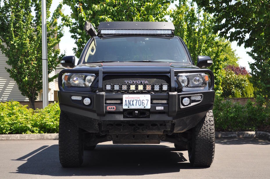

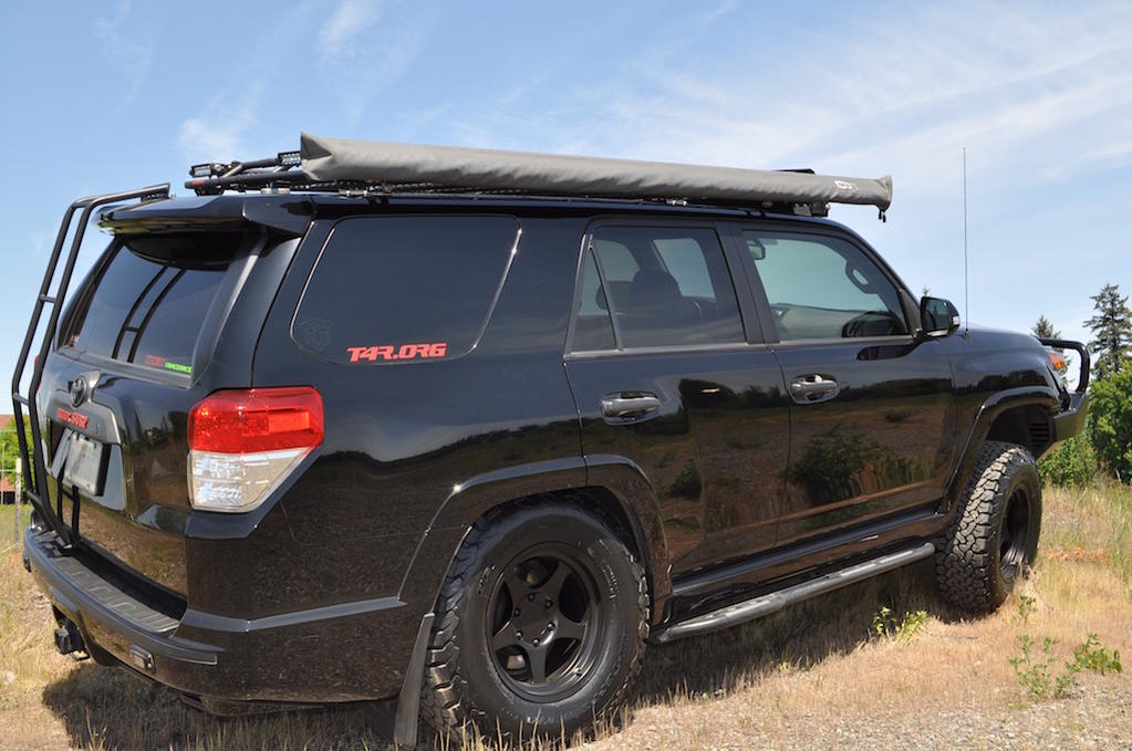

BFG 34x10.5R17 KO2s mounted on [MENTION=85422]FNWheels[/MENTION] 17x8.5 Five Stars Matte Black
They tuck nicely without the wheel spacers. They would probably tuck with wheel spacers also.
Even though they are "10.5" wide, they don't look that skinny.

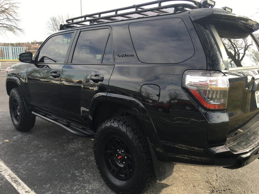

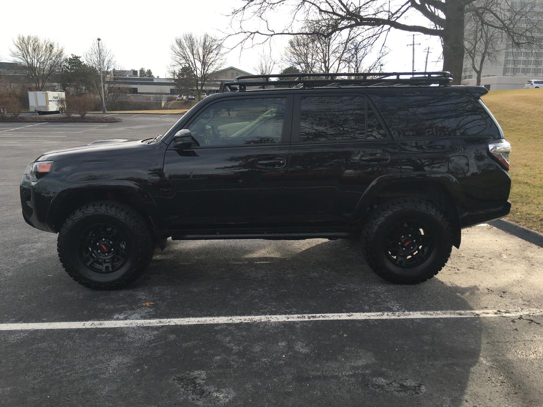

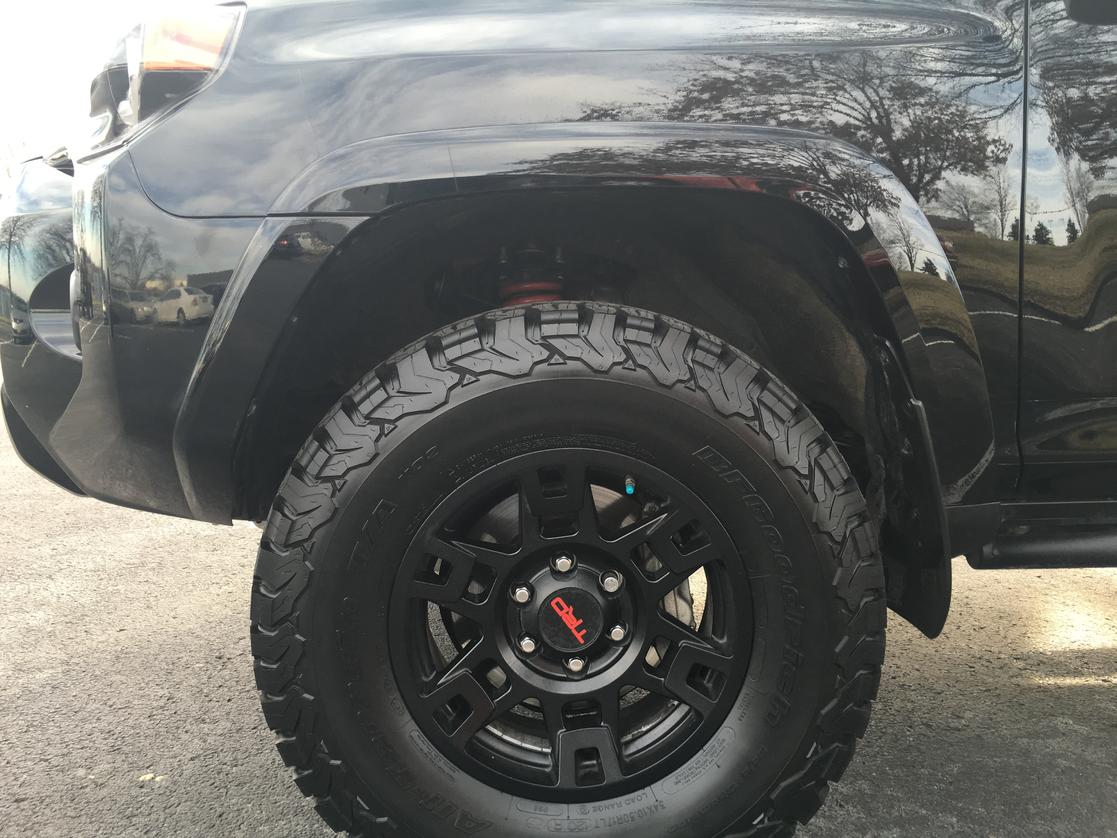

BFG KO2's 34X10.5 R17 and Toytec FJ4RPro Lift
Just had the 34's mounted and lift installed on Monday. Not crazy about the rake, but its settling down now. The tires are great. No rubbing of any kind and they don't even make the truck seem that sluggish. Anyone running these have some advice on tire pressure?
