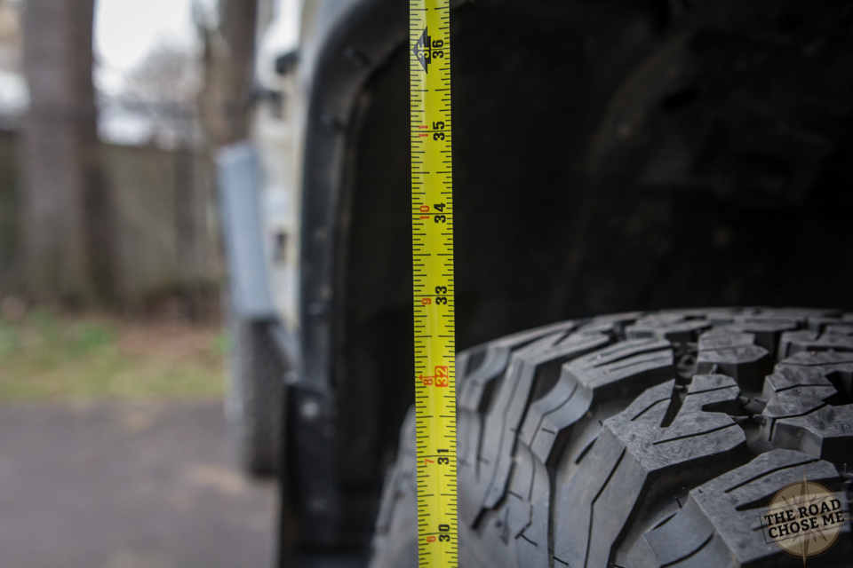

Actual ride height with 40-45psi and all the equipment I'm running is about 32.5"-33" front and rear respectively. Keep in mind I'm weighing in at 5680lbs as it sits.
Thanks! I was thinking they might ride in that neighborhood. I weigh in similarly and my 285's sit at about 32.5". I was hoping to pick up some clearance versus my current setup and that doesn't sound like it would do it. I will probably go with 285/75's considering this. Thanks again

Most of the reports i've seem from people with the 34s mounted, show them around 32.25" tall. BFG tires do seem to measure small. Below is a 34 next to a 255/80 17, the 255 is listed by BFG as actually being .2" short than the 34" tire (33.3" vs 33.5").

Not sure how you are measuring. Definitely over 33" diameter. I would say 33.5 is pretty accurate for that tire.
Maybe unloaded and unmounted? I dunno. I've never measured one, just going by what i've read elsewhere.

285/75/17 will be larger than the bfg "34s". I run these and you will for sure need a BMC and 3/2 lift. Great tire size though.

I have the KO2s in 285/75/17. They are definitely bigger and wider than the KO2 34s. I only have 1.5 f and 1 inch r cornfed lift spacers for my TRDP. They clear fine without doing a BMC. I removed the front mud guards, pushed in the front liners, and trimmed a little on the driver side bottom wheel well with a box cutter. Just stuff that you can easily do. I cannot say if this set up will work when off roading. But if you are mainly driving on city and highway, you would not have any issues at all. The KO2s run small, so therefor they are lighter than other tires. 285/75s KO2s measure 33.9 inch in diameter and about 32.75 when installed.
