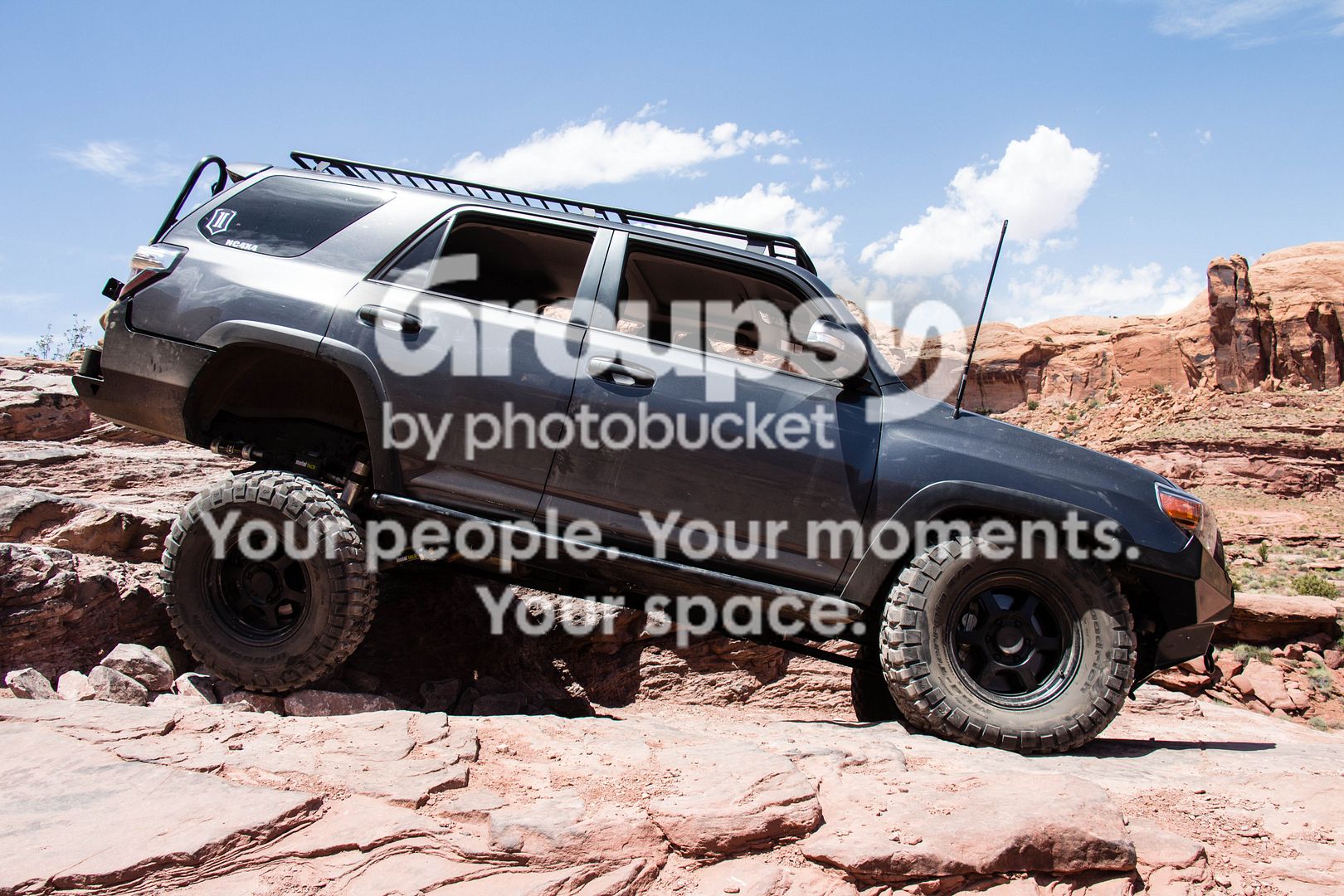

Metaltech ran them when they had their truck. I run 34s and post heavy trimming and once I do a little more rear bumper modification, I probably could run 35s. You may want to look at 34s though because they are only .5" shorter but you can get them narrow enough they cause less fender rubbing and cans pretty much fully stuff and still turn.

For my setup. 17x8 0 offset rims with 285 70 17 Duratracs (33s). 3" lift with aftermarket UCAs. I only had to push the fender liner forward to eliminate all rubbing. But, I hear of others with very similar setups requiring the front body mount to be chopped. So, each truck and setup must be slightly different. I think this is the main reason why the information is so vague. It's a game of mm.
285/70/17 on 17x9 -12 4.5" bs, +4 caster, total chaos uppers and lowers. Had to do the fender liner mod and trim my mud flaps in front of the body mount. I run Goodyear MTR's and rub slightly on the body mount at full lock and full stuff.

Always thought bfg's ran smaller. I got 3" lift 285 bfg total chaos uppers set to caster +4 and have 0 rubbing and didn't have to do any cutting or fender mod or lose the mud flaps
Depends on which BFG tires. It varies by model. KOs do seem small but KM2 and KM are a little bigger. Also load range makes a difference.
I run a 275/65/20 TA/KO which is a 34.1 / it's big and took a lot of cutting but I am rub free finally. Caster at 4.2 - Radflo Lift - TC UCA's.
Even 34s require a full court press - lift, bumper, UCAs, good caster dialed in, body mount cut, pinch weld cut/hammer, lots of plastic cutting. I would say 35s on something that wheels is going to require (in addition to the above) extended bump stops, body lift, or one of the 6" Taco/FJ lifts that require cutting out and replacing a crossmember.
