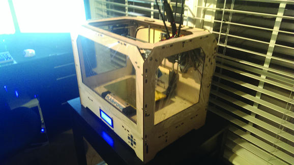

So, this is the device I will be using to do all of the prototyping for this project. As you can see, it has some size limitations (about 7x5x5 inches) on the parts it can build.

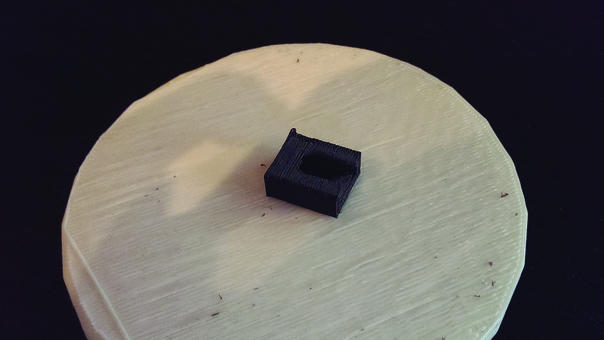

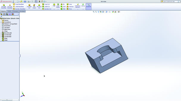

Firstly, I chose to design the mounts for all of the OEM grille bolts. An easy and small part to design, but also extremely important. Also, I would like to point out that I am modeling in SolidWorks.

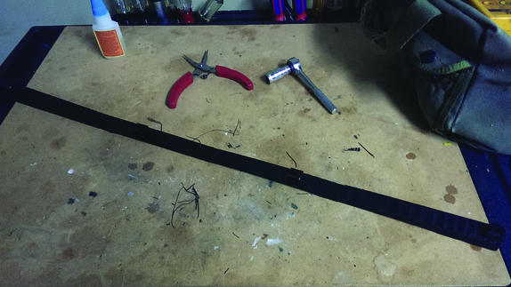

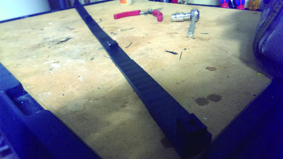

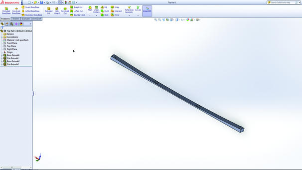

Now with the mounting blocks dealt with, I took measurements of the top mounting holes on the hood of my T4R. Right now, I'm focused on getting correct alignment for the mounts, so I only measured the distance between the holes and their relative offsets (because the grille has a slight convex shape to it). I printed my design in four pieces, and glued them all together (along with four mounting blocks)
Note: This part was not intended to sit flush with the hood at this point, as it is just for testing mount alignment.
