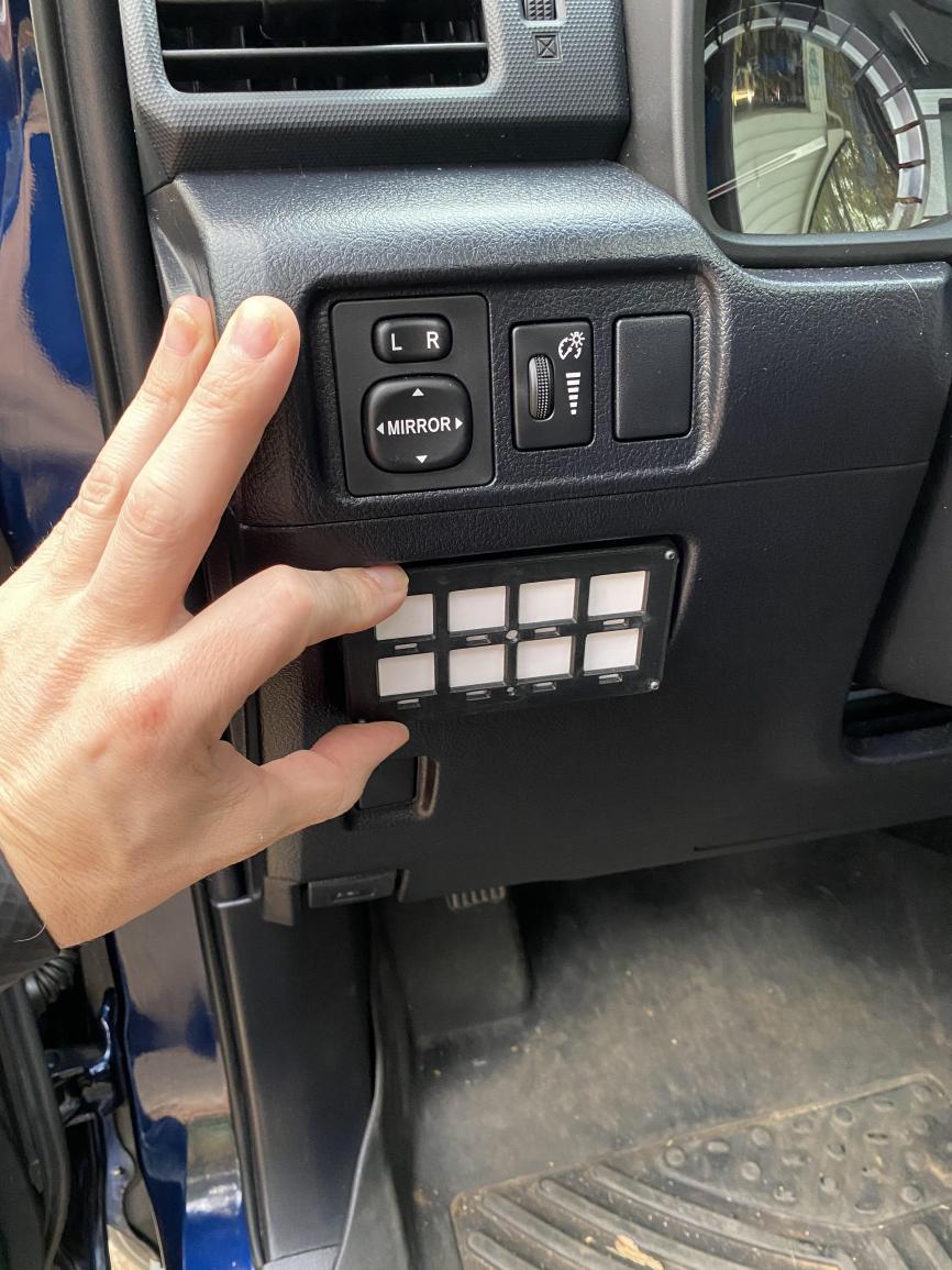

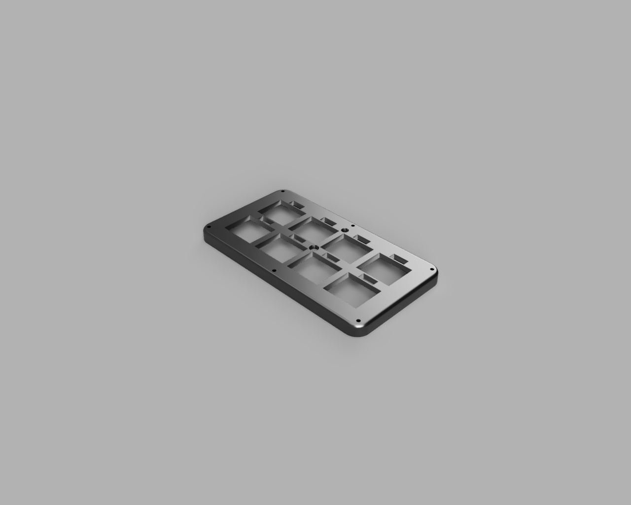

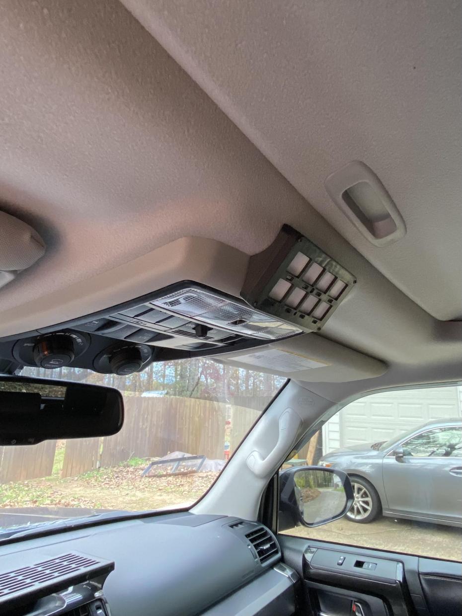

Switch Panels:

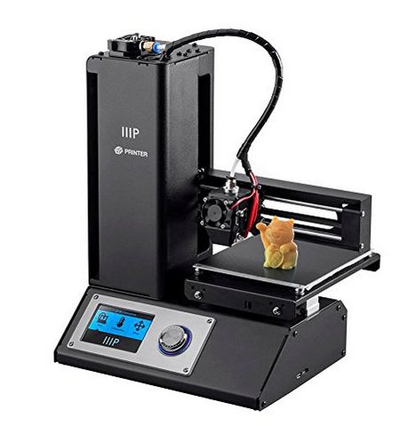

A good beginner 3D printer that is ready to go out of the box is the Monoprice mini Select Ver II
It's low priced and it is setup and pre-configured at the factory to it's almost ready to use. Just get yourself a couple of spools of filament and print.
As far as creating Tinkercad is a web based 3D building program that is easy to use and works pretty well. You have to think of a different way of building things. You use shapes like squares, ovals, triangles etc. to build then join them together. You can use negative shapes to take away space. The order you combine them will determine the final shape.
Then you export the file into a STL file. This is the 3D file.
Next you have to convert it into a gcode file that your particular printer can understand. Cura and Repetier are the most common. Once configured for your printer it will slice the STL file into layers that the printer can understand and save it as a gcode file.

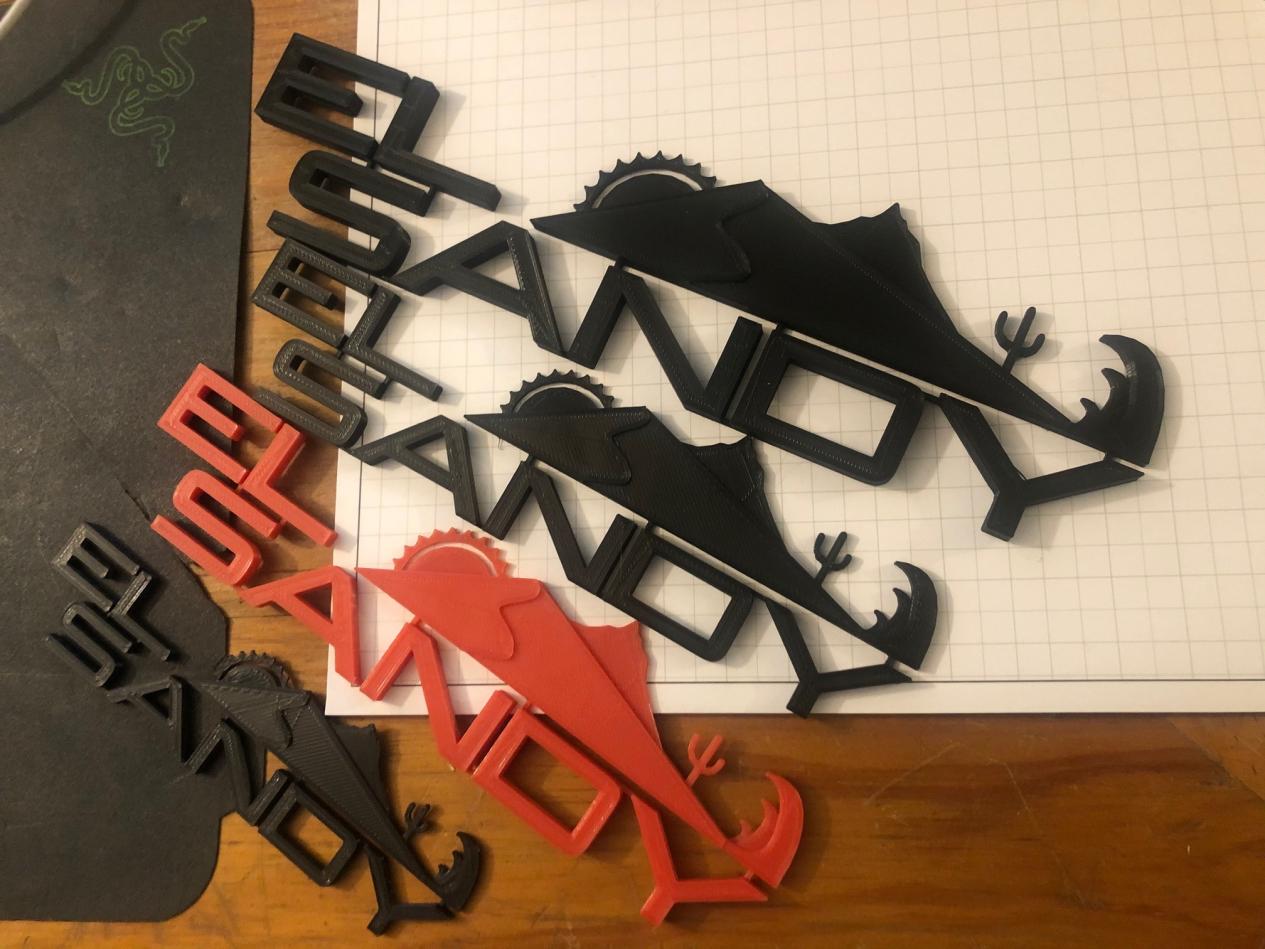

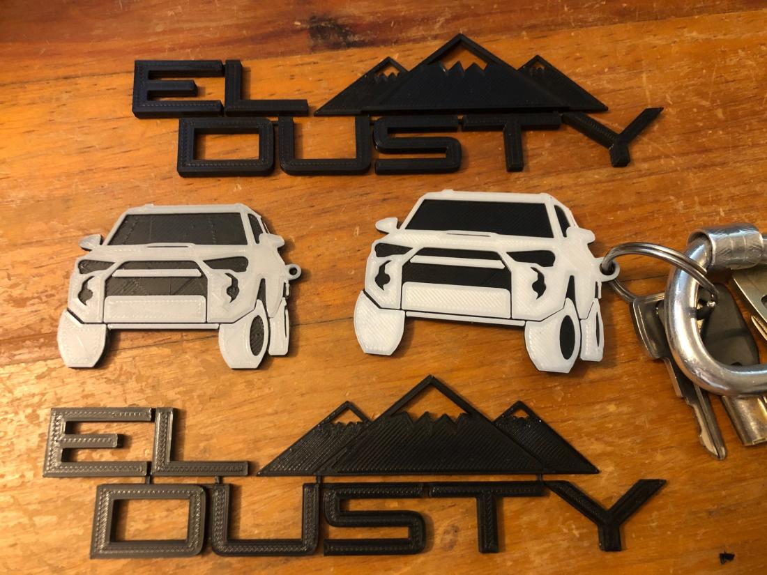

Have had my printer a little over a week and after getting it dialed in I finally designed a few of my own pieces. If anyone wants files shoot me a message.
Keychain was originally designed to be double sided but had adhesion/support issues with such a thin print and multiple filament swaps so for now they remain just one sided.
For badges I used a text file called Aggie Normal Regular to mimic the TRD font. Running it in Bold help print just right IMO.
Have a background in steel and tower design so Im Running Solidworks to generate .stl. Used cura to slice and printed on an Ender 3 Pro that still has some kinks to work out. So far really impressed with the machine but adhesion is still a mystery to me...

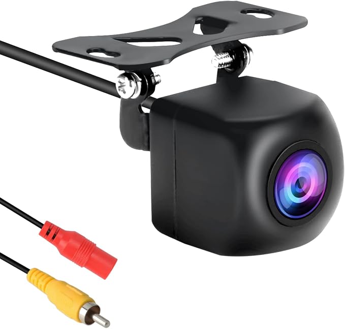

i'm hoping someone makes camera mount that lets you use a aftermarket camera in oe slot..
