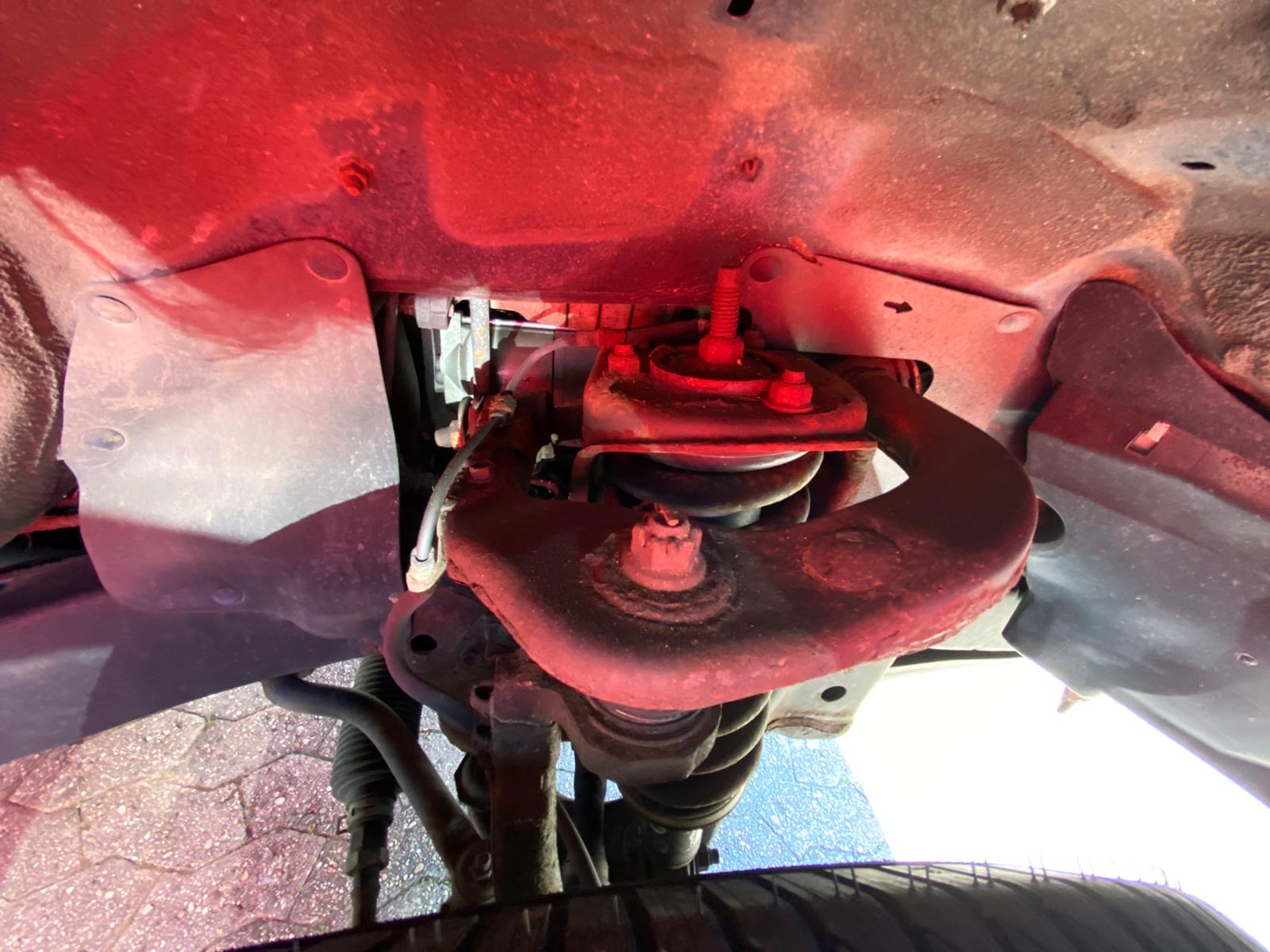

Can you please confirm that what I found on one of the pictures from a salesman is a milkshake issue that someone apparently tried to hide with red paint? From what I read here this means the transmission is broken. Does it even make sense to try to replace it or should I definitely walk away and leave this car alone?
The thing is that I live in Europe and it is extremely difficult to find a healthy 3rd gen 4runner here. Other than that it is in really good condition and everything about the car works (including the clock ) Should I even bother trying to find the transmission? The car is 900 miles away, I wanted to go to see the car until I found this.

That red paint has nothing to do with the strawberry milkshake. Strawberry milkshake is when coolant and transmission fluid mix due to a failed transmission cooler in the radiator. This causes the transmission fluid to be milky, redish, and kinda foamy (kinda feels like glue too). I have no clue why someone would use red spray paint on the suspension. Maybe a rust repair and the guy didn't have black spray paint? Who knows!

Thanks for answering, I think I didn't express myself correctly. This forum is an amazing source of information and I read carefully what strawberry milkshake is. My bet is that the red paint was put there to distract from the actual milkshake that can be seen on the left-hand side. It's harder to recognize pinkish spots on the sides when there's a huge red spot in the middle.
So my questions would be:
1) can you confirm that what the pinkish spots that can be seen on the left-hand side is a milkshake thing?
2) taking into consideration this model in good condition is extremely rare where I live and the rest of the car is in good shape, does it make sense to look for transmission? If so, can you recommend where I can buy one in good condition?
thanks!

To check for the strawberry milkshake you need to look at the transmission fluid and coolant. That is the only way to check if it has that problem currently.

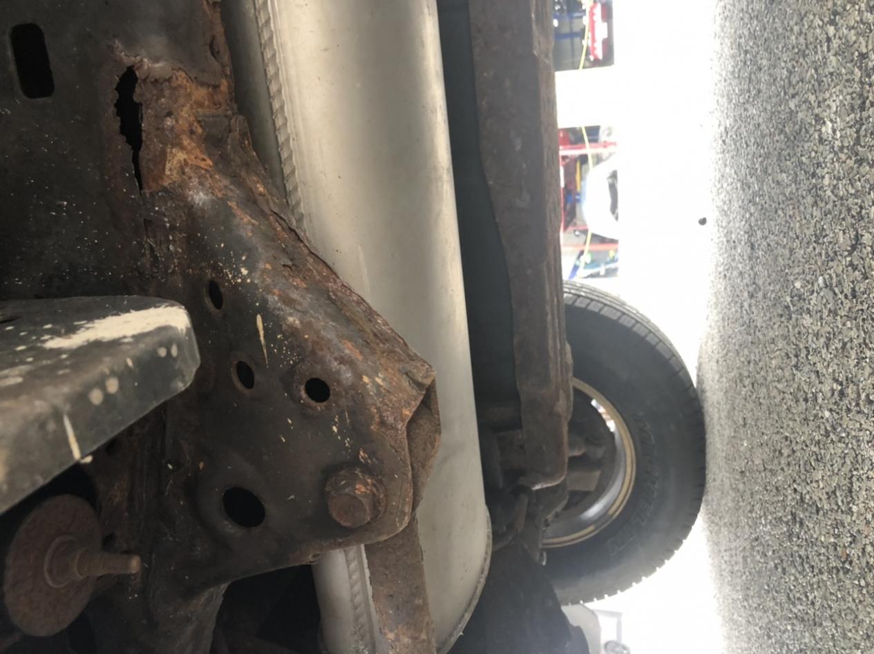

I’m looking a 2001 and really only thing that I’m seeing wrong with it is the rear control arm where it connects to the frame is rusted through on one side. Is this something that can be fixed? TIA
I would run away from that mess. Or have a mechanic inspect it.
Sent from my PH-1 using Tapatalk
It can be fixed. I once saw I guy do a trail fix on his control arm after it broke. He had his welder fix it on the trail. The question is where is the vehicle rusted elsewhere? I'm sure that isn't the only major rust on that beast
That's probably the most common place for the frames to be rusted through. I would be wary, but I, like many others, am spoiled by the desert southwest lack of rust.
It can definitely be fixed. I remember some time ago that someone sold a patch kit. I would definitely check the rest of the frame and rear axle with a fine tooth comb. The rear axle gets pinhole leaks often. For a 20ish year old vehicle I think you'll be lucky to find a rust free one, unless you have one shipped from someplace without rust. Good luck with whatever you find!

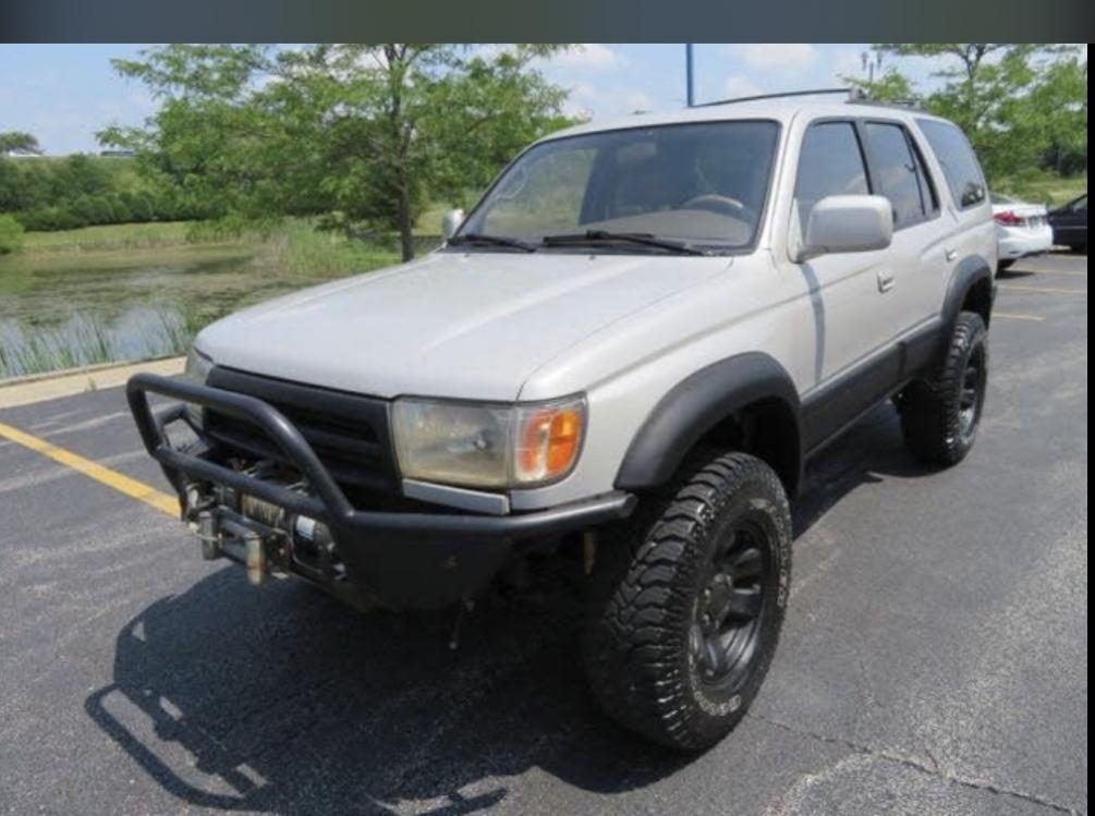

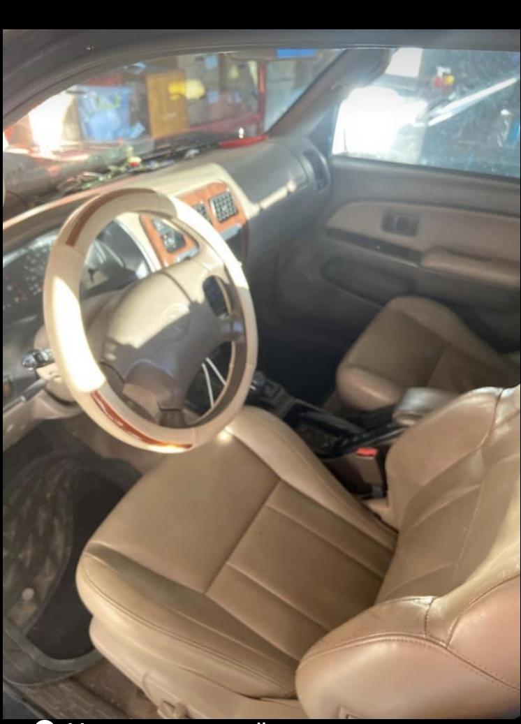

Hey guys, new to the forums. Found this 1998 4runner Limited. Its got 267,000 miles. No tears in seats, newly upholstered drivers seat. All the windows and locks work. Everything looks great, light surface rust underneath. I'm waiting for the seller to send me the list of dealer upgraded parts. It looks like original lower ball joints and factory radiator. I also saw grime build-up from the valve cover. Seller reports no transmission problems, but I'm prepared to replace the radiator if I decide to buy. My question being, is $5000 a good deal? He originally had it for 6,000 but I'm sure he wants to get rid of it now as its been on the market for a while. It also comes with a rod rack. Thanks for any help, I greatly appreciate it. (sorry for HUGE pictures) Also timing belt replaced at 220,000 miles.
