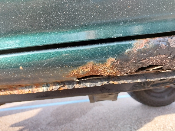

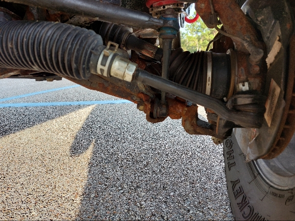

I need some opinions.

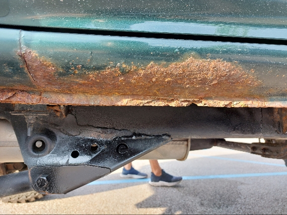

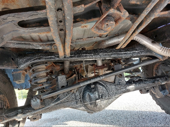

I am looking at a 2000 SR5 4x4 with 212,000 miles on it. It has a 3inch lift (Toytec front/ Bilstien rear) coastal custom pumper... good looking build.
But the AC is out and the ABS "needs a new motherboard". It also has rust on the rocker panels and some on the frame.
Is this worth pursuing and what would be a reasonable price?

Pass, IMO
Junky repairs on lower link and a F-ton of rust

HARD pass. That body is totally rotted on the inside. The fact that they couldn't be bothered to clean the rust off the frame and just threw paint over it is another real nice touch.
If only they put half the time and energy into taking care of their car as they did buying+installing new aftermarket parts...

Is this rig a southern truck or from the north? As those rockers are very rotted for the south. I would imagine the frame has some thin spots on it as lots of times the when rockers are gone or heavily rusted so sections of the frame.
Would be normal or ok condition for rust belt but not for the south. I say you may want to pass on that one. :)

It's from the salt belt. But is in the south now.
I agree, Im going to pass. The owner was a very nice guy. But unfortunately he didn't get ahead of the rust.
I appreciate the feedback.

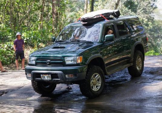

SR5 HIGHLANDER (Sport)
-This trim model was available from 1999 to 2000. It was never officially 'badged' as the highlander, the only place it actually says highlander is on the original window sticker. Most people simply call these Sport 4runners.
-Notable features include the standard Hood Scoop, black or wood grain interior trim pieces, cloth sport seats, color-keyed bumpers, fender flares (black SR5 flares in ’99, color-keyed limited flares in ’00), Limited '5-star' wheels, roof rack, fog lights, Larger brakes, Optional 5-speed manual transmission and optional Rear electronic locking differential. It is very common to find these with the e-locker option, but not a guarantee.
-4.10:1 diff gear ratio without elocker, 4.30:1 with elocker. (usually)
-Highlander models with the rare combination of 4x4, 5-speed, and E-locker are commonly regarded as the most ‘off-road capable' of all 3rd gen 4runners, and are very desirable.
Colors:
The highlander trim model was available in Imperial Jade Mica green and Black. In 2000, this package was additionally available in Millennium Silver.
-In 2001 the ‘Highlander’ package was removed from 4Runners and made into a completely new vehicle. The all new Toyota Highlander. The new Toyota highlander was a unibody, car-based SUV compared to the 4runner’s rugged body-on-frame design.
Resource: Toyota 4Runner Highlander Information
Photo courtesy of [MENTION=120445]genmarks[/MENTION]

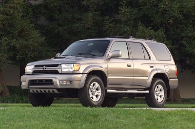

SR5 - SPORT EDITION:
-Available from 2001-2002, the Sport is the continuation of the highlander package. In 2001 it was known as the ‘Sport Package’ and in 2002 it was finally badged as the ‘Sport Edition’.
-Notable features include the standard Hood Scoop, Silver sport interior trim pieces, premium sound, cloth sport seats, color-keyed bumpers, Limited style fender flares, fog lights, keyless Entry, moon roof, roof rack, 4.10:1 Differential Gears, Larger brakes, perforated front aluminum skid plate(only on 2002) and Sport edition door badges (only on 2002).
-These Sport models, when equipped with 4x4, had the Multi-mode transfer case covered earlier. Also, since these models are only offered in 2001-2002, they unfortunately did not have the option of 5-speed, or e-locker.
Colors:
The 2001 Sport package was available in Millennium Silver, Imperial Jade Mica Green and Black.
In 2002, the Sport Edition was additionally available in Thundercloud Metallic Grey, Sunfire Red Pearl, Stellar Blue Pearl and was no longer available in Millennium Silver or Imperial Jade Mica Green.
Photos courtesy of J.A’s Top 4Runners.

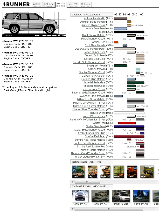

Here is a comprehensive Color chart for all years:
Chart courtesy of Toyota Reference.

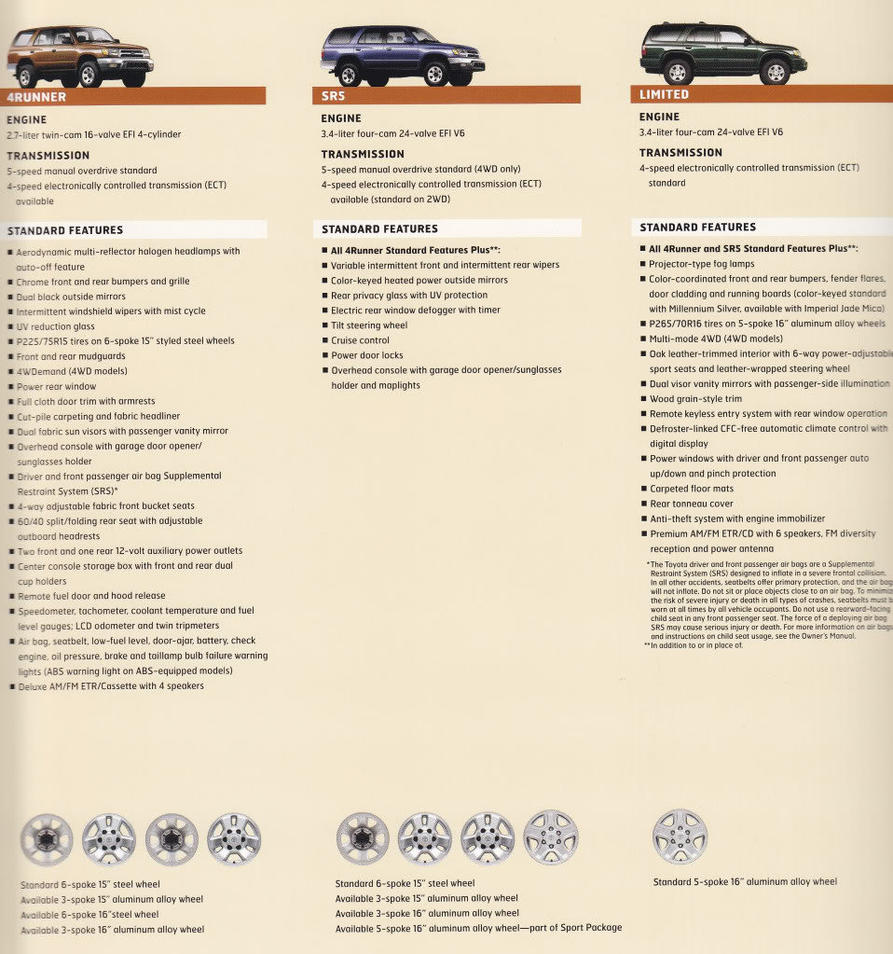

A 1999 Brochure
