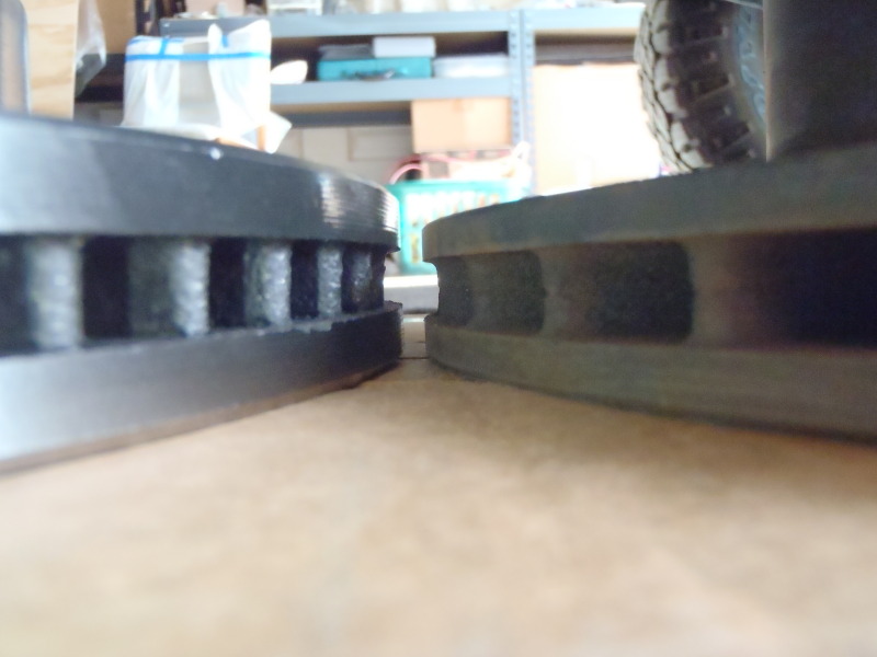

WARPED BRAKE ROTORS/ DEATH WOBBLE
The design of the OEM 4Runner brake rotors is a poor. The rotors are too thin. During periods of heavy, constant braking, the brakes can easily overheat and fade. Overheating rotors can also lead to non-uniform pad material deposits (aka warping). This problem is even more common on 4runners that are lifted and have larger tires. The shuddering when braking with severely warped rotors can be so violent that it can nearly cause loss of control of the vehicle. Warped rotors can also cause issues with the Anti-lock braking system trying to kick in while braking.
Fixes/ How to Avoid:
If you are just going to replace the rotors, get ones that are drilled or slotted to help it stay cooler. Although, this way there is less braking surface. The best option is to swap the entire brake assembly (calipers, rotors, and pads) with that of a 1st generation Toyota Tundra (2000-2006). This "Tundra Brake upgrade" has many advantages to a slotted/drilled OEM replacement. With tundra brakes, the braking power is significantly increased, the rotors last longer, and they are not as vulnerable to warping (all rotors are vulnerable, depending on driving style).
Other Info:
This upgrade is a direct bolt on replacement. The tundra brake calipers are available in 2 sizes, 199mm and 231mm, both diameters require new rotors that are much thicker than the 4runner rotors so they wont warp as easily. The 231mm (13WL) calipers will fit in the OEM 16" wheels, but just barely. The 199mm (S13WE) calipers are a bit smaller than the 231 and fit inside the wheel nearly the same as the bigger of the stock 4runner calipers (on limiteds and sports), they are also a little bit cheaper option most of the time. Both caliper sizes will need new pads and rotors (same size rotor for both sizes of caliper). The parts for this upgrade can cost over $300, but can be well worth it.

Tundra Rotors vs. 4Runner Rotors
Photo courtesy of BigFishAllDay.

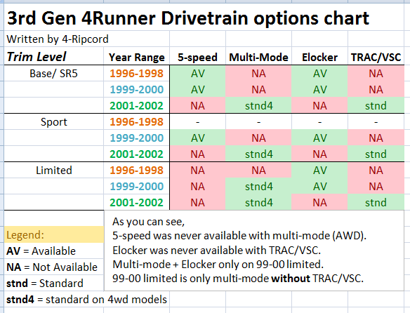

5-Speed manual transmission:
The 3rd gen 4runner was also available with a 5-speed manual transmission. The 5-speed is often preferred for its off road uses, increased fuel economy, and the lack of the Strawberry milkshake issue.
Similar to the E-locker and 4cyl engine, the 5-speed was discontinued after 2000. Also, the 5-speed was NEVER available on the Limited 4Runner.
Photo courtesy of JohnsD90.

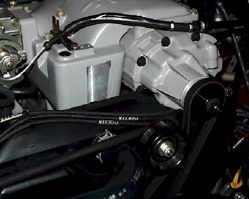

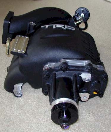

TRD Supercharger:
One highly sought after option for these trucks is the TRD Supercharger!
There are 2 different versions of the TRD supercharger for the 3.4L V6.
-It is important to note that this was a dealer option, meaning that you could not order a 4runner from the factory with the TRD supercharger in any option package. You just had to buy one after you got the 4runner and the dealer installed it.
Both the 1st and 2nd gen superchargers are M62 superchargers made by Magnuson and produce the exact same power increases. The only differences between them are appearances and ease of maintenance. The first page I would recommend you read is this one: TRD Supercharger Here, gadget (who is a pioneer of TRD superchargers and performance modifications) explains what superchargers are, how they work, and the differences between the 2 generations.
The 1st Generation TRD supercharger.
Courtesy of Gadget .
The 2nd (aka 4th) Generation TRD supercharger.
Basic specs:
Gains with only supercharger (no fuel mods)
Maximum horsepower gain: 75hp at 5200 RPM
Maximum torque gain: 77lb.ft. at 5200 RPM
Peak horsepower increase: 64hp (187hp to 251hp)
Peak torque increase: 50lb.ft. (225lb.ft. to 275lb.ft.)
Courtesy of Ultimate Yota.
Known Issues:
There are a few documented issues with the superchargers. Most of which arise due to lack of supporting fuel mods.
An in-depth list can be found here: UltimateYota.com
Things such as high gear/low rpms pinging, high rpm lean out, automatic transmission wear.
These symptoms are cured with URD's 7th injector kit. It helps to supply extra fuel when needed when the stock system cannot keep up with how much air is being pumped in. The tuning computer and two-step cooler spark plugs included with the kit helps by ret@rding timing more than the stock computer is capable of doing. This kit also adds top end power becuase it helps to meet this needs.
Underdog Racing Development
If you do not feel a need for this extra injector and tuning computer, at least get two-step cooler spark plugs to help with proper timing.
Denso Iridium IK22 are the ones you want.

There are two types of Tensioners that come with the TRD superchargers, they are interchangeable. with the old-style static tensioner you can experience belt slippage when you really step on the pedal.
-The Static tensioner is just a plate with a pulley on it, you manage the belt tension with the alternator tensioner bolt.
-The Dynamic tensioner is a spring loaded arm with a pulley on it that takes care of the belt tension itself.
The dynamic tensioner can by found for around $280, the part number is: PTR29-60032.
Supercharger wear
The bearings in the nose cone of the supercharger are only rated to last about 100k miles. This is one area where the 2nd gen supercharger really shows its advantages.
-The 1st gen unit must be taken off and either sent in to Magnuson to be rebuilt (usually $500+) or rebuilt at home if you have the right tools. DIY rebuilds can be done for around $200 with a lot of elbow grease.
Here is a detailed thread of a full rebuild of a first gen unit by Chris360hawks: http://www.toyota-4runner.org/3rd-g...-top-eaton-m62-complete-rebuild-write-up.html
Here is a thread where member Coinball rebuilt his 1st gen unit: http://www.toyota-4runner.org/3rd-gen-t4rs/119634-project-put-blower-my-hoopty-go.html
-The 2nd (4th) gen unit can be rebuilt in your garage while its still on the vehicle. To do so you need the TRD Nose cone kit (PN: PTR29-35042) it comes with a new nose cone with the bearing already pressed in and a bottle of new supercharger oil and some gasket sealant.
Here is a thread that really shows how that is done: 3.4 Supercharger Nose-Drive Replacement - CustomTacos.com Forum
Broken Bypass valves
The bypass valves on the 2nd gen units are known to fail and/or break the rivets off. Also the rubber inside them can dryout and crack which leads to boost leakage.
Replacements are under $100.
Available through LCE performance: Supercharger Accessories - 5VZ TRD Bypass Valve
