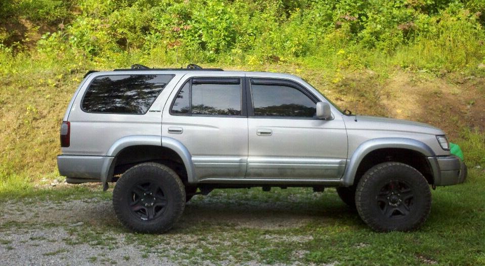

walked outside and got a good look at my 4runner after finishing my lift at 1am last night....not much help in Southeastern, KY...so i did this with lil help from by standers and " those ppl that help that only cause MORE PROBLEMS!" :boxer:
things done:
3' Toytec Lift w/ billys Eibach springs, 890 OME
Panhard drop bracket
Diff Drop
Tacoma LBJ ITRE OTRE
Sway bar Links Front & rear
**With the help of LOTS of Liquid wrench, sandpaper, THC:p, 500 degree spray paint, blood & missing skin i have this!!!!! WELL WORTH IT!!!
OH YA thank you T4R.org for all the info i have gathered from here to do all this stuff to my 4runner i have NEVER worked on anything like this by myself would always just pay someone to do it!!! STUPID AND NOT FUN!!! Thanks Heather your have been great the whole time!!!
