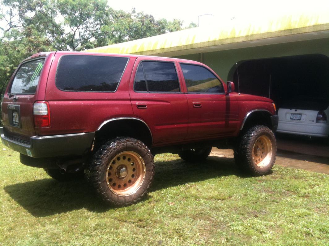

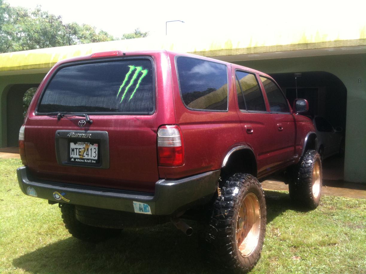

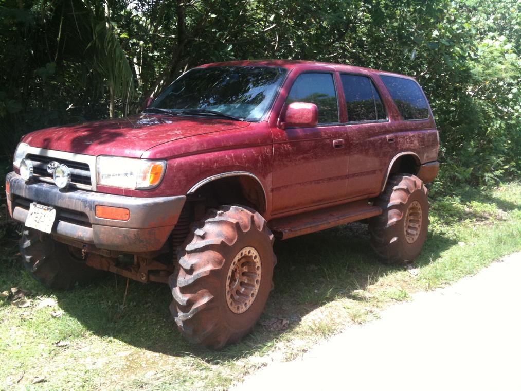

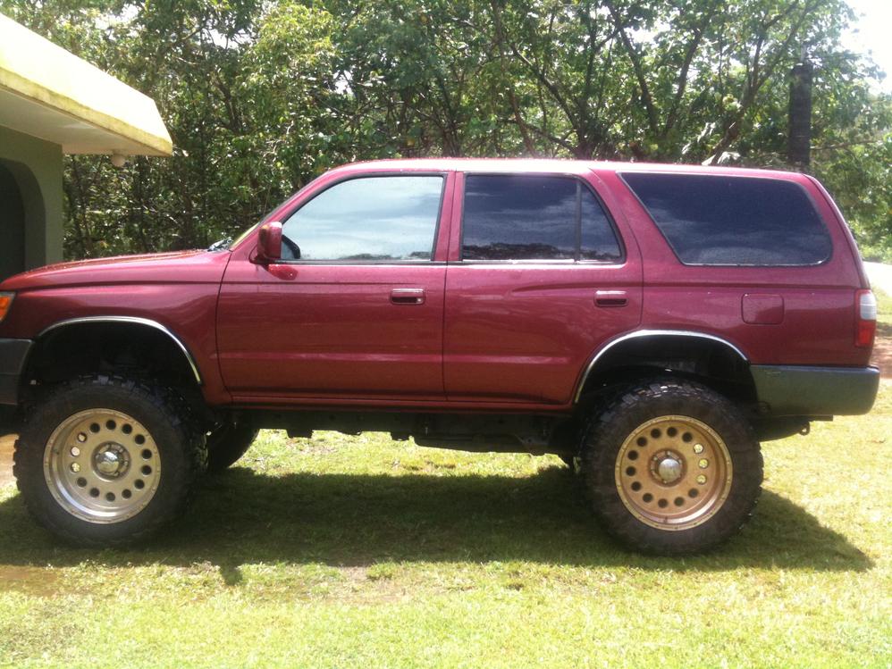

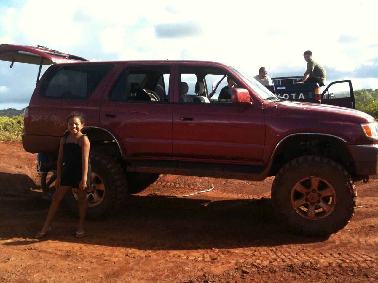

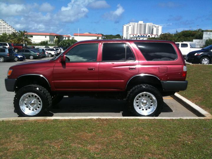

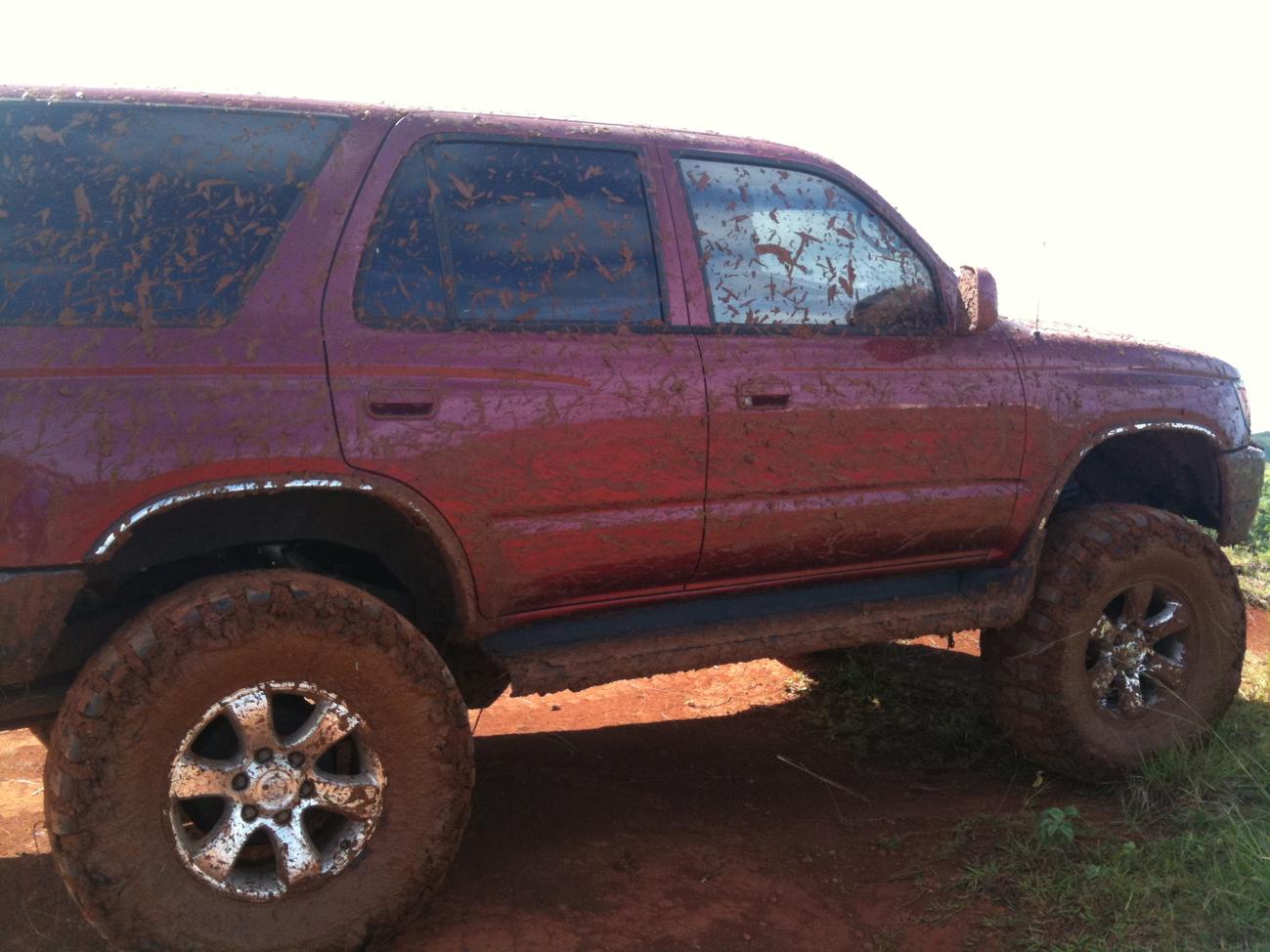

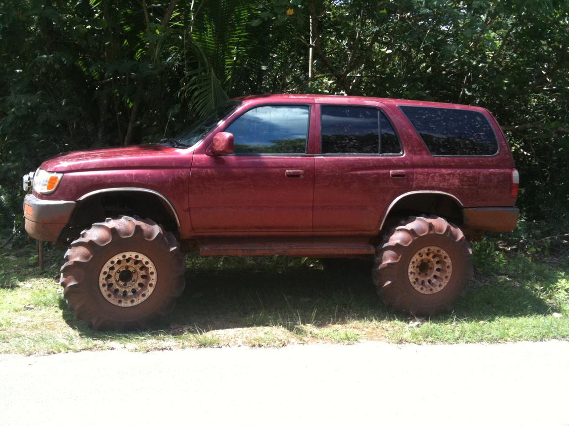

Hey! Sorry I'm new to this but I was reading bout u wanting to do a 4" lift front and rear! Well to start of I have a 97 sr5 raised up on a 7 inch lift! Rolling on 35/12-5 netto mud grapplers 17" Oem 4 gen runner alloys! My rear lift is a 3" coil I purchased from fat bobs garage with a 2.5" coil spacer from procomp lift! My front is a 4" lift kit from procomp that I match that would work from a 96-2004 Tacoma! No modification needed same exact installation that u would do to install on a Tacoma! On top of all that is a3" body lift also from a Tacoma! Body mounts bolt would be replaced though with longer ones bout 7" long! my gearing used are 4.56 front n rear that I would later need to up grade to a 5.29s. Rear diff carrier is a v6 hilux full spool! Front ifs carrier is locked up with also a hiluxv6 lock right that I also have no problems for installation! I just thought I share my build to a 4runner satisfied owner. Thank u!
Post up some pictures of the beast!
monster build!

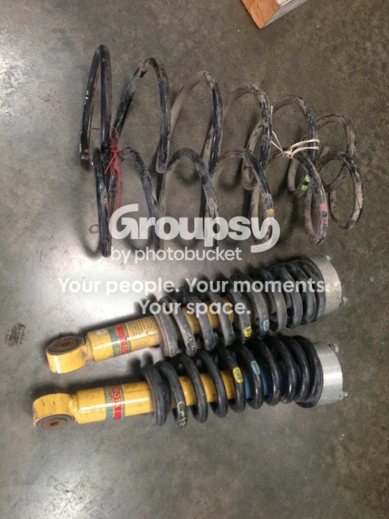

Found some coils off a land cruiser and and front strut assembly off a tundra at a local salvage yard. will the struts work even though they are both yb?.. The diameter of the yy coil i found looked smaller/thinner than the yb. Is that how its supposed to be?? is one stiffer than the other?
Looks like you got the wrong land cruiser coils. Should be the coils off the front of the land cruiser fj80
Those coils are off the front of a land cruiser. They'll be going on the rear if my 3rd gen. The strut assembly is off of the front of a tundra, which will be going on the front of my rig
You will be fine with the same coils, but you might get a bit of lean on the drivers side. A 1/4" spacer on the top will help with that though. Also Downpour is right and you want the fronts, not the rear coils.
