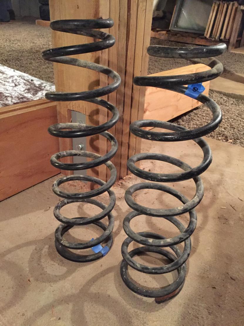

So I ended up getting these which seem to be 9 wraps. How bad will it be if I go with 5100's in the front with stock coils? I don't mind rake

sure, just no a whole lot of lift. i’d compare it to the 99 talls at best. Also 5th gen front shocks WILL NOT WORK in a 3rd gen.
so you’ll probably want 5160s in back. and Tundra 5100s in the front. You’ll end up pre loading the spring a Ton to get the desired look. and there will be rake. i assume you have read the 6billion topics on 3rd gen lift info?
So that pic is pretty much how a 99 tall sat new. maybe a smidge taller.

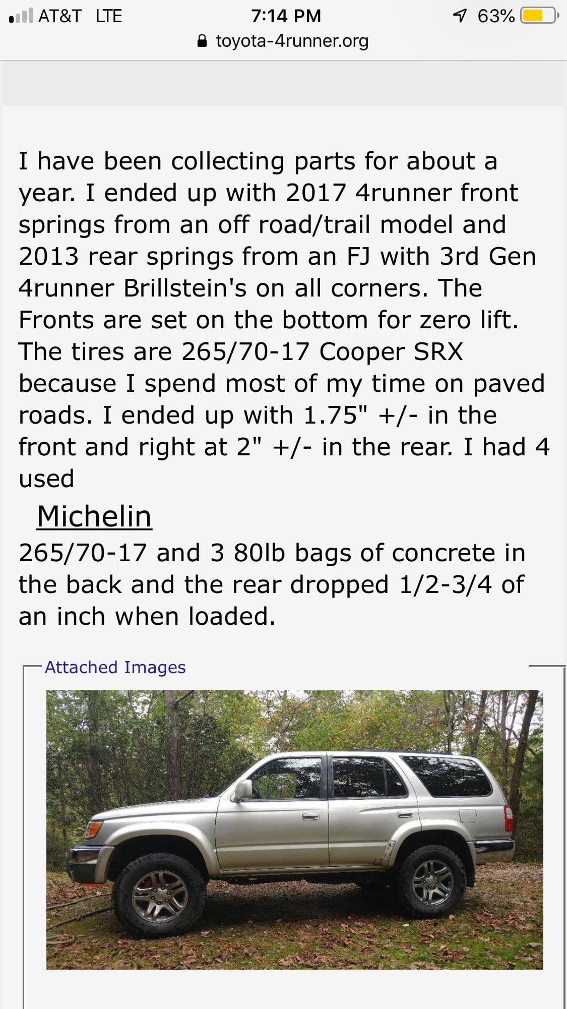

I had 5th gen rear springs early on and wasn’t impressed with them off-road at all. ON ROAD they were like a marshmallow though. Then there is the issue of spitting springs. they were shorter than my stick rear springs but the wire was thicker. under full flex you could almost grab them and yank them out. I’m pretty sure the seay bar was limiting the travel just enough to keep them in there.
The people saying they got a lot of lift may have had a 4runner that came with the least amount of lift from the factory or had really tired suspension parts. It’s really hard to compare how much lift everyone gets because there are so many variables that they started from. It’s also absolutely silly to measure lift from ground to fender (this is known with the elders in the forums and quite possibly discussed more than the meaning of life itself). measure center hub to fender. I mean going from factory 255 65r16 to 285 75r16 will show gobs of lift if you measure ground to fender....
I presume your new to 3rd gens? There was a guy “Absalom” who had some thread called a cookie cutter lift thread or something like that. It’s probably the better way to go because it laid out what to get and real world expectations of each setup. It was one of his most helpful posts actually the rest was a lot of toot my own horn sorta stuff [emoji23]. What happens to NOOB 3rd gen owners is they change their suspension several times because they did t do enough research or think they will be happy with the cheap setup. It doesn’t work, trust me we all been there and done that. I’m on my 4th iteration with suspension...
