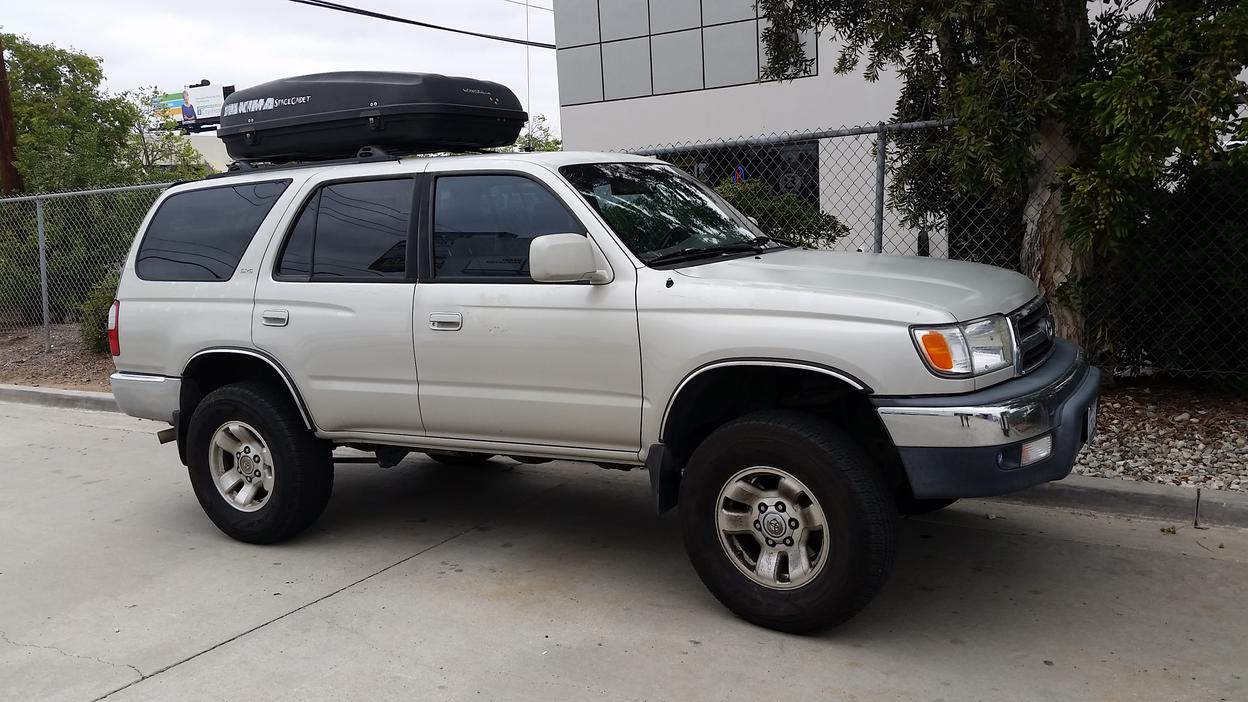

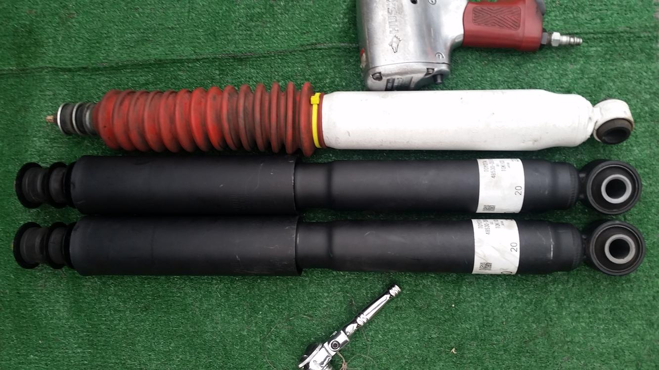

Installed 5th gen rear shocks a couple days ago. They are direct bolt-ons with no modifications. The centering washer hole is a little larger in the 5th gen from what it looks like. I just flipped the washer, and went ahead with the install. The holes could be made larger to fit, but I didn't want to mess with it.
These shocks are the best $10 I ever spent at the Toyota Dealer. :guitar2:
5th gen shocks are slightly taller than the tired old Explorer Pro Comp ones that were replaced. Gave it a little lift from the rear sag from the added weight of the box on top w/cargo. This was the first time the Yakima box was ever on this 4Runner. It was always on my 1997 Land Cruiser 40th Anniv. Sadly, sold the Land Cruiser about a month ago, and decided to keep the 4Runner.
