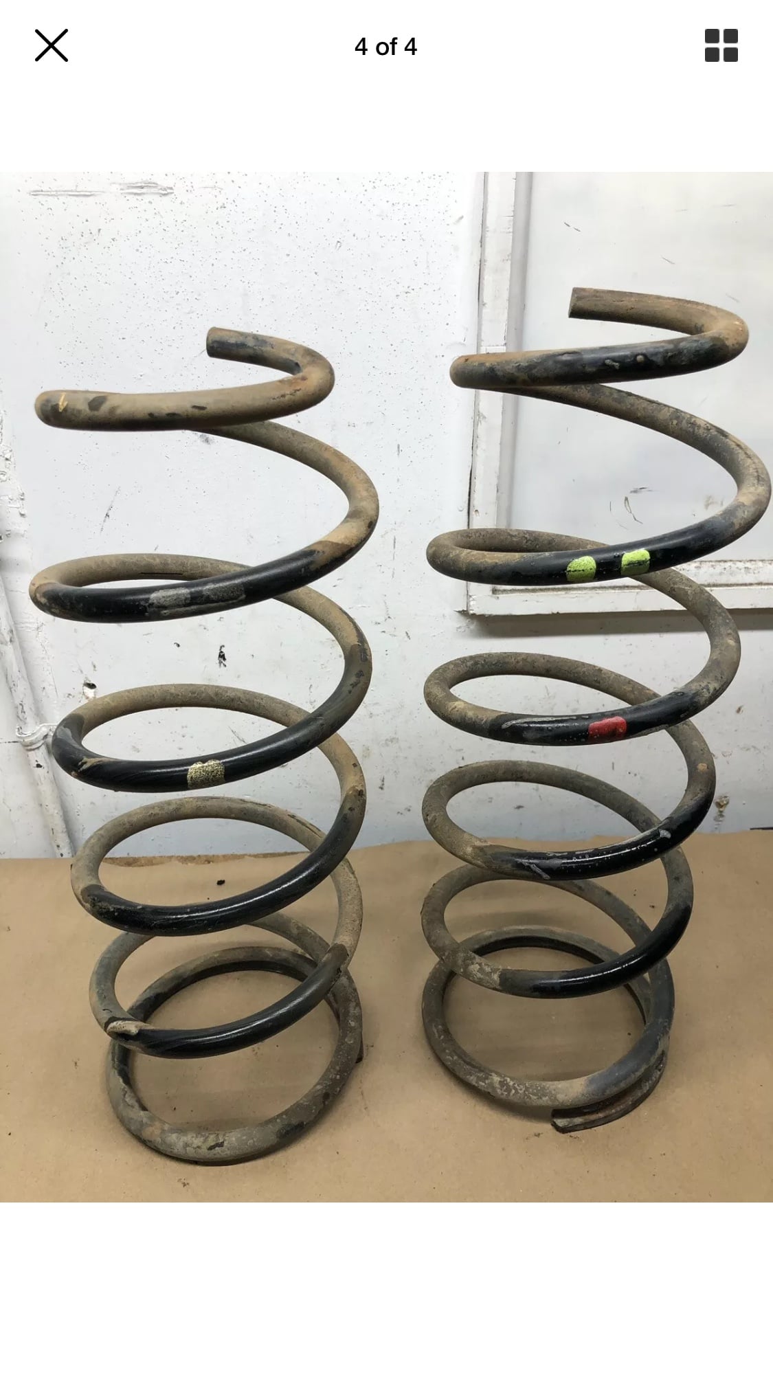

Here are some LC springs I found for about $50 bucks how much lift with theses give me . Another question is Are the 5100 shocks overkill for our lifted 4Runners it seems most post people run the 4600s or a non adjustable shock strut with the lifts ?
Are you sure those springs are the FRONT springs from an FJ80 landcruiser? you need to read the lift FAQs. Where have you found that “most” people are running 4600s????

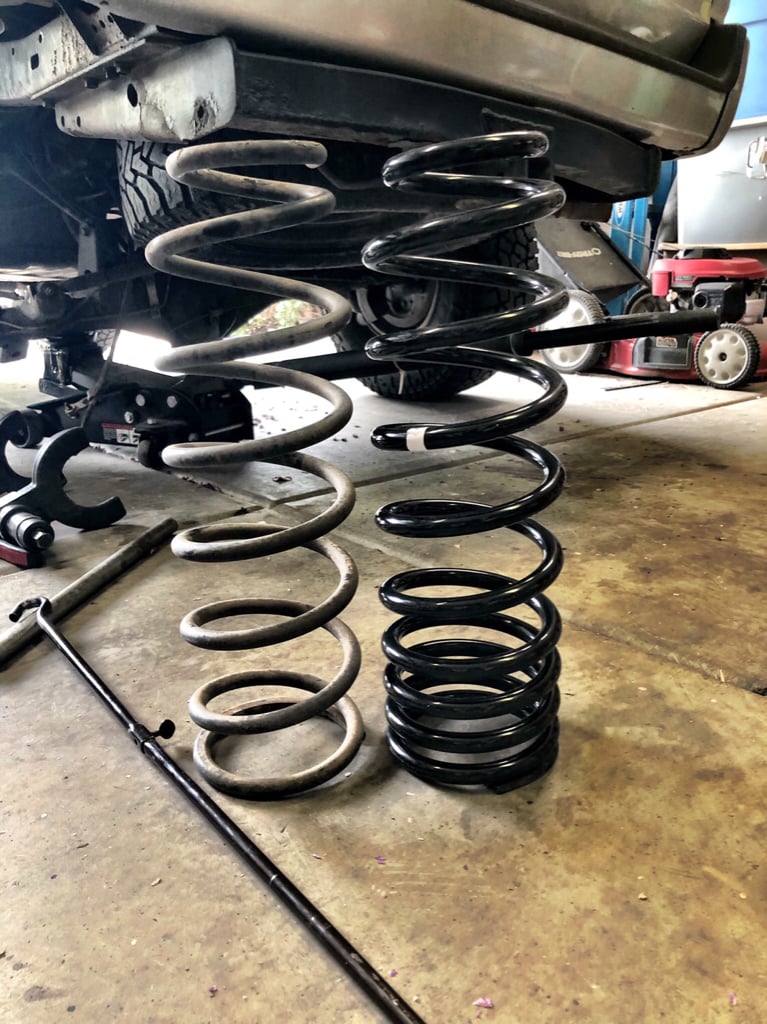

This is a pic of FJ80 front springs we use on the back of 3rd gens. 8.5 wraps next to OME 861s
