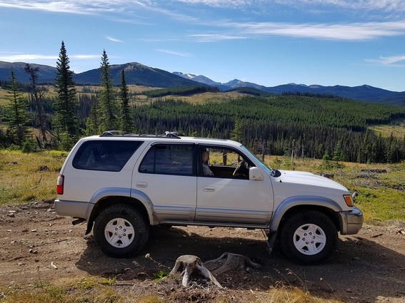

I just finished an amazing 3 week off road adventure around BC in my 2000 Limited. I was fairly loaded down with camping gear. In the back I have 906's and Bilstein 5100's. I really like that setup when loaded. I think the 906's give me a 2" lift; I haven't measured the difference yet. I'd prefer only 1" but can live with 2".
I aired down to 25 psi and decided after a while to bring it down to 20 psi which is the sweet spot. I am running 32" Toyo Open Country A/T3's which I also really like.
So here is my question; I want a stiffer front end since I will install a plate bumper and eventually a winch. I want a very small lift, like at maximum 1". What is the suggestion to achieve this? I presume with 1" I am not going to tear the CV boots and prematurely age the LBJ's? If so I'm happy with 0.5" or 0.0" lift... My runner did some awesome obstacles with zero lift up front and 32" tires so I see no reason to go larger.
