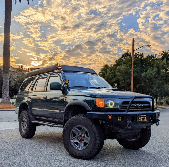

I have a very similar build linked in my sig. I have roughly 3" of lift (23.5 up front 24.5 rear fender to hub) on tundra billies with 620# Eibach coils (from Toytec) and 4xi bumpers front and rear. No rubbing or scrubbing on 33s

Thanks for the kind words, this forum has definitely taken a back seat to social media and other forms of group think/interaction. Sadly I don't see many well-informed owners out in the wild.
With it's current setup I think the truck rides nicely for what it is. I am on the second notch of my tundra billies, I don't think this has compromised either upwards or downwards travel or droop, much, if at all.
That being said, the suspension definitely needs to be tuned some and I will be replacing the front shocks and struts with Icon coilovers with adjustable reservoirs. I just added 2861 rear coils and are waiting for those to settle in before I revisit rear suspension. This truck is specifically being set up for off-road performance; road manners are secondary, for me.
The advice I often give folks is to figure out how you will use the vehicle, and what you want out of it before dumping money into it. You can't get 1 vehicle to do everything well, but if you understand what it can and cannot do you can maximize your experience.
Hope that helps.
