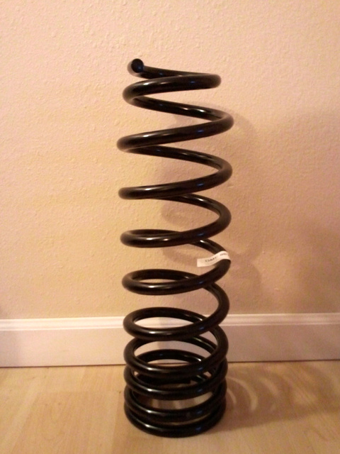

OME 861's..........just in case you wanted to count the wraps :boink:

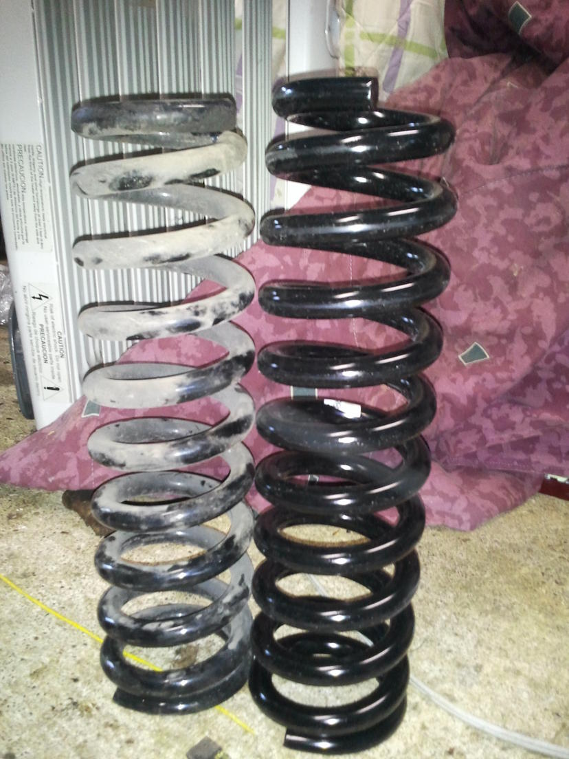

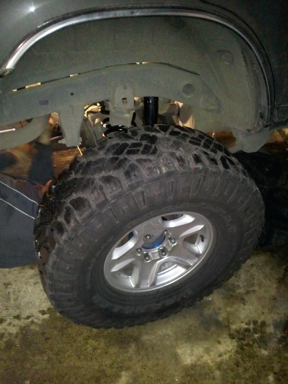

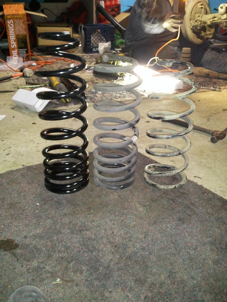

861's Installed............yes that tire is still touching the floor and yes thats a 35. And then the difference between an 861, 891 and stock
